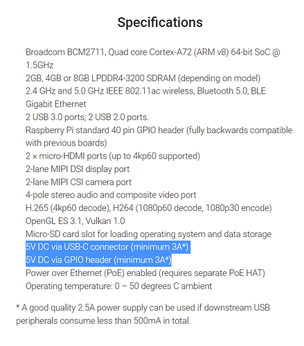

We have been using a raspberry pi 4 model B for computer vision since the beginning of the season and it worked fine until recently. Our electronics board was remade a few days ago. It all works fine except for the raspberry pi not communicating with the network. The raspberry pi is connected to the vrm’s 5V 2A the pi’s it’s GPIO pins.

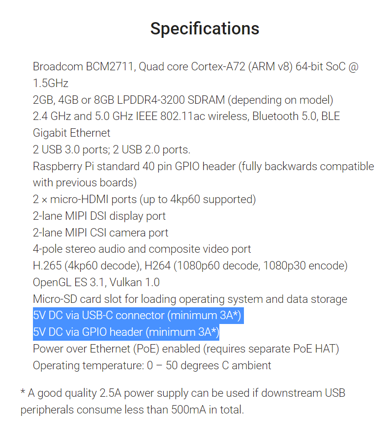

Not sure if it will solve your specific problem, but personally I have had a bunch of issues when I tried connecting a pi to the VRM 5v 2A slot. Spec sheet requirement states at least 3amps:
