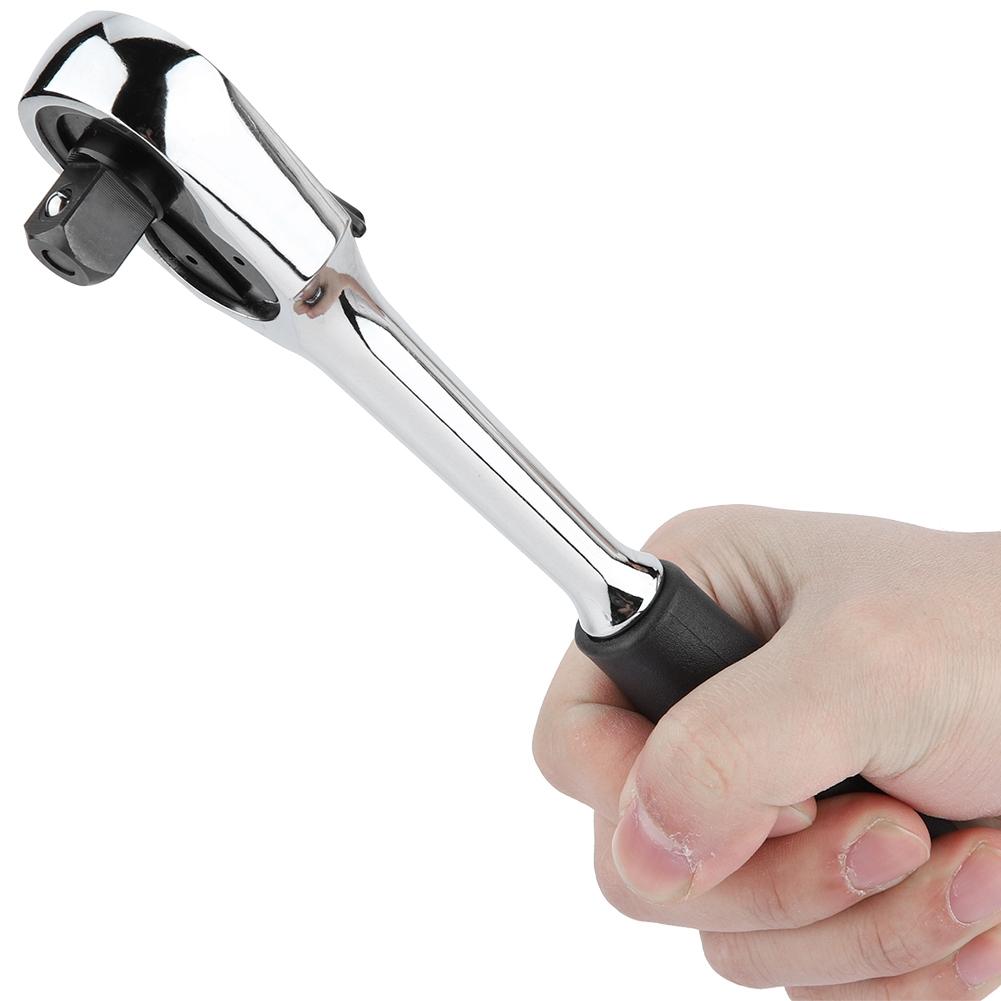

I’ve been thinking about possible ways to implement a system that allows movement in one direction but resists it for the opposite direction. I want to try designing a ratchet-like mechanism but have no idea how to even approach the design. any help is appreciated.
A simple approach is to use a COTS ratchet and pawl, e.g. ratchets | McMaster-Carr, or the planetary modular ratchet stages such as the VersaPlanetary ratchet. The very cheap solution (used by some FRC teams’ climbers in past years) is to just get a 1/2" ratcheting socket wrench, put the 1/2" on a hex shaft, and have the wrench push against a crossbeam.
If you want to actually CAD a ratchet and pawl and machine it yourself, the main thing to think through is how the pawl disengages from the ratchet when under load. You want that movement to be tangent to the surface, you don’t want the pawl to need to “push up” on the load applied by the ratchet. In the other direction (engaging the pawl), you similarly want it to slide into place. This will result in a raked sawtooth profile like what you see in the COTS solutions. I did a CAD of a large pneumatically-actuated ratchet and pawl for FRC back in 2010, I’ll see if I can dig that up.

We cut off a 1/2" wrench and attached it to the end of a pneumatic cylinder. We could then extend the cylinder and lock the hex axle in place or retract it to allow the axle to turn. It worked surprisingly well.

Back in 2020, FRC teams cleaned out Greenville’s entire stash of 1/2 inch ratchet wrenches during the competition. 5892 started the competition with something else (I think it was a smaller ratchet wrench or 3d printed ratchet? @Weldingrod1 ) that resulted in our robot rapidly accelerating towards the ground in a fairly unfavorable manner.
The 2020 Everybot documentation shows how they used an off the shelf, 1/2" Flex Head Ratcheting Combination Wrench. It can also be seen in their reveal video. We emulated this set up quite successfully.
Actually, we weren’t the only ones buying up the 1/2" ratcheting wrenches in Greenville :wink:
I think the shock load as the ratchet caught up after the climb is what did it in; there was a fair amount of rotation before it hit the stop.
The rebuild used a 3/4" x 1/2" hex tube to allow a beefier wrench to fit.
