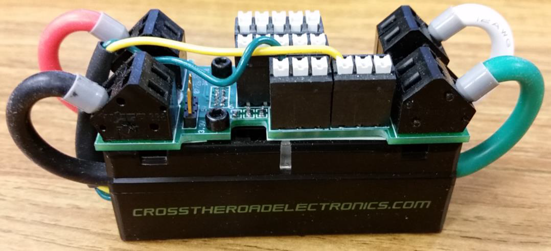

Q1/Q2 should likely be a MOSFET, right? Otherwise any voltage applied to the encoder pins will be pulled hard down by the transistor. You could put a resistor in series with the gate, but that will require a constant current draw.
We’ve been using latching molex connectors for quite a while and have liked them a lot. Consider connectors instead of soldering wires down.
Take a look at the attachments. This is what our team has used for the last two years… They have worked great, keep our wiring in order and allows for easy trouble shooting and placement on the robot.
