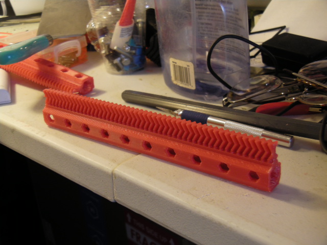

Here is the design
SANY0020
Its Printe ouf of HIPS. We got no deflection on it subjecting it to 340 in/lb torque in any direction (The max of our tester so we do not know where it would break) and we lifted with that a 100 lb weight lifting weight with no problem and decided to not test further as if we go to the breaking point of it we might damage the floor having a couple 100 lb crashing down and we use one of them on each corner of the robot so each one will roughly lift 1/4 robot. Now that piece weighs 90 g it will take 12 for the 4 lifts. They are grabbed by 2 pairs of Nylon gear pairs that intermesh with each other and the one from the motor. This was part of our off season project to rebuild last years robot out of 3d printed Plastic and was part of the climber design for last year. The center takes a 1/2 in anything (PVC, aluminum, steel) either a short piece to join 2 together or all the way through depending on how the weight goes. This particular tested piece is printed out of HIPS (High Impact Polystyrene
That’s awesome! I love the idea, seems like it will work. Did you print it vertically or horizontally?

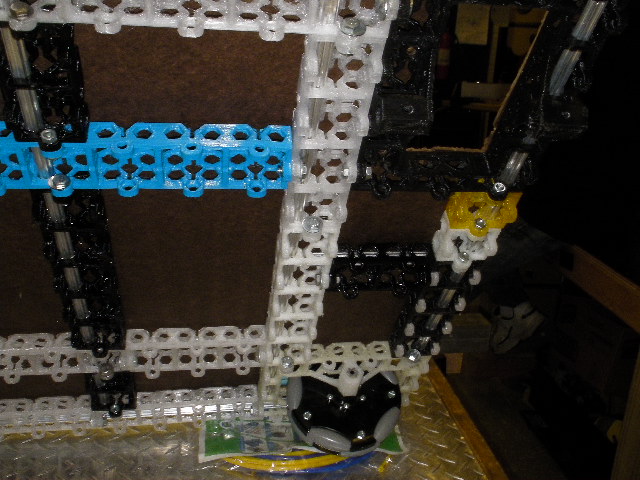

Here are some pics of an experiment working on an Omni wheel only Skateboard 3d printed with Aluminum churro supports to carry 120 lb of weight lifting weights. The frame, the 3d printed planetaries and 4 Cims and wheels came in just under 30 lb (without electronics and battery which is 10 to 15 lb less than a similar configuration on the Andymark frame with Toughbox Minis.
SANY0013 SANY0017
