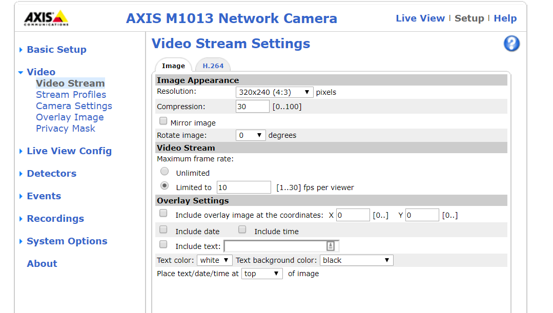

Just wondering, would this be the same reason we had trouble opening up an Axis Camera via a IP webcam http: url?
While we could access the axis camera as a “dumb” CameraServer source , when we tried grabbing a frame from the CVSINK it would fail. And when trying to open it up as a VideoCapture in OpenCV, it would not open in the same fashion we saw with the video file.
md
Axis cameras should work, as they stream MJPEG. I’ve not tested OpenCV VideoCapture, but I have tested cscore with at least a couple of the models. Can you give some more detail? What model Axis camera, how did you set it up, etc? There’s some debugging flags we can turn on to get more info about what’s happening.
Axis Camera Model M1013
And with respect to the open we tried…
http://10.7.72.11/axis-cgi/mjpg/video.cgi?camera=1&resolution=320x240
and
http://10.7.72.11/axis-cgi/jpg/image.cgi?date=1&clock=1&resolution=320x240
and even
http://10.7.72.11/mjpg/video.mjpg
which all work in a webbrowser
Code segment is:
s> td::string videoStreamAddress;
videoStreamAddress = “http://0.7.72.11/mjpg/video.mjpg”;
VideoCapture visionCam(videoStreamAddress);
if (!visionCam.isOpened()) // if not success, exit program
cout << "Cannot open the video cam " << videoStreamAddress << std::endl;
else
{ cout << “Congrats Dashcamera opened.” << videoStreamAddress << std::endl;
Error we receive:
I even tried just reading static images from the camera using cv::imread but did not succeed there either.
this link has a list of various urls that the camera
https://www.ispyconnect.com/man.aspx?n=Axis
which may help others as well.
md
What did the cscore version of your code look like? I’m not sure OpenCV VideoCapture has the http client capability built into it.

frc::CameraServer::GetInstance()->AddAxisCamera(“10.7.72.11”);
cs::CvSink cvSink4 = frc::CameraServer::GetInstance()->GetVideo(“Axis Camera”);
cvSink4.GrabFrame(sourceIn);
Works!
