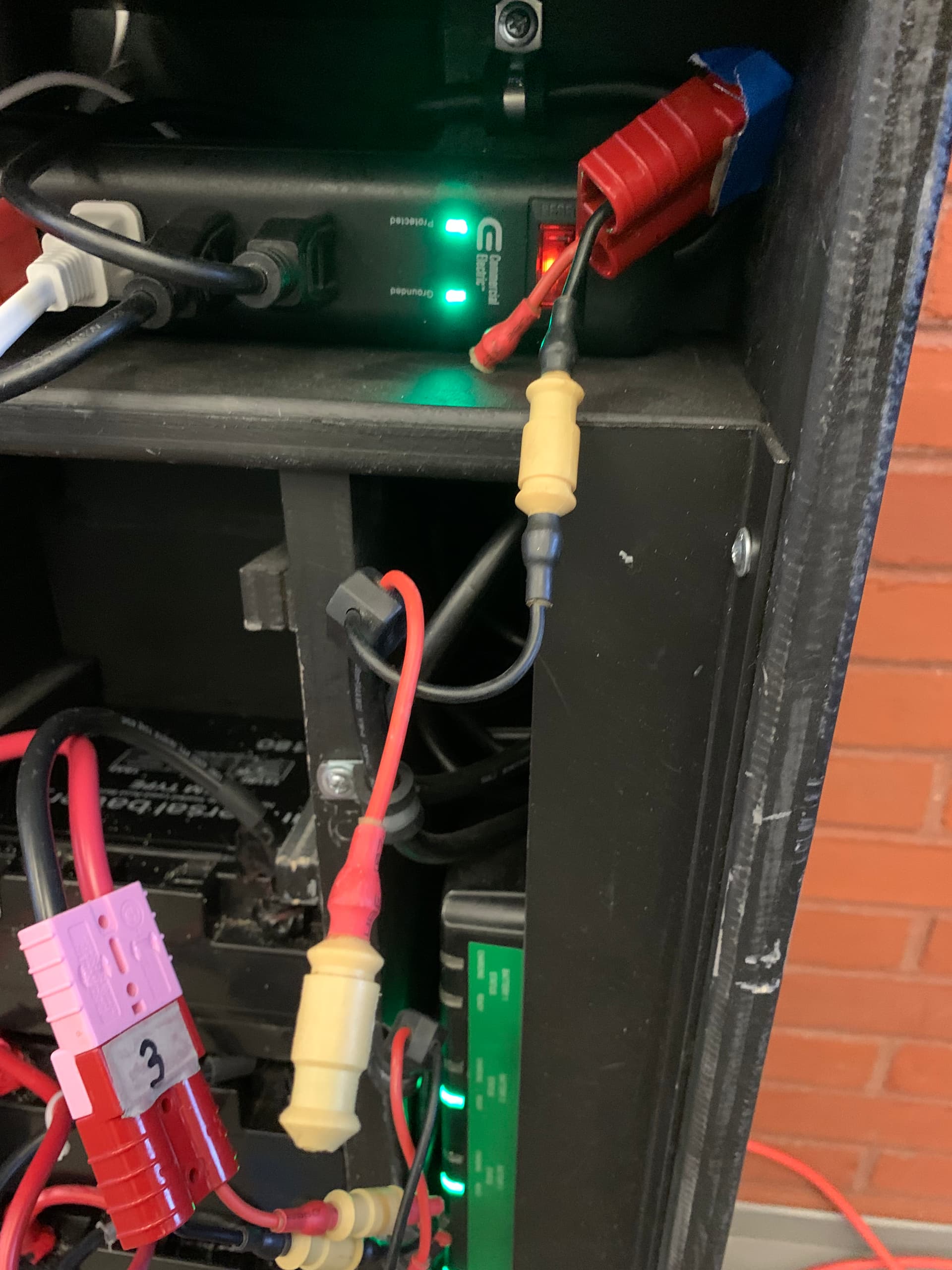

Our battery charger has snapped where the SB-50A meets the yellow piece. Is there a way to repair this?
Those yellow things are just inline fuse holders. You could splice any low voltage fuse holder in its place.
You can’t really repair it but you can cut it off and put on a new crimp for the SB-50, you could also extend the wire with a solder splice or other methods if you need. Finally, if you want to keep using a fuse andymark sell them.
I’m tired of intermittent connections at the fuse and broken fuses with those yellow inline holders.
I’m thinking of replacing them all with something like these. Also 30A fused. Thoughts?
MCIGICM 12 AWG Inline Fuse Holder… https://www.amazon.com/dp/B081DHT8Y7?ref=ppx_pop_mob_ap_share
We were similarly frustrated and did exactly that. We purchased these, which look basically the same. We haven’t had any issues since.
Do you use 30A, or lower?
Thinking of buying another RealPro (one of ours is ~10 years old and showing its age), but have had to do a lot of replacing of wires at the fuse connections over the years. Might swap all wires over to these in-line fuses.

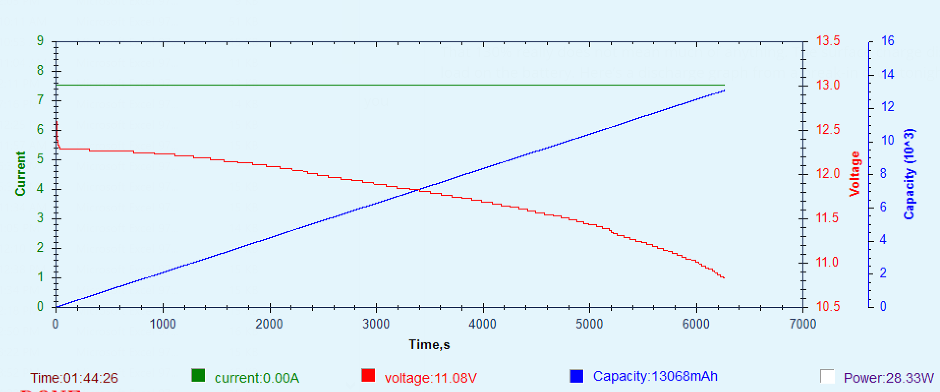

What SOC does that NOCO charge to? We switched to them back in like 2016 but gave up and went to the RealPro because the NOCO just seemed too “gentle”. Like it would just barely get to 100% SOC, versus both our old and new ones that really hammer them up to 130%. I know it’s all “surface charge” and theoretically minimal, but this is a competition where every watt counts over the 2 minute match with a battery fresh off the charger.
That 130% really does not mean much of anything. It is not 30% extra charge - it really is a surface charge that dissipates as soon as you put a load on the battery. Here’s a discharge graph from a break-in cycle tonight:
This battery started at around 110% fresh off one of our Noco’s, but notice that it immediately drops by half a volt as the surface charge is used up; and this is at a mere 7.5A load, nothing close to what a robot would be drawing. If your initial SOC is nominally 130%, the initial voltage drop is larger but just as fast.
Yeah, that 130% charge level reported by Battery Beaks is completely meaningless. I’ve seen batteries with only 10% of their original capacity report 130%.
