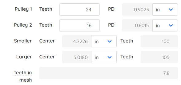

The belt calculator now also tells you the teeth in mesh on the smaller pulley. I used this formula but I can’t seem to find any other sources with the same formula. There’s a bunch of sources for the angle wrap formula but I care more about tooth wrap. I could convert angle to teeth but that’s a lot of work for a Sunday afternoon.

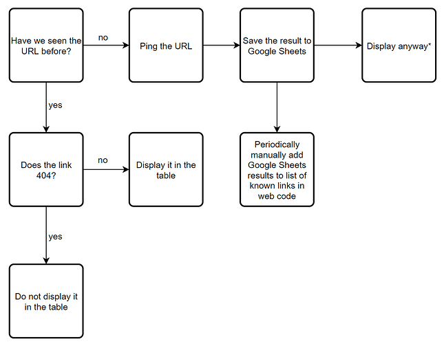

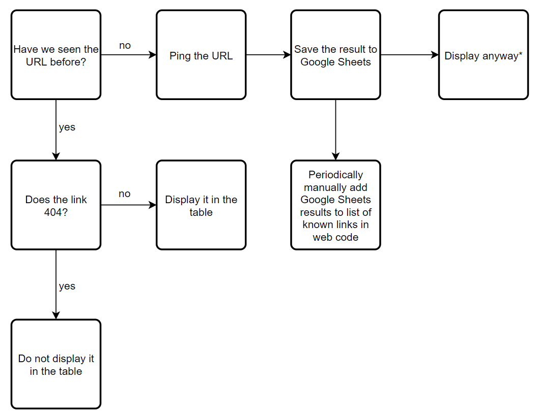

So I added some logic to help with this. Essentially, when generating the VBeltGuys links, the code now follows this flowchart:
*I know that this is not perfect, but it’s late, and the code for hiding it as soon as I check it is buggy and I can’t figure it out right now, so, I’ll fix it eventually .
The sheet that it pings is here, for anyone that wants a slowly-improving inventory of 3mm/5mm pitch 9mm/15mm wide VBeltGuys belts: V-Belt Guys Inventory - Google Sheets (or JSON format: recalc/vBeltGuysInventoryData.json at main · tervay/recalc · GitHub)
I’m planning on updating this inventory list weekly or so, as I already have a bot that makes pull requests to update my dependencies that I have to go in and merge every once in a while anyway, so the time investment is not that much more than what I already put into maintenance.
You will still get some 404s from VBeltGuys links now and then, but it should be much better than just completely guessing previously.

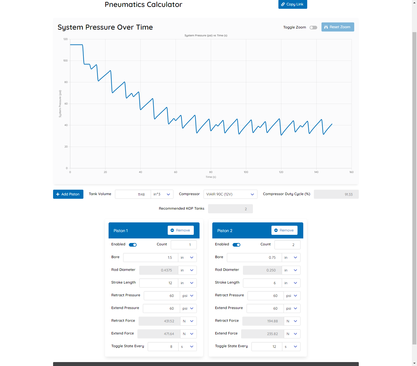

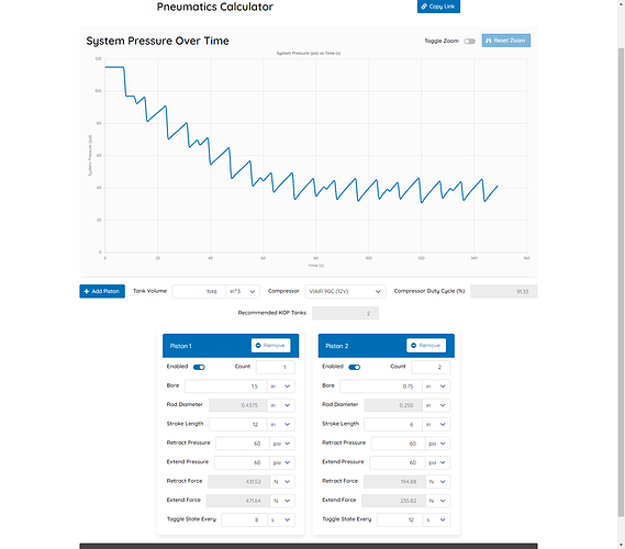

As I implied a couple lines up, the pneumatics calculator will be getting a big facelift and a bunch of improvements.
You can set up any amount of pistons that you want now. No longer limited to just 3

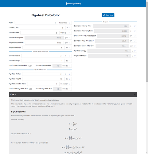

The flywheel calculator is also getting some big improvements, where I’m essentially just implementing @dydx 's flywheel calculator. Huge thanks to Julia for making the original one and helping me understand the math.
The goal is for each calculator page to also have a documentation block that will somewhat/mostly explain the math that is going on.

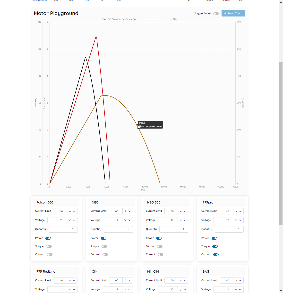

There is also a motor playground now, thanks to a suggestion from @Nate_Laverdure .
You can set a current limit, voltage, and quantity for any FRC-legal motor and view the torque, current, and power vs RPM graphs for them. These are imperfect estimates, but mostly accurate.

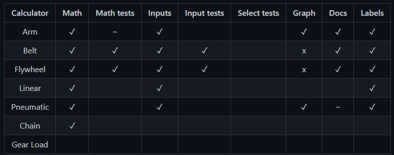

Some generic updates from me:
I’ve been working on the Typescript rewrite behind the scenes for a while and have a lot of the infrastructure fleshed out now. I’ve also been fiddling with different hosting solutions (Render, Surge, Vercel) (currently prod is on Heroku) and so as a result it’s on a different repo. But it’ll be merged into the main repo soon.
The largest work I’m doing at the moment is testing. There are a few things I have to test for each calculator:
- The actual math.
- When changing an input’s scalar value on the page, the outputs should also change.
- When changing an input’s unit value on the page, the outputs should also change.
The math tests are not that difficult. The UI testing, however, is extensive and verbose. There’s lots of ways to do it, and it’s a rather long process having to test so many combinations of different user inputs.
I wound up writing a couple Python scripts to auto-generate test stubs for me, then all I have to do is type in some numbers with what I expect the UI to display. Even though this is significantly faster than manually typing out every combination of user interactions, it still takes a while.
After testing is fully completed, ReCalc will exit alpha/beta stage and be fully released, whatever that means. I guess it just means a level of confidence in it being functional.
The current full-release-progress-tracker is here:
As you can tell, I’ve been putting off the UI testing . As for what this means for you guys:
- I need to finish the math tests for the linear calculator, (new) pneumatics calculator, and chain calculator.
- After that, I need to write up further documentation on those three as well.
- Once those are done, I will be merging the re-write into production. This will move ReCalc from alpha into beta. (This means its mostly feature complete, but not fully tested.)
- I will also be changing hosting platforms from Heroku to Vercel. Saves me some money and has a better feature set.
- This means I will have to change some domain settings, and as a result, the site may be temporarily offline.
- At this point, you’ll be able to use the rewritten version, which has a new pneumatics calculator, better motor specs visualization, better compressor specs visualization, a better belt calculator, a better arm calculator, and a wildly better flywheel calculator.
- From there on out, I’ll be working behind the scenes on the UI tests, which make sure that when you’re using the site, it’s not freezing or refusing to update the output fields.
- Once all that is done, ReCalc will be “fully released.” Whatever that means.

- The pneumatics calculator has been completely rewritten and now supports any number of cylinders with customizable pressure settings.
- The flywheel calculator has been massively upgraded and is essentially a web port of @dydx 's flywheel calculator. Huge thanks!
- There is now a motor playground where you can view estimated motor curves for various motors at different current limits and voltages.
