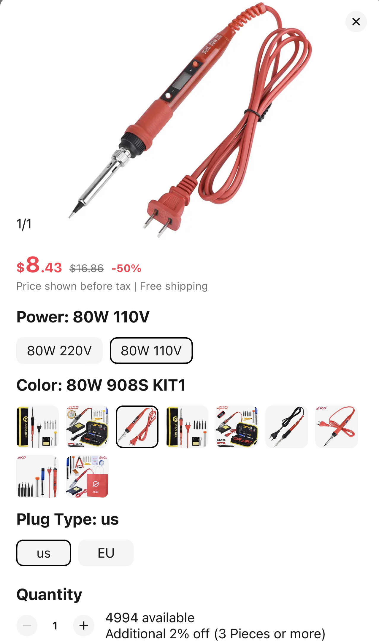

It’s not wireless, but for the pit at competition, we bring 2 of these. One for soldering if needed, and the other is fitted with brass tips for installing threaded inserts into plastic. And that way we have an extra if one dies. They take up little space, heat up quickly, are temperature controlled, and have enough power to solder 10 AWG wires if needed. We bought like 10 of them from AliExpress originally for our learn to solder outreach activity, but like them enough to bring them to competition as well.
