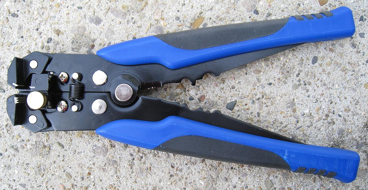

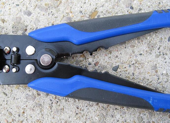

*Just bought this at Rural King for 9 bucks this morning. Seems to work OK so far…

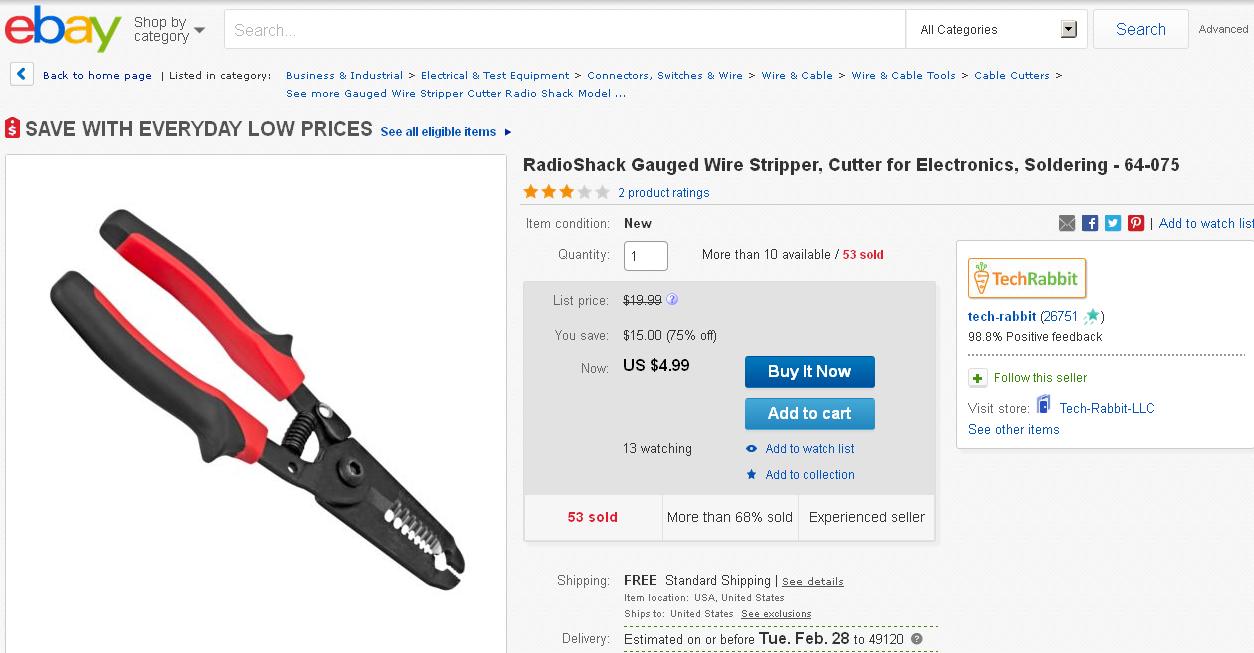

*I wonder if this is any good. The price is right.
I ordered one yesterday to check it out. We’ll see.
