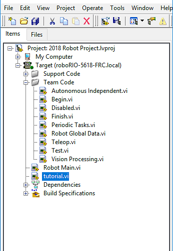

To create a custom VI, you can just press the “New VI” button while having your project open and save it in your project folder, it should now appear in your project explorer (I named mine tutorial). You can move the newly created VI in a virtual folder or in the “Team code” folder (or whatever you want to do with it). To use the custom VI, you just have to drag in a loop in “Periodic tasks” (that’s where I put it, but you can put it wherever you want it to be executed). You can now edit the VI’s icon for easier utilization and change it’s connectors to use with indicators in the top left of the VI’s “Front panel” screen.
You can see how our team used it in the code (in my signature). Feel free to contact me if you have any questions.
