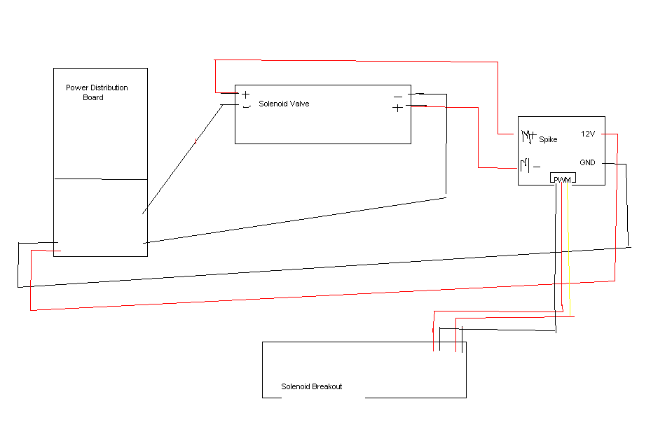

I will start from the very beginning.I have a solenoid valve that is wired into the spike.
Here is the valve that we use.
http://www.festo.com/rep/en-us_us/assets/pdf/VUVG-Assembly-Instuctions_2011b.pdf
Then I wired the pwm output of the spike to 2 ports on the solenoid breakout.

Well thats a 24v and it has to go to break out and that pictures seems to be wired wrong.
But there are lights on both corners of the valve.
Doesn’t this mean that valve is powered correctly ?
Here is our code.
Not quite, On one side of the valve power and ground need to come from the PD and the other side goes to the ground and power side of the spike (M+, M-).
But if it is a 24v valve, it needs to be wired to a 24v breakout. It will only get 12v for a spike.

When you use a 24 volts solendoid valve, the only legal and correct way to use it is to wire the solenoid module in the Crio for 24 volts. There is a wiring diagram on the First website to assist you. I believe you can find it in the KOP section. The Spike can only control 12 volts. While some people have reported that their 24 volt valves work on 12 volts, they are not reliable at that voltage.
So what you are saying is don’t wire the spike with the valve , just wire the valve to the solenoid breakout ? OR…

It seems as though your wiring is entirely wrong.
The Spike Relay replaces the Solenoid breakout.
If you choose to use the solenoid breakout, each side of the solenoid can be connected to a separate channel on the solenoid breakout board, no spike needed
If you choose to use a Spike relay, then you would connect the Spikes signal input to the Relay section on the Digital Sidecar using a PWM cable. No solenoid board or module needed; this can be a slight weight savings when using only one or two solenoids.
In addition, the solenoid link you provided is for a 24v solenoid. To use this solenoid, you must connect the solenoid to the solenoid breakout, and power the solenoid breakout from the 24v cRio power supply.
Yes, exactly. The two wires from a side of the solenoid valve go directly to a 2-pin connection on the solenoid breakout. No need for a spike.
