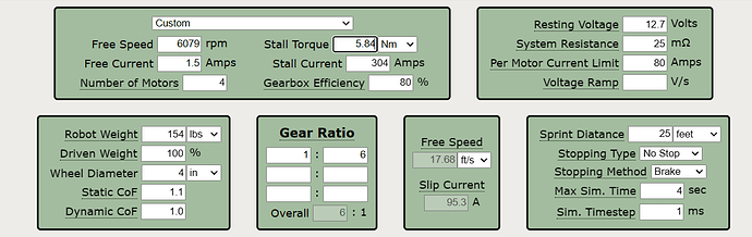

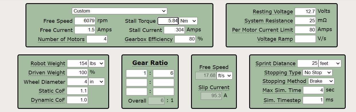

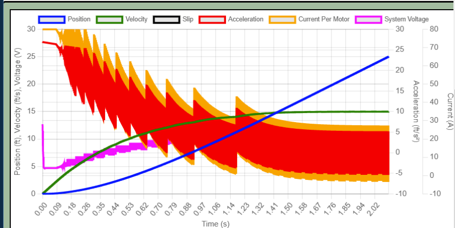

Something looks off about these plots…
Config
