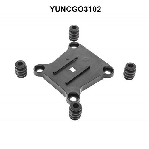

You could try to attach your camera to rubber mounts instead of straight to the metal. I use this when assembling racing quadcopters. Like this go pro mount I found on google images.
My team used this same method in 2017 when we attached our vision camera directly to flywheel shooter/ turret and it worked perfectly.
