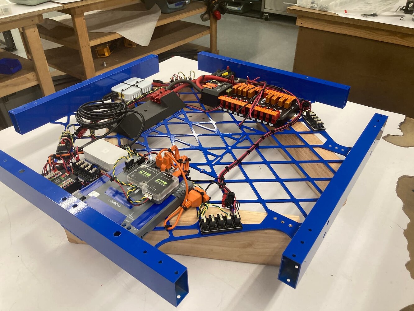

To prevent a power wire from coming out of some critical electronic and ending your robot during a match, is it safe/possible/legal to power a single electronic component through multiple ways?
I’ve heard talk of using both a POE injector and the barrel connecter on the radio, if one comes out then there is the other to keep it on.
Team 254 also recently posted a picture of their robot base with electrical, and it appears that their RoboRio 2 is powered through the power terminal AND a POE injector (while there radio only uses a barrel connector):
Is this safe or recommended to do, and is there any considerations you need to take into account while doing something like this?
I can’t think of a reason it would be illegal, but I also don’t think the RIO supports PoE, and it definitely wouldn’t need to be powered from the VRM if it did. Given that this is an in-progress picture, I think this might just be a case of a mistaken student rather than a secret new wiring strategy.
They might just be using the poe injector as a remote Ethernet port
yep, the rio is not redundantly powered. another late night, just an erroneous connection as we get ready to add the swerve and drive the following meeting. In our reveal picture, you can see the radio is mounted on the superstructure.
