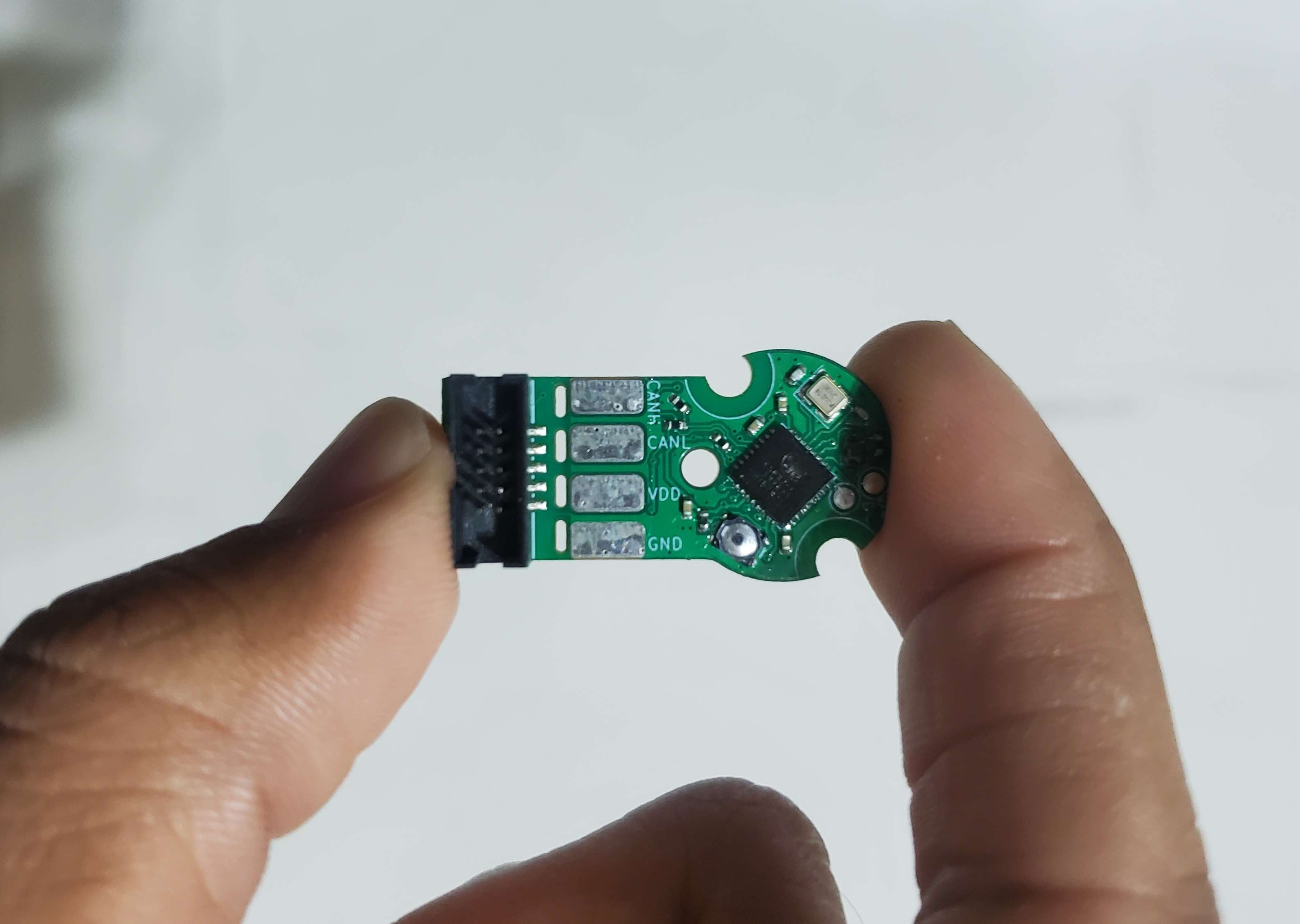

Helium Canandcoder
The Helium Canandcoder is a CAN-enabled 14-bit encoder with a zeroing button and flexible data port. It interfaces natively with the Spark MAX and Talon SRX using a pulse width output, without fussy adapter boards or cables. If you don’t want to use the data port, it can be easily clipped off to decrease the height and footprint. Wide solder pads make soldering wires a breeze, and the zeroing button allows teams to zero an arm or swerve module without opening any software tools or setting offsets in code. It is directly compatible with many existing and popular products, including COTS swerve modules such as the SDS MK4/MK4i and WCP SwerveX, and we also have a throughbore upgrade package to make it easier to use the encoder on anything with a hex shaft.
The ReduxLib API is designed to be simple to use with simple and easy to understand methods, complete documentation, yet enough flexibility that one can rewrite the classes from the CAN message layer up if desired. We are committed to in-season API stability from the CAN spec all the way up to the Java/C++ classes.

Does the encoder start up with a working getAbsolutePosition method within a reasonable amount of time from boot consistently? One issue we have had with our CANCoders is that they just don’t give you the absolute position, sometimes ever, we have gone entire matches where our robot can’t drive because the get absolute position function just didn’t work, while other times it would start working in the middle of a match.
The encoder will begin broadcasting its absolute position almost immediately from startup. Boot up time is pretty fast, and the same CAN frame delivers both relative and absolute position.

Zero button is a killer feature. Simple, but saves a lot of software stress.
It’s not clear from the documentation, is the PWM output split out in a solder pad? We found this year that ribbon cable was pretty fragile. It might be nice to solder wires to a Spark Max (breakout board) instead.
The solder pads only have the CAN output. PWM is only available through the 10 pin IDC connector.
If you really wanted to, you could solder a wire to the bridge pads underneath the IDC used to select the output pin. Those are connected to the PWM output. Small pads though, so I’d use good strain relief.
Boo. That’s a sad oversight.
Seems like an aware compromise rather than an oversight.
What testing have you done to ensure that the reset button doesnt get accidentally triggered during a big hit? How hard is it to accidentally hit? Can it be disabled?
  1. It has been run in competition and we have not had issues with the zero button getting accidentally triggered. As a note, it needs to be held for 2 seconds to trigger, so it won’t be triggered by an accidental jolt.
  2. It is not easy to accidentally press, the button itself is small and the case makes it harder for something to press it by accident. It would take a very small piece traveling at just the right speed and direction to cause it to reset (very unlikely)
  3. It can be locked (disabled) from our configuration client
