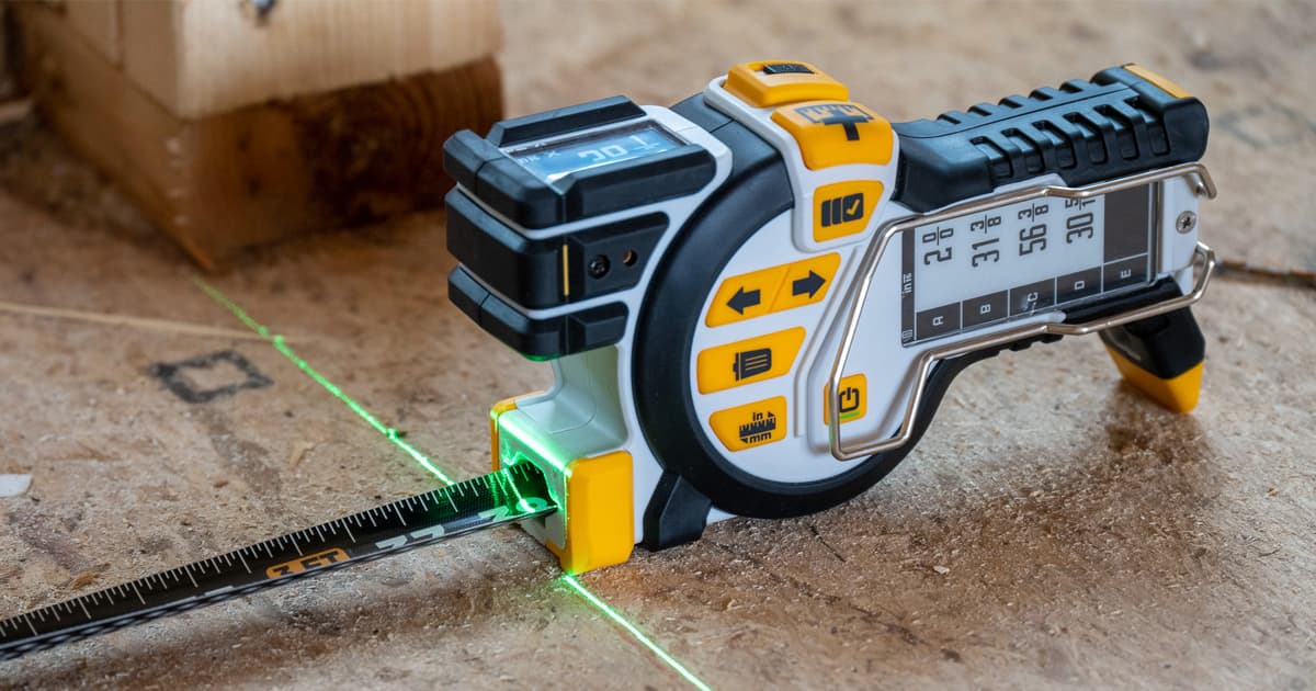

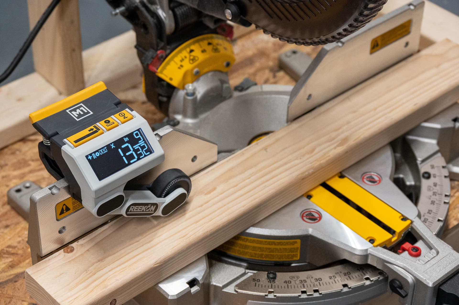

I like the look of that rolling measurement thing for chop saws. Could be very handy for 2x1 tubes. What is the cost of this?
First, I want one of these as a robot inspector.
Second this tape measure plus the app and a printer would be great to make an inventory for all those random lengths of metal teams have tucked away in their shop.

It looks like you’re in Beta for the tape & App still? So it’s kinda okay that it’s hard to buy those on your website. The saw attachment is in full Production, I want it to be a lot easier to slap that “buy now” button! :wink:
I’d want the saw attachment, not necessarily the tape for FRC applications. I can see how the tape is designed for a jobsite. I think our jobs are small enough to not need a QR printer?
These would be awesome! I second @Drakxii that using the tape measure and the app to inventory all the random stuff we have around the shop. The QR code label maker could be nice for labeling sheet goods to keep a better inventory.

I’m not sure how wide of an appeal your T1 would have, but I can say it would be absolutely wonderful to have for anyone setting up a practice field (or even a regulation field at an event). Trying to keep lines straight when marking out the floor and positioning field elements can always be a pain (especially with how awful FIRST’s field layout drawings tend to be). I went out a bought a laser square this past year to help with setting up our practice field, but an integrated tape measure like this would be event better.
I can’t speak to the M1 very well since my team doesn’t really use a miter/chop saw much anymore (at least not for precision/repeat cuts that would require something like this), but I could certainly see some teams getting a lot of use out of this one, given the right shop layout and workflow.

The T1 is the most appealing product to me. I didn’t see if it had this feature, but I would buy 5 in a heartbeat if it could display decimal inches in 0.001 inch increments, or heck even 0.005 inch increments would be a game changer for us.
I agree that decimal inches would be a nice feature, though I would point out that if the tolerances on the T1 are similar to the M1, it might not be able to go down to 0.001"/0.005"…
REEKON Tolerance
What you’re basically looking for sounds more like a pair of calipers in tape measure form, a level of resolution construction tools would have no need for, generally.
I was thinking of the caliper decimal values, but intended to remove a zero. So values of 0.010 or 0.050.

Personally, I like this miter saw rolling measurement gizmo. Your timing is superb. I have a project at work that likely would benefit from this. I’ll probably have them order one. I agree that I hope it can do decimal measurements. I see that as kind of essential. .020 inch resolution is okay for wooden playing field, maybe not good enough for aluminum robot chassis for some teams. .010 resolution would be better if it’s possible.

I have to disagree with you there, If we are using a chop sawon the robot I have to believe you cannot be expecting to get better than .020 accuracy. That may not “cut it” for teams using routers and stuff, but is plenty good if you even considered using a chop or horizontal band saw.
Cool stuff! The storing tape measure would be awesome in every field setup trailer and many teams that build large game elements would greatly benefit from having one in house!

Whether or not you offer this in FIRST Choice: You would be the Hero of a Generation to donate (2x) of the Digital Tape Measures and Whatever other Relevant Hardware you come up with to each “Official Playing Field”.
The ability to suddenly layout a field via a series of digital (TAPE) measurements, removes a HUGE amount of discrepancy between events. If we look at - field markings exclusively - the ability to perhaps use (2) Digital Tape Measures (with all the fancy lasers and smart phone connectivity) makes it very hard [for someone who cares, and is trying] to miss a marking by a “real” (1/2" or more) amount.
With the General trend to more sophisticated and precise autonomous modes in the (Post-Covid) couple of years - the ability to “know” that the field tools are precise and constant across events removes a lot of variables.
(Note: this isn’t a knock on field staff, I know many of them, I have helped lay out fields - doing it with a standard tape measure, which may vary from event to event - along with it’s interpretation - introduces a series of variables into the equation that quite honestly, shouldn’t be there**)
(**If you want to debate the point, please contact me on the side. Yes, the real world is full of variables we cannot account for, but when teams are given 10 minutes to measure a field, and it takes 2 minutes to get the robot “in a state to measure” - who benefits?)
Otherwise, there are a lot of products in your portfolio that are of use to - some teams - probably not all, though we forget how many teams are still working with “Tape Measure Tolerances” on Pre-Machined Extrusions.
Beyond that - it’s kind of a no-brainer. You give away (1) unit of Free Stuff to a Team that is nominally (20) People? It’s Product Placement, it buys a lifetime of loyalty, if the stuff is good.
I know for a fact that had you handed me one of your Digital Tape Measures, 10 Years Ago, It would have changed my Professional Career. I “Grew Up” (First 11 Years or so) in a “Tape Measure Tolerance” Fab Shop. We liked to say we could “Hit a 1/16 inch on 20ft.”
That 1/16" was all about how you looked at the tape measure.*******
(Also yes, Digital Tape Measures have been around since forever, my point is that making people aware of them, and getting them using them changes the baseline expectation for “What can be done with a Tape Measure, In the Field”.)
