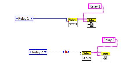

So I am learning LabView on myself for FRC and I got stuck.
I need to make a window motor connected on relay ( Spike ) and then when button 4 is pressed it rotates forward for some time ( for example 1 sec after that he must stop ) and then when button 2 is pressed it goes reverse ( because I need to lift a ramp for discs 4 times and then take it down for new load ) .
Also when I try to open new relay ( relay 2 ) LabView does not enable me to do it ( wire does not connect to Relay open ) , but I really need to use like 3 or 4 relays for my future work with motors…

But I constantly get broken wires when I try to make Forward/Reverse or change relays name as you can see on screenshots :confused:
Even the one with the unbroken wire is telling you something is wrong. That red dot on the function input says there’s a mismatch between the type of value you’re giving it and what it expects.
To fix them, delete the enum constant (the name in the blue rectangle with the various little triangles around it) and the broken wires. Then right-click on the terminal you want to connect it to and choose Create >> Constant from the menu. Now you can change the constant to whatever value is appropriate for the code.
