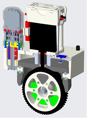

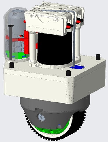

After two years of testing and development, team 3737 is pleased to release our latest 3D printed swerve drive. Our goal was to enable us (and any team) to manufacture a relatively low cost but competition capable swerve drive using a quality FDM 3D printer. To this end, we have provided with the CAD model, step-by-step assembly instructions, full BOM, complete print settings and a speed calculator for various gearing and drive motors. The swerve assembly is designed to bolt to the underside of a 3030 T-slot chassis (see 3737’s robot release of BB Mantis). This lightweight but strong chassis design also provides immense versatility with infinitely variable bolting positions on all faces.
The base design uses NEO drive and NEO550 steer motors. However, all current FRC legal brushless drive motors are possible (serrated shaft prints are provided).
Note that this assembly uses the ‘standard’ 4” x 1.5” Aluminum billet wheel. However, we have separately developed a fully interchangeable, FDM 3D printable, TPU ‘suspension tread’ wheel assembly (see end of this post for link).
Some highlights are:
  • Fully 3D printed design in PETG (excl. bearings, most gears and fasteners)
  • Competition tested
  • Relatively low cost (vs metal framed swerve drive)
  • Various drive motors possible
  • Five available drive gear ratios
  • Drive speed gearing can be changed by 2 or 3 steps with removal of two screws
  • Calculated max free speed:
    • NEO: 15.41 ft/sec
    • NEO Vortex: 18.42 ft/sec
    • Falcon 500: 17.32 ft/sec
    • Kraken X60: 16.29 ft/sec
  • Full assembly size (with SparkMax controllers):
    • 5.35”wide (136 mm)
    • 7.02” long (178 mm)
    • 9.11” high (231 mm)
  • Swerve assembly (incl. Aluminum wheel & tread) weights:
    • W/O motors, UP gearboxes & SM controllers: 2.5 lbs (1.136 kg)
    • With motors, UP gearboxes, w/o SM controllers: 4.68 lbs (2.121 kg)
    • With SM controllers: 5.24 lbs (2.379 kg)
  • 4” dia. x 1.5” wide wheel with center 2.75” from edges of chassis.
  • Enclosed design to virtually eliminate pickup of dust and carpet
  • Virtually zero maintenance
  • Fully manufacturable in-house
  • Brushless motors
  • Drive motor assembly is removable with two screws
  • Steer motor & gearbox assembly is removable with two screws
  • Swerve assembly is removable from chassis with four screws
  • Encoder is removable without disassembling the swerve drive
  • Simple wire management
  • Integrated motor controllers with full status light visibility and plug accessibility
  • Manufacturable in any available filament colors (including your teams’ colors)
  • CAD models of seven printable tools and jigs are supplied to simplify manufacture

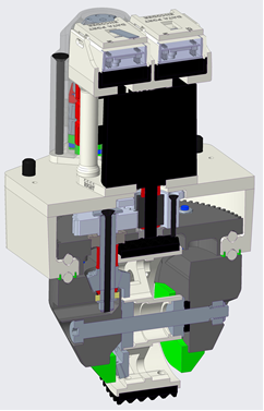

Nice work! I assume this is for development and testing only? Otherwise I’m not sure I would trust a 3D printed thrust bearing with plastic races to hold up a robot in competition.
Thanks! We have been using 1/4" Delrin balls in a PETG printed V grooves for 2 years (in separate swerve drives of course) during both on and off season competitions and have had no problems. This year, our drivers managed to get some ‘air-time’ off the charge station with no ill effects. We will be using this design on our competition bot in a few weeks (assuming the terrain is suitable for swerve).
I just did the calculation - in static mode, each contact point on each Delrin ball takes just 2.8oz for a full weight robot.
Nope, they’ve used these in competition. I was discussing them with one of their mentors during an off-season event this year, so I’ve seen the units directly on their robot. They really do stand up to hard use and are completely reliable.

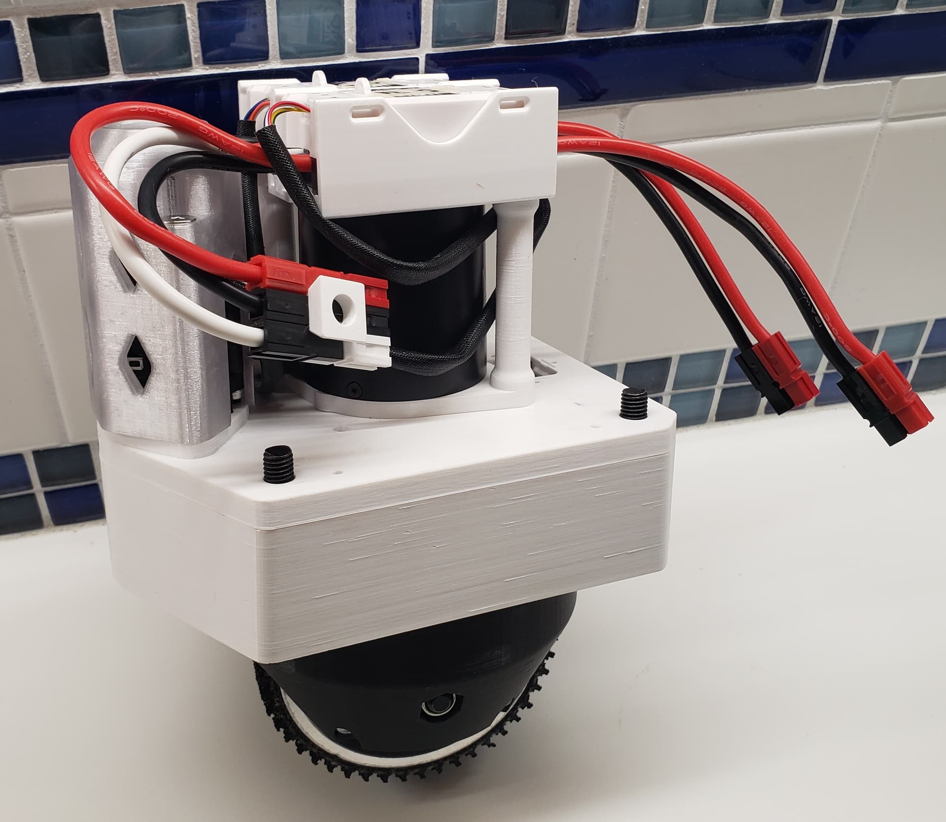

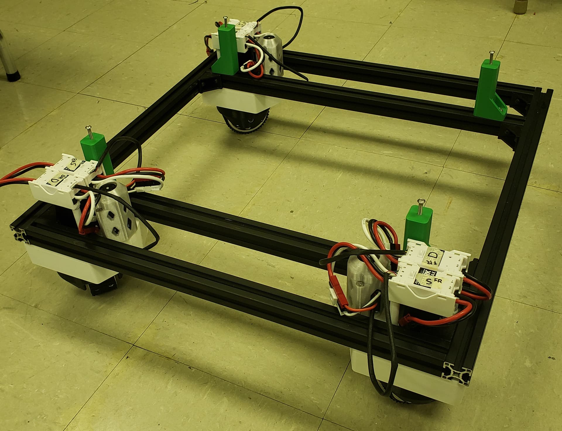

Do you have photos of the swerve modules on a robot and off it?
These look great. Low part count and built robustly. Would be nice to see some kind of reinforcement option and steel bearing for longer term use but I think it’s great as is for a low budget option. EDIT: nevermind, I see you’ve run these in season already. Wow!

This is the basis of our test bot, Mr. Anderson, with one swerve removed (and untidy wiring).
One assembly (w/o encoder, SM cable clips and wheel dust guards)
Thanks for the compliments!
Regarding life, we did a full year of on and off season competitions, plus a STEM event (Wings over Wayne) where we played every other match all day for three days. We are confident that they will last another year of demos to sponsors etc.
