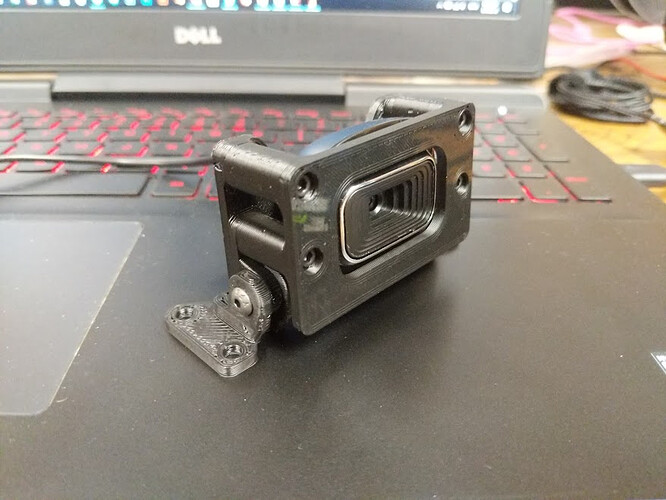

This is a mount I designed a few years ago: https://www.thingiverse.com/thing:1494829
Thanks! These seem very promising. I will try it out soon!

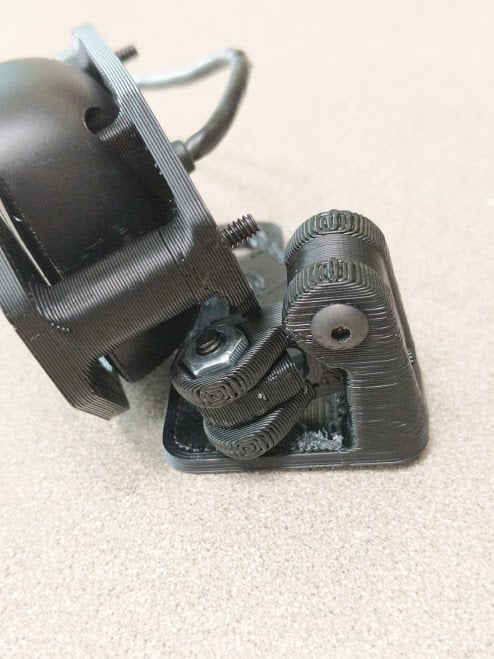

I have designed several Lifecam HD-3000 mounts including single and dual axis adjustable mounts and mounts with space for attaching LEDs for vision tracking purposes, they are in Code Orange’s public CAD library here: A Fond Farewell to GrabCAD Workbench - GrabCAD Blog
