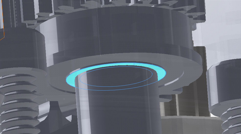

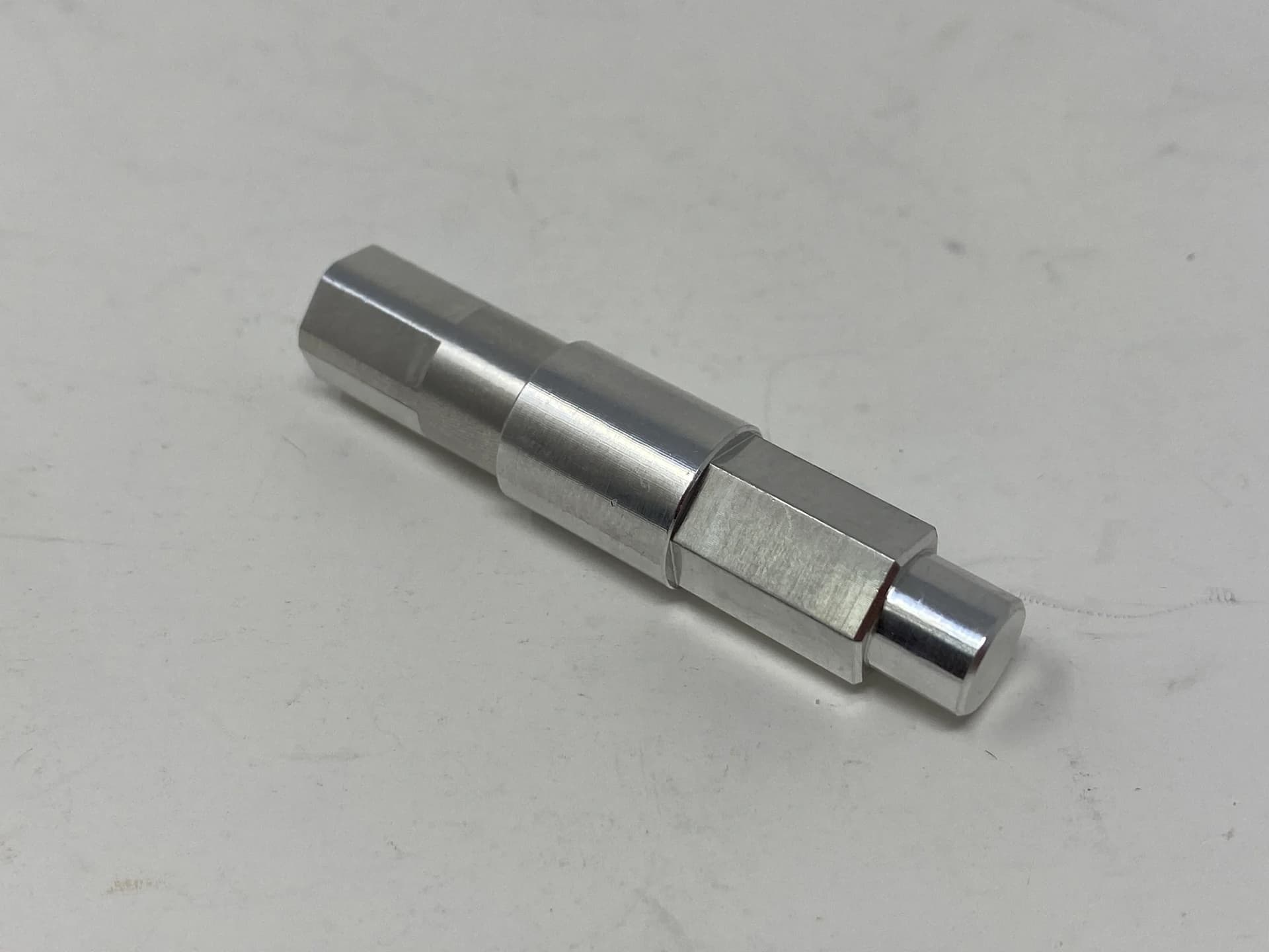

Didn’t notice the addition of the flange until this morning.
New Version
Old Version
I’m assuming this flange OD matches the inner bearing race OD for added support.
Nice extra added touch. Glad to see continuous small improvements are always on your mind and being implemented. Excited to get these new shafts swapped in as soon as we get em.

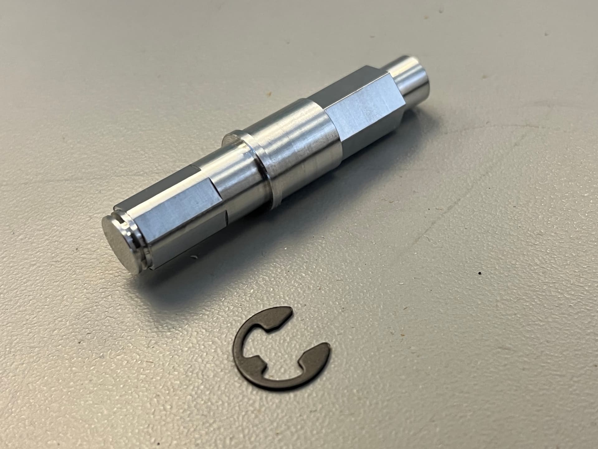

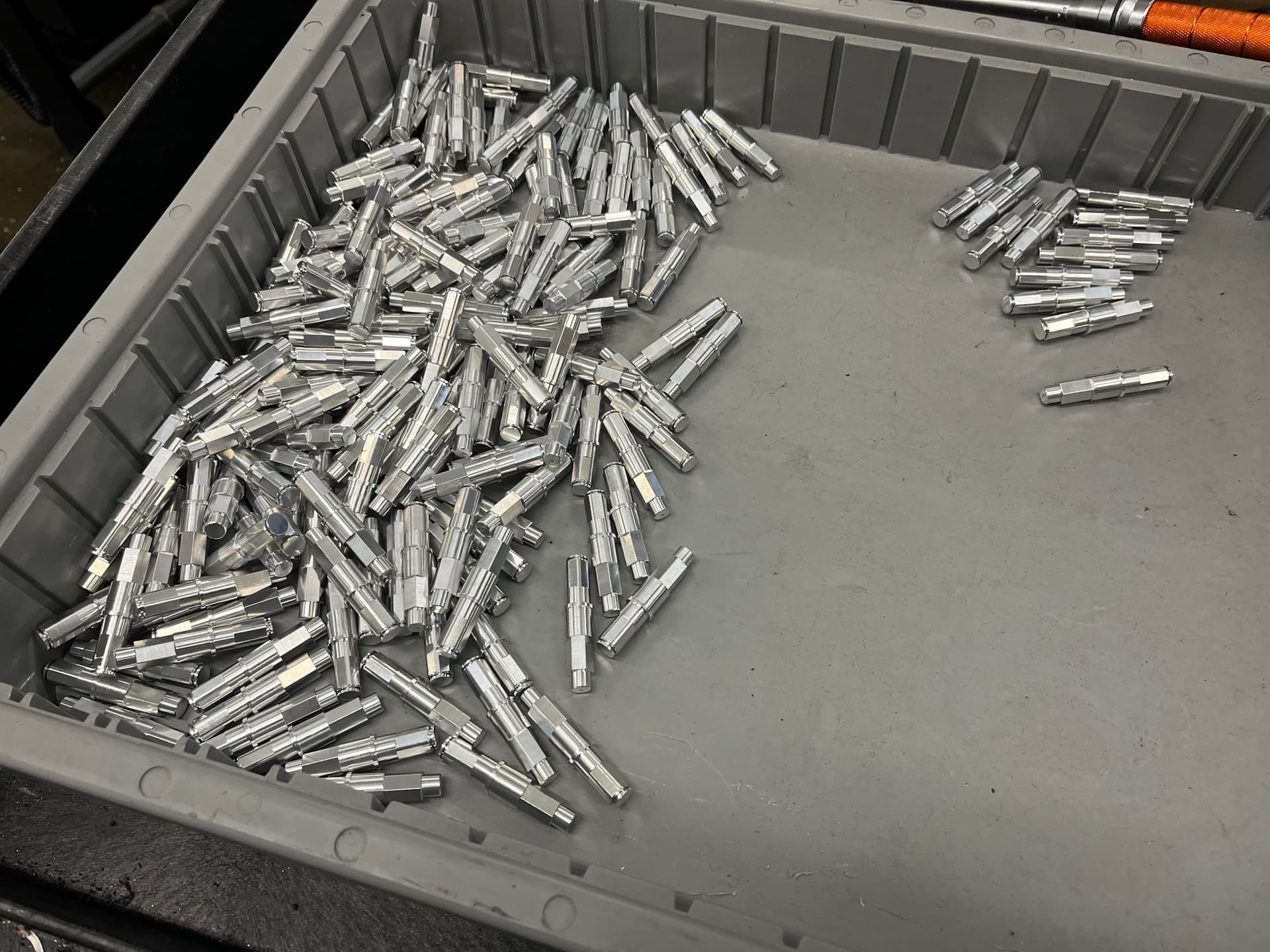

Production of the new shafts began this morning. The new shafts will be tested on multiple robots tonight and tomorrow. Assuming there are not any issues during testing, the shafts will be in stock on the website starting at 12:00 PM EST on Friday (2/24/23). The product page of the V2 shaft is live. The shafts will be available at the sale price of $1 through the end of this years competition season. The quantity limit per order is 12.

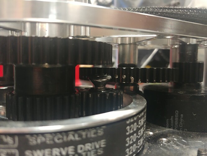

Add 8825 to the list of teams with this problem. We only have a few hours of practice on a flat field in and lost 2 of these screws. We do struggle with students over tightening things. I have to remind myself how many screws I stripped before I could feel a screw or bolt yielding, knew how much torque was reasonable and when to grab the torque wrench. But I can’t tell you if that was the issue for us.
