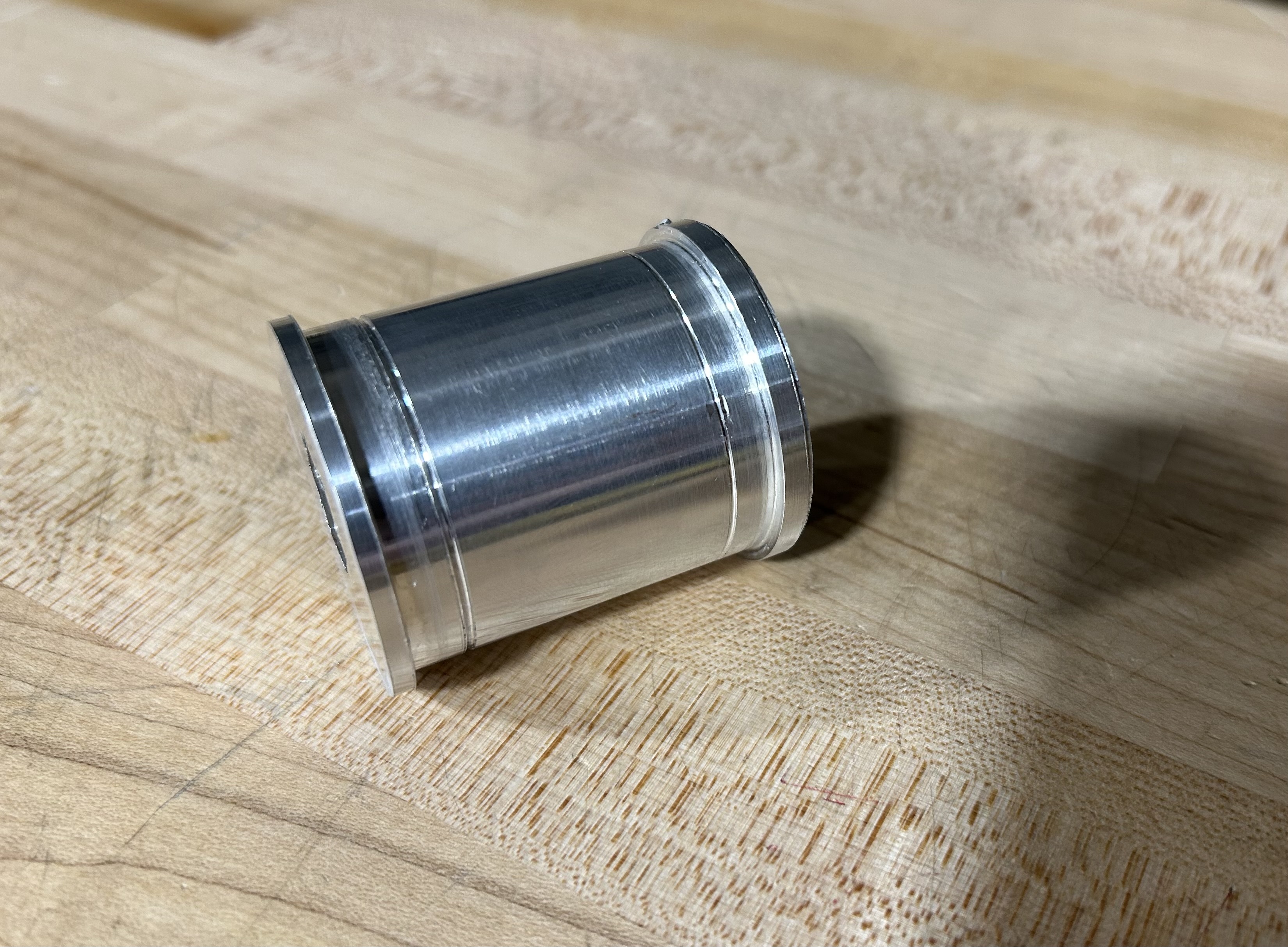

The reason (I think) we don’t order rod stock is one, why this whole thread exists, we’re worried we’re gonna buy a lot and waste it furthering our ever growing pile of aluminum scrap, and two the team does spend a little too much money elsewhere and then when metal stock tends to be kinda pricey people start second guessing the need to buy it. In the end however they’re not the ones machining the part so I get why they don’t have a problem with a bijillion interrupted cuts while turning down hub shaft.
Just for reference this was the part that started it all, being the first to require an internal hex
You can’t avoid this unless you don’t do any machining at all, I don’t see the point.
