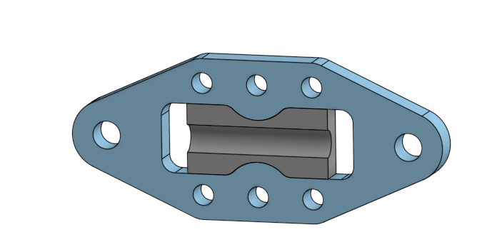

The few-hundred dollar figure was using custom bearing blocks replicating Thrifty’s (essentially, machining something functionally identical to theirs out of aluminum with our CNC, then doing the zip tie slot on the back with an angle grinder. We’d have to skip the bits that stick out the back and on to the sides if the 2x1).

I just did a quick mock up so don’t judge the dimensions too harshly but you could copy thrifty’s pretty quick. As said above you lose the tabs on the back to square it on the 2x1 (which are nice but honestly not necessary). Then the center holes could be made a little bigger and the zip tie could just be a little longer and go through the 2x1 (a little annoying but not a big deal). the center bit is 3d printed. holes have 1/2" spacing to fit common designs.
