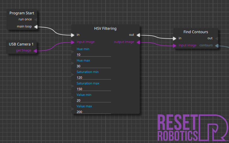

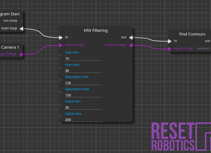

Heres a big update on whats going on
The original design plans were wiped for something that looks completely different then that was originally in mind. The purpose of this project has also changed and so have the similarities and differences with GRIP.
Code Generator’s Purpose
This will be a graphical scripting engine that allows people to write vision scripts without needing to know a single line of code. The engine itself could be used for anything, but we’re focusing on vision first because we’ve noticed many teams struggling with its complexity and we’d like to help lower the barrier to entry.
We are planning on eventually expanding it to cover different use cases, and turning it into an educational tool to help people learn programming. The main difference between this and GRIP is that this will have more of the basic programming functions, such as loops, ifs, mathematical operations, and logic, rather than just vision processing. Also, this aims to be more flexible than grip with what you can do. When this is done, you should be able to be running four different camera pipelines simultaneous each with their own operations and conditions on when to run :smiley:
The visual script will be compiled into regular code, and will support multiple platforms including the roboRio, raspberry pi, and nvidia jetson with GPU acceleration. It will also have a live mode, where you will be able to run your script from within the program, edit the flowchart while it’s running, and see how your changes affect the output in realtime.
There will be monitor blocks that you can use to view images being processed by your script, as well as other data like booleans or numbers. Monitors will be ignored when compiling the script. Eventually, we might create a version of this tool that could be used for every aspect of FRC programming, including main robot code and smart dashboard. However, we would like to ask if anyone would actually want to use this tool for things like robot code and smart dashboard.
Here’s a sneak peek so far…
