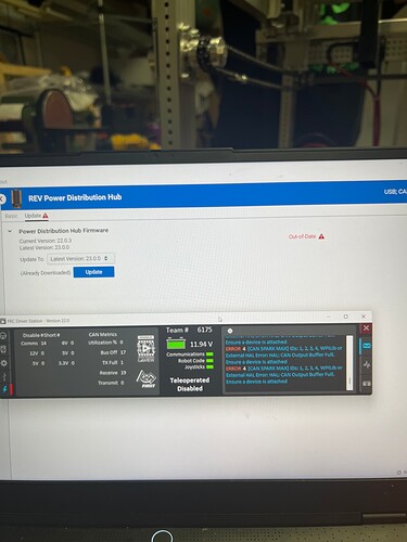

Hi again, I have fixed my issues with my RoboRIO, but now I am getting another error. I have correctly burned all of my spark max controllers with the correct CAN ID. The only think is that when I go to update my PDH and my Pneumatics Controller it said Failed to load Boot loader. What can I do to fix this.

Your error message has the detail you need
CAN Output Buffer Full. Ensure a device is attached
I’ve only seen this messages when
  1. The bus is not connected correctly to the roboRIO
  2. There is a short between the wires anywhere on the bus
This is most likely a wiring issue.
