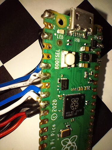

Would you be able to upload a picture of how everything is connected?

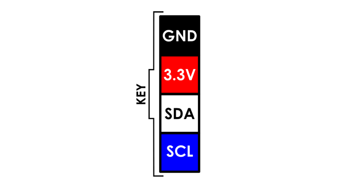

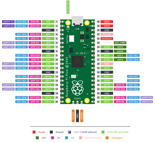

The only tidbit I can share is that we’d flipped pins for SDA and SCL the first time with the pi pico. So it might be something to check.
This was the backwards connected pico, since SCL should be pin 7
edit: I think the RIO I2C pinout might be part of what led to the confusion
edit2: I was a little unclear about how you mentioned it working once but then not again. You were able to see it connect/get values the first time? The light still working indicates you still have power connected, but not much more on the signal. You may want to post your code if it seems to be potentially programming related if there isn’t something wrong with the data connections.

For reference, we just cut the regular length cables with the REV color sensor at one end to solder to the pico. And I think the pico had a longer PWM cable to connect to the MXP slot SPI pins.
Correct me if I’m wrong, but shouldn’t it be the MXP UART pins?
Edit: Oh, you’re not OP. My mistake. Question to OP, by “removed” do you mean a wiring change?
I think you are correct, we didn’t use it this year so it’s been a second.
Assuming Thad House’s Pico code, yes, it is UART.

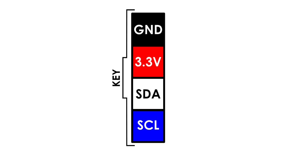

At least for why the Rio isn’t running correctly, the i2c and the Rio have different pin maps with SDL and SDA swapped. This is why the light turns on but the Rio cannot detect the color sensor. Although be warned that the color sensor with the Rio is sensitive to lock-ups, so plugging into the Navx or using the Pico would be better.
For clarity, the i2c lockups on the Rio aren’t exclusive to only the REV color sensor.
