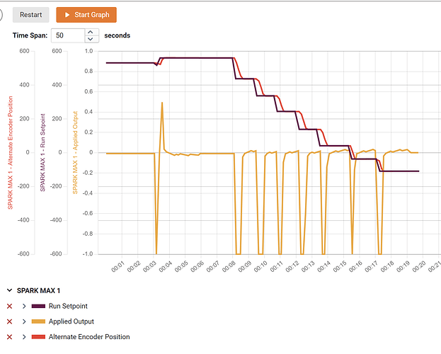

I have built a test stand for working with a Spark Max and a DC motor with encoder feedback.
I can run the motor in “Percent Mode” but when I try to run the motor in Position mode the control loop seems to be disconnected some where. The motor runs as if it were in Percent Mode. The output sets motor speed to fast and the position value increases (or decreases) and it goes sailing right past the set point without any change in the output. I can change kInverted and get the motor to run the opposite direction and it again sails past the setpoint as if it doesn’t exist.
I was able to run a Neo Motor in Position mode and get it to stop at the setpoint. I did some tuning and got it to work ok (unloaded).
But for whatever reason I cannot find the setting that gets the encoder feedback to connect with the control loop when running a brushed motor. It seems like a fairly straight forward operating condition but it just acts like the feedback is not connected to the control loop.

The documentation for the REV hardware client only seems to hit the high points. I haven’t had any real trouble with the client disconnecting or anything like that, though I only have a single Spark max on USB connection. I can run percentage mode. Percentage and Position modes with a neo motor. The Position value in telemetry mode increases and decreases as expected with motor rotation.
Hitting run motor will cause the motor to run. When Positiion crosses Set Position, the control loop doesn’t do anything to change the motor speed. Its like the summer at the front of the control loop isn’t getting one of those inputs.
Is it always the same output speed regardless of your initial error and PID constants?
Yes. If I tweak some of the things like Max Output I can change it, but it basically goes to full speed. I can use kInvert to change the direction.
Also if I rotate the motor by hand with the telemetry graph running the feedback position will change as expected.
If the output changed at all as the feedback position passes the set point position I would think my kPIDF was messed up. I would expect to see all kinds of overshoot or undershoot, but I am getting nothing. Currently my KP and KI are set to small values, kF and kD are zero.
Its the no control response at all that bugs the crap out of me.

My guess is that the position you’re plotting is not the number being used in the control loop. One thing you could try is setting your constants to zero and seeing if there’s any output. That would confirm whether a calculation is being done or if there’s just a bug in the software.

OK, figured out the issue. I think. I changed a few settings and it started working then I could tune it and now it is ok.
Main problem Parameters were kPIDMinInput and kPIDMaxInput the default for these are only -1 and 1. These values are in the Closed Loop section of parameters, not in the encoder section. This resulted in the feedback never reaching a useful value even though telemetry said it was.
Rev Documentation description is: Min (and Max) input expected to be sent to the controller. This is in the units after any conversions using the position conversion factor for the selected PID feedback sensor.
I am assuming this means that the feedback value is limited to the range defined by these min and max values.
kIZone may also have been part of the problem at its default value of 0. It was allowing the Integral factor to get all wound up.
I also tweaked kOutputMax_0 and kOutputMin_0 though I think these were only a minor part of the trouble.
Still don’t know how to set the initial feedback position other than it is 0 at power up. Under software control you can run the device into a hard stop and set a known position. Can’t do that from the hardware client.
Is there a particular reason you need an I term in this controller? As soon as I saw the graph and you mentioned “very low values” for P and I, my thought process went to integral windup. Unfortunately, I’m not very active over the summer so I just saw this thread.
