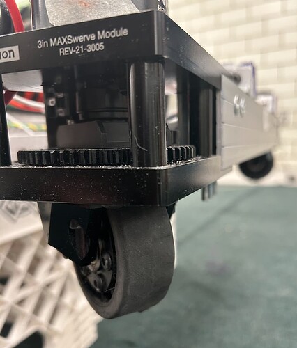

REV MaxSwerve Wheel Shaving
My team bought 4 MaxSwerve modules at the beginning of the year, and one out of the four wheels keeps shaving. A couple weeks ago, the module was covered in grey shavings, and we took it apart but couldn’t find where the issue was, so we decided to leave it. I checked back today after a lot of driver practice, and it looks like this now :fearful:
Has anyone else had this problem? Or know how to fix it? It’s not the treads coming off, just being grinded down somehow.
Are your wheels dragging? Spinning? This would be indicative of a software issue. Did you use the REV swerve template or something else? If REV, did you update after they added the SlewRateLimiter a week or two ago?

We’ve probably driven our modules for maybe 3-5 hours (not exactly sure because we were tuning code while we were doing it) and we also have 3 wheels looking basically exactly like that. One of the wheels seem to have significantly less wear, could be something weird with how it was assembled (I’m thinking it is somehow elevated above the others).

OP what do the other 3 look like? Is the weight of your bot evenly distributed?
This may be the million dollar question.
Based on the OP, it sounds like this wheel is wearing more aggressively than the others - with no obvious mechanical issues.
As you alluded to - what’s the weight distribution? Is it very heavy in the opposing corner?
Is there anything that causes the frame to flex dynamically - or is the frame “Bent”. An underloaded wheel would wear like this - as it may “Slip” more often than not, which would point to either a really offset center of mass (one wheel is strange though) or a really bent frame - which is not unheard of.

There’s a lot of truth to this - smaller diameter wheel will use “More Tread” per unit “Real Distance” (so physical distance traveled) since it rotates more. Beyond that, it’s been shown that smaller diameter wheels have higher contact pressure with carpet (Diametrically smaller wheel is “less flat”) which will typically lead to some fun interactions at the micro level.
That said, asymmetric wheel wear is almost always due to a Wheel being Over or Under loaded (Overloaded increases scrub, Underloaded allows for Wheel Spin) - Root causes of this get a bit more fun - could be bad CoM placement, could be a bent/flexible frame, could be running the same cycle on a (very) not flat floor enough times will cause the issue.
Ooh! Two of the major things teams doing swerve for the very first time during build are likely to discover the importance of!
(In all seriousness, if this is your first swervebot these two things are very important. You will want to check your COM and if your frame is bent/ overly flexible. This is especially true with all the hard hits that are bound to happen this year)
