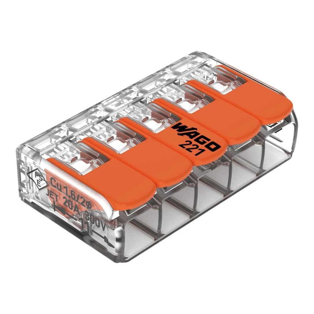

I love the Rev Mini Power Module form factor for sensor power distribution, and am trying to find something similarly sized and price while they’re out of stock.
Amazon has ATO/Mini fuse blocks, but I am not getting any useful results on the “ATM” fuse size used on the Rev module. I tried ordering one of the Mini fuse blocks but it’s enormous, like 5" square, super overkill.
I don’t want to put Andersons on all my 18-20awg sensor power wires, so the Andymark distribution board isn’t a great fit either. At least it’s small and I do have one on hand.
Do you really need fuses there?
You’re not wrong, I could splice everything through one PDH slot on 18awg and call it a day since it’s all custom circuits.
I have to power 4 encoders, a pigeon, and possibly a CANivore so it’s a fair amount of distribution and wire length. I strongly prefer single fuses per device/branch for troubleshooting purposes…
We use this sort of Wago connectors for this purpose:
We used one of these:
https://www.amazon.com/dp/B091F9CGQF
last season and were pretty happy with it.
