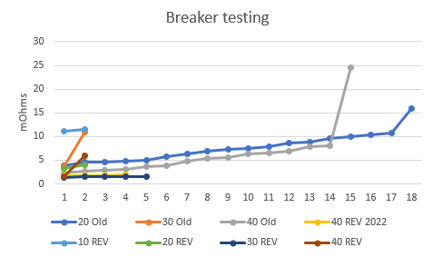

I did a bunch of cycles on a range of breakers, but I wasn’t looking for trip current or time; just contact resistance. Note that these were sorted; that spike at the end is an artifact of sorting, not end of life…
What is the x-axis in this graph? Number of times one breaker was tripped?
Test number. I wanted statistically significant data :wink:
So for the old 20A, for example, did you have one 20A breaker that you tested 18 times, or 18 different 20A breakers? And is this just resistance measured with a multimeter?
Each trace is a single breaker that got repeated tests. I had a rather limited set of REV breakers to play with at this point.
I used a high current precision power supply to drive the breakers to opening. I tested with both a 4 wire milli-Ohm meter and also high precision bench meters for Amps and Volts to calculate the resistance. I found my milli-ohm meter lined up very well with the dual meter method.
