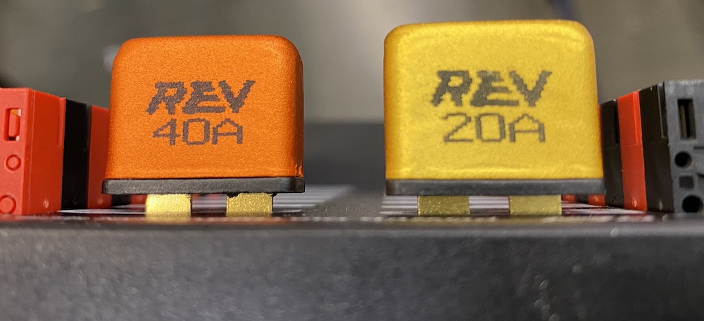

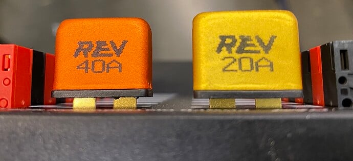

On a related note. I noticed that the breakers don’t sit flush with the top of the PDH. Seems like this is just waiting for small metal filings to fall down and short one of them out.
We’re considering mounting the PDH under the robot, so it’s upside down. Or just putting some sort of clear cover over the breakers. It was pointed out to me that the rules require the breakers to be “visible.”
Foam gasket?
My team did an upside down electronics board in 2020 (never saw competition tho), and plan on again this year.
So long as it can be visible you should be good to go. Just make it easy to remove in the event an FTA wants to look at it on the field. We needed a drill to remove the cover to it on our 2020 bot, and the FTA at one of the off season events wasnt happy it took so long. So we’re probably switching to some wing nuts or something
In normal operation (when the breaker is not tripped), the two terminals are effectively shorted anyway. So the only concern would be when a breaker trips, at which point whatever FOD is there will be carrying 10s of A or more and likely live a very short and hot life.

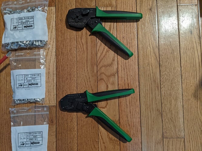

TLDR: if you use ferrules, you need to use the correct (square) ones, or derate two wire sizes. And the manufacturer recommends not using ferrules at all with stranded wire unless you are in a very corrosive environment.
FWIW, here are the crimps/crimpers recommended by the manufacturer of the parts used on the PDH:
They make nice square ends that work well. After crimping, the space between the strands has been (at least mostly) compressed away, and the area of the wire and crimp is now square, so the resulting height/width are probably slightly less than for an uncompressed set of individual strands.
Note that the ferrules shown are for the maximum size wire recommended by each of the connector types used in the PDH (WAGO 2616 / 2606 series / 250 series).
Be sure to get good quality ferrules purchased from a supplier that specializes in selling electrical and electronic components. I have used some in the past that would slip off after being crimped with a professional quality crimper. I suspect the manufacturer used a type of metal that was too soft, like cheese. If I recall correctly, they were purchased online from a company owned by someone who uses the profits to build rockets.
Agreed. Notice the brand on the ones in the picture. :slight_smile:
WAGO makes ferrules and crimp tool for use with these connectors. The finished crimp is square and gives the maximum contact inside the terminal on the PDP or PDH. Using other ferrules may not give the same contact area or retention. Your mileage may vary…
