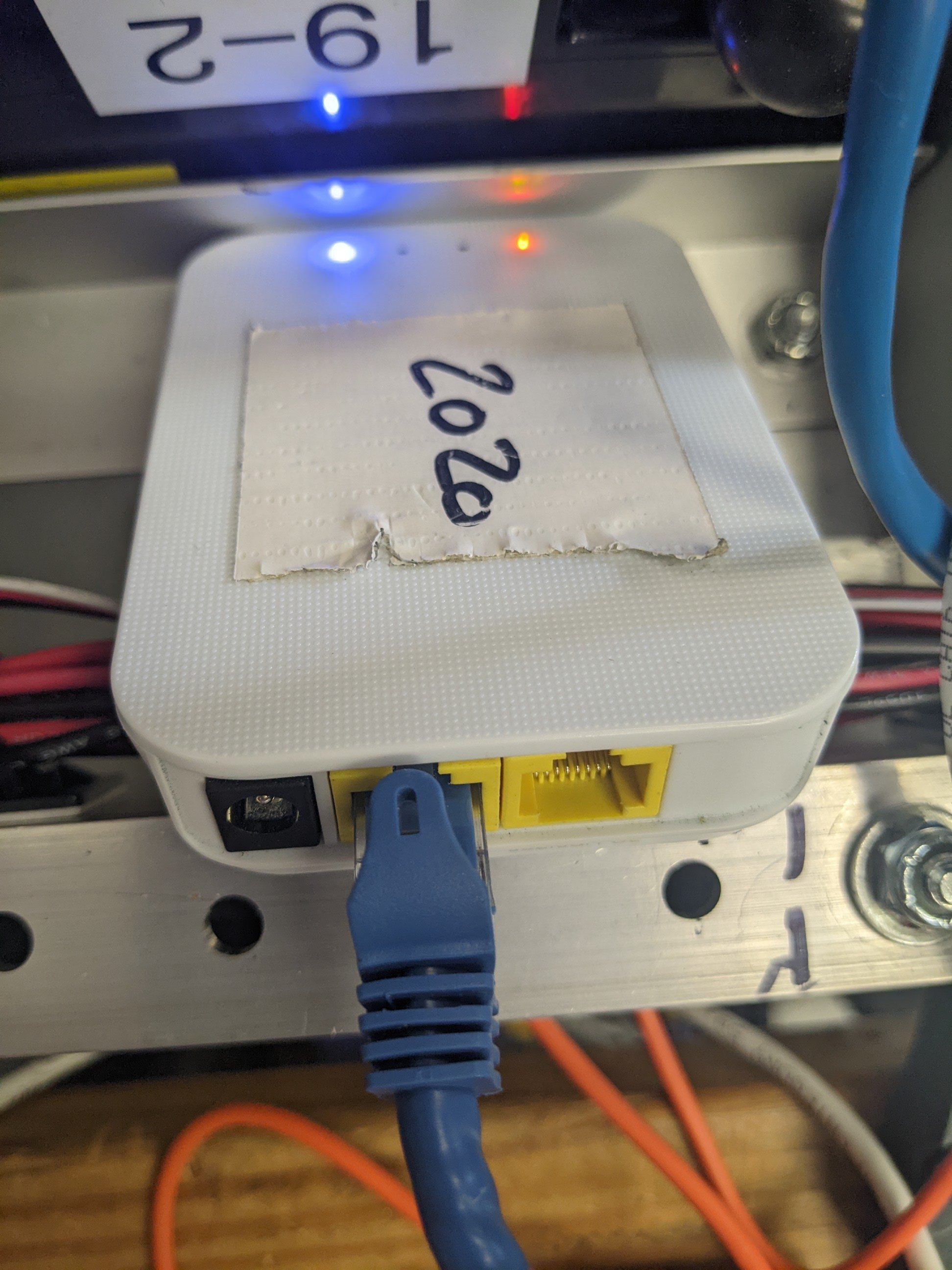

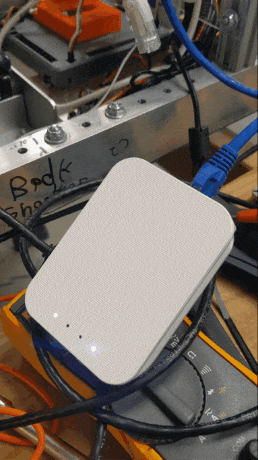

We have the rev radio power module all set and it is providing power to the radio. But after about 10-20 seconds the Ethernet status lights go off and there is not data connection flowing through to the radio. We tried a second power module and we are getting the same result. Any ideas?
Can you provide some pictures of your wiring? Specifically ethernet connections

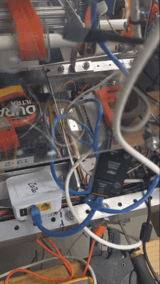

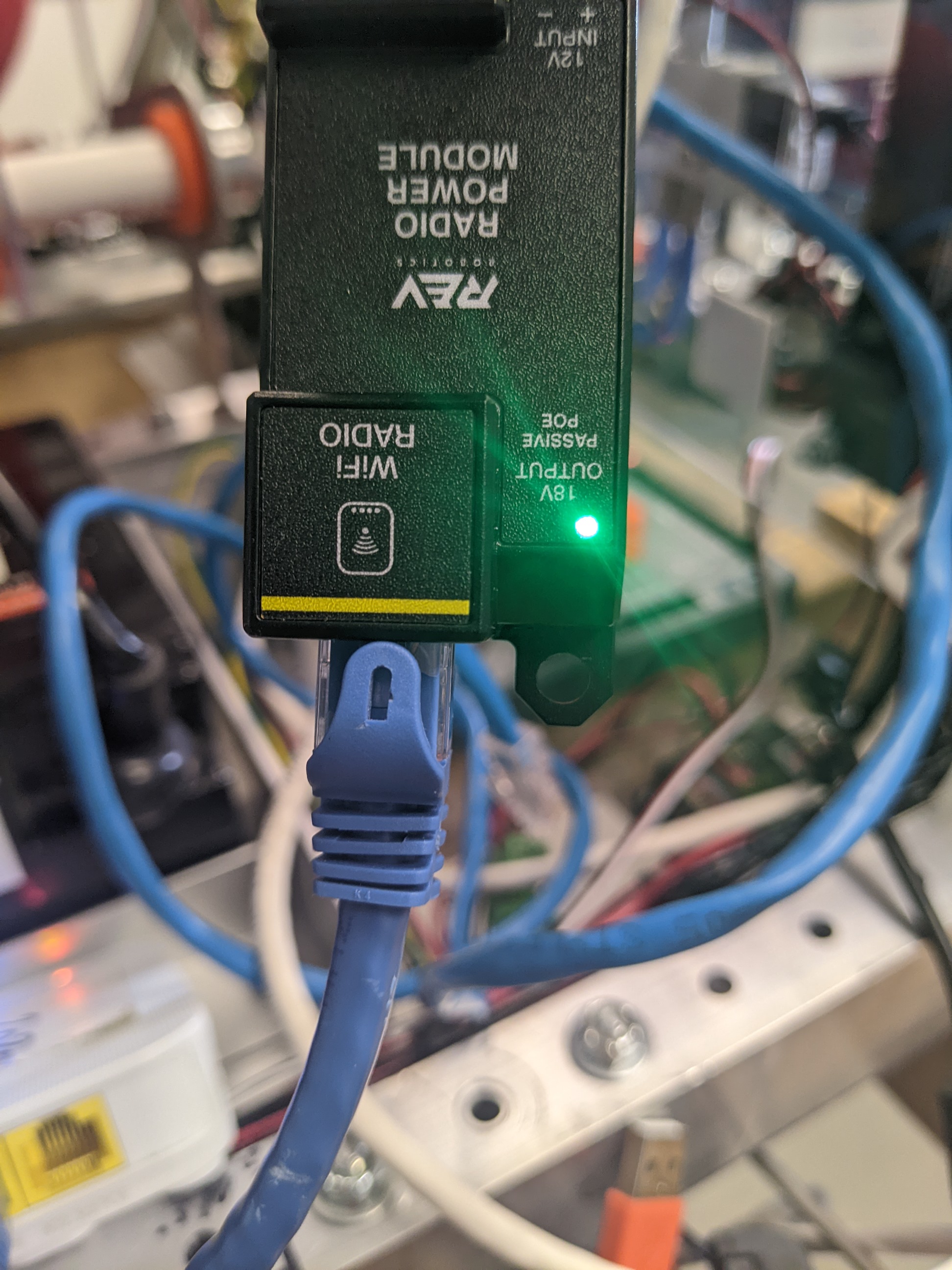

Here are some pictures of the connections and a video of it starting up.
20220218_092855
Thanks for sending photos. Do you have any photos of the wiring leading into the RPM?
The data lines are directly wired from the input connector to the output connector. If the RPM was the source of the issue, it would likely be power related and not data related. From your description, it sounds like the radio has consistent power, so this may indicate there is an issue somewhere else in the path, like the radio itself, ethernet cables, or the roboRIO.
Please reach out to us at [email protected]. We’ll need some more details on what troubleshooting steps you’ve taken already. For example, have you tried powering the radio with some of the other legal configurations?
Hopefully we can get you up and running quickly!

Our issue was a little different. The radio appeared to boot but did not stay powered long enough to connect the driver station or any other computer.
We do appear to have resolved the issue. There are two things we did, not sure if both were necessary or not.
  1. This was a new Rio 2 and we had formatted it and set our team number but we had not put robot code on it yet. So today we installed the RobotPy libraries and deployed our code to the robot.
  2. We were using a 2020 radio and could not get the firmware to update. We switched to an unused 2021 radio, updated the firmware and configured and now all is well.
Now the RPM is handling the power and data without issue.

The data lines are just a strict pass-through. Its power regulation is not dependent on the presence or absence of ethernet signals.
It looks like in your new video, you are no longer using the white ethernet cable. Could that have been one of the issues?
Unless it wasn’t captured on your first video, I don’t think the RPM was exhibiting any power issues.
We did change the cables earlier but we had the same issue. Power was supplied the entire time, never had the power drop out. Our issue was that the Ethernet stopped providing data. We just tried an older radio and it is working well. Only other possible cause I can think of is the rio not having robot code and libraries installed yet. Oddly, if we ran data directly to the radio and used the RPM to power the radio it worked fine. But if we ran the data and power through the RPM it would stop sending data after a few seconds. Hopefully this helps someone else save a little time.
