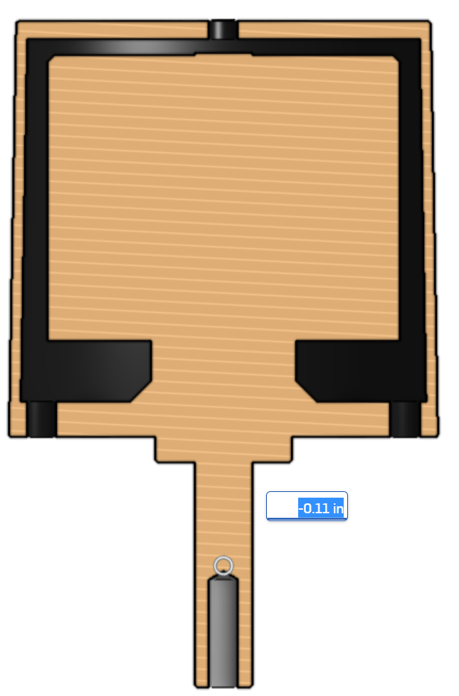

Not necessarily. Button head would be tough because you can’t use the flat top of the head of the screw to stabilize the motor while pressing. Hex head would likely work fine.
As mentioned the distance from the back housing of the motor to the end of the shaft is <3/16in (~0.17in) so anything less than that (i.e. 1/8in) is fine to leave in the hole as a plug.
The same applies to a pneumatic fitting: as long as the threaded portion is short enough that it doesn’t contact the shaft, it won’t cause any interference issues.
the CAD would indicate so

If the distance is <3/16", why do you call out a 3/8" bolt for pressing on pinions?
Just to clarify, anything short enough to be used as a plug is not suitable for using to press pinions on the shaft.
REV really said “you put 6 mounting holes on the Falcon, well we’ll put 7 on the new NEO”
Well, yes, but would a 1/4" bolt be sufficient to press pinions? What about 5/16"? Seems pedantic, but 3/8" is double the length of the supposed clearance.
I don’t have a particular reason why I want to know, I just want to know lmao
Most screws don’t have fully formed threads all the way up to the head so 1/4in screws run the risk of bottoming out on the threads rather than the shaft and not performing their job correctly.
3/8in is the next size that teams commonly keep on hand so it’s the ideal size for this task.

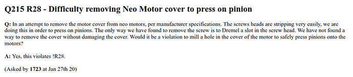

Ngl, the hole in the back of the housing gives major auto technician energy.
“we can change the oil filter in 10 minutes by hole-sawing this plastic panel vs the 2 hours to take it off”
Meanwhile there should have been a hole from the factory. Now you’ve got me thinking that some team just drilled a hole in V1 NEOs…
Check these out …8mm Shaft Spacer - 1/8in - 10 Pack - REV Robotics
Something tells me this won’t be a problem for many teams moving forward…
Someone’s at least considered it. From the 2020 Q&A:
