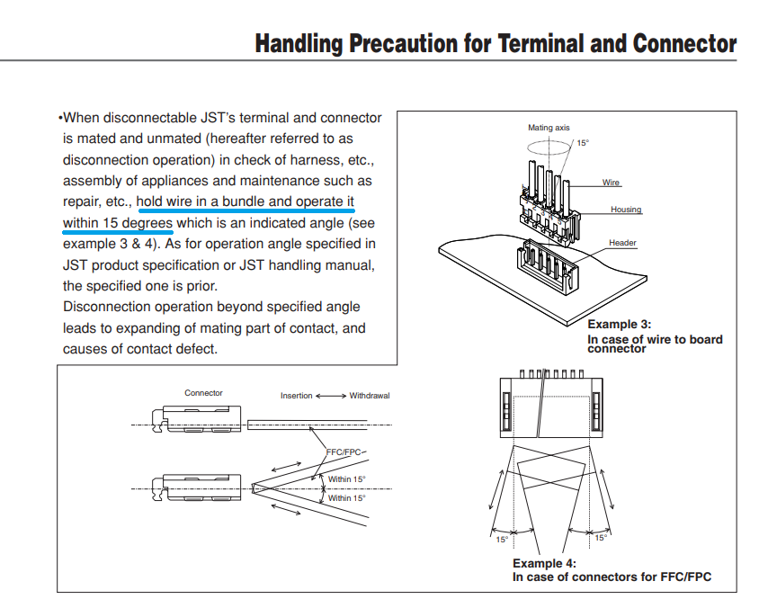

Some wire-to-board connectors, when properly crimped, are designed for removal via the wires: An excerpt from the JST Handling Guide for their various terminals, including the wire-to-board JST PH that is used on the NEO:
I want to double emphasize the need for proper slack and strain relief. With improper slack, you increase the chance of there being a failure. More from the JST Handling guide:
I agree, however, that prying the connector out reduces the chance for failure.
This may be correct if one strictly follows the guidelines from JST for just these connectors. Unfortunately, your recommendations will be taken out of context and applied to connectors for which pulling on the wires is NOT recommended.
