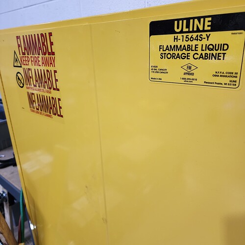

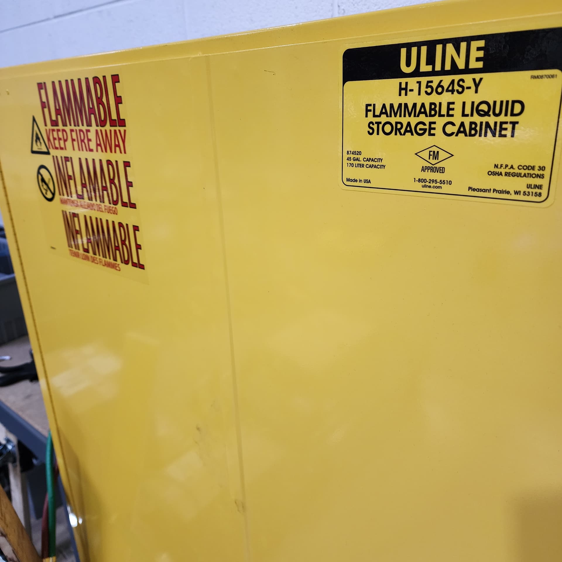

Long term storage is the biggest complaint and the school made us get a Flammables cabinet for anything we keep there. Especially over the summer when no one is around.
We have the same kind of cabinet but larger at work
