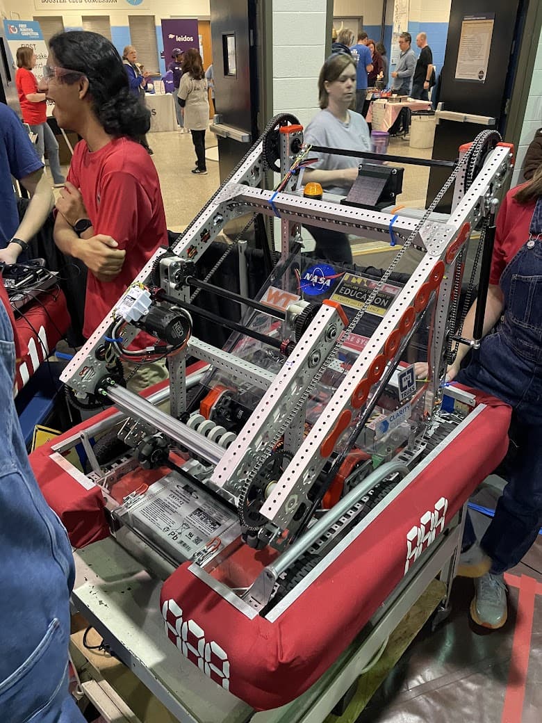

888 - Robotiators used it pretty successfully last weekend at the CHS Bethesda district event:

888 had a great robot! Their mechanism I think was the REV starter bot, but it looked like they were using the Plummer Industries drive rails. But, I didn’t get a super close look.

You are exactly correct, the Robot was the REV Starter Bot, with Plummer Drive Rails, 2nd year with the great Drive rails, and now the REV bot might meet the Everybot intake to make more of a REVERYbot. It was even more special for the Team on Sunday to show the REV Starter Bot to @Greg_Needel and how the team was able to take the starter bot concept to another 10 to 15% further and now is making the last 10 to 15% adjustments. Thanks for the visit.
That’s correct, we (4473) built using the REV geometry with undrilled box tube. We also had to use alternate gearboxes. We are presently rebuilding the arms and tower with MAXtube and some updates to try to reach farther while being half the weight, we think we can hit the high cube shelf with this, pending testing. By mounting the tower in the next holes forward on the chassis, there’s room to move the gripper mount 2 inches farther away for a total of 2.5" more reach. We are also adding a second arm motor/gearbox and chain on the opposite side for some redundancy and strength. There’s plenty of room to take the design further.
We are also updating from the stock kitbot Toughbox minis with NEOs, to the Thriftybot 3 motor plates to hopefully add some acceleration as all the swerve bots were just running circles around us. Our largest issue in competition was that we kept breaking the single arm lift chain from the arm gearbox to the jackshaft. I think we broke 6 of them likely due to our arm being heavier than REV spec and also a machining tolerance problem partially fixed with coke can shims around some bearings. We added a second parallel chain as a bandaid and drilled a bunch of holes to lighten the arm a little. That got us our best matches Sunday morning and through finals. The gripper worked reliably when operated properly and required no attention. Overall the arm system is easy to work on, and was simple to build for some very inexperienced build team members. We don’t have any regrets with the choice to build the starter bot, it’s been a great experience for a very green build team.

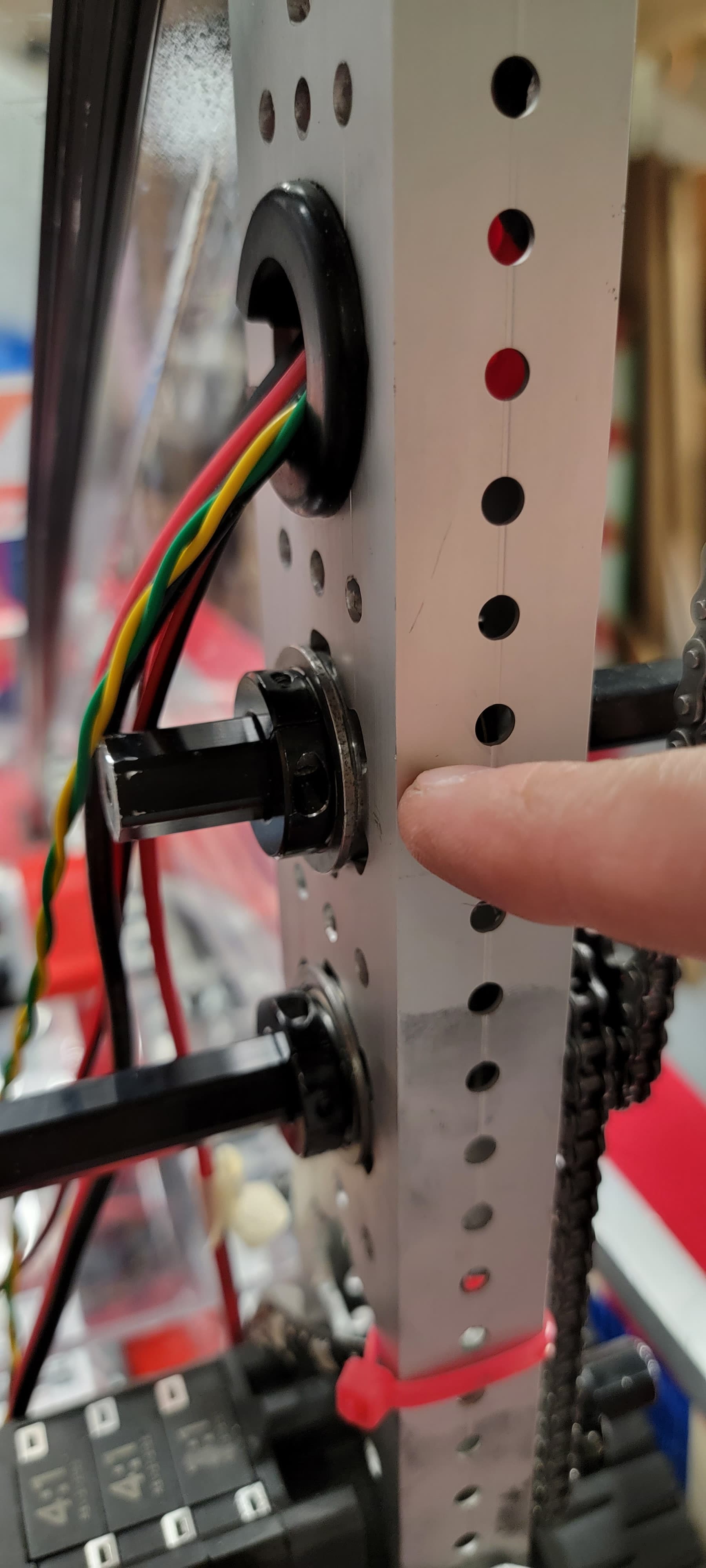

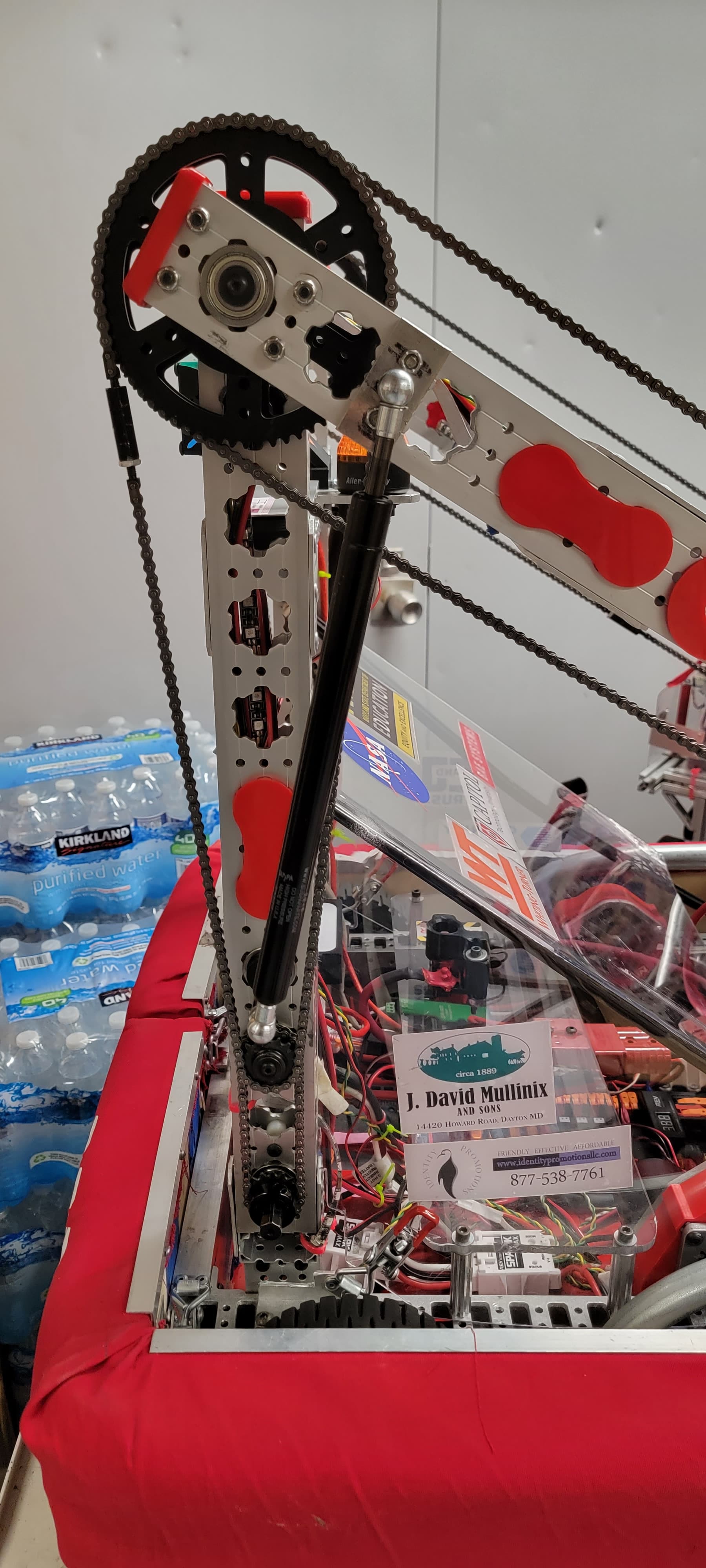

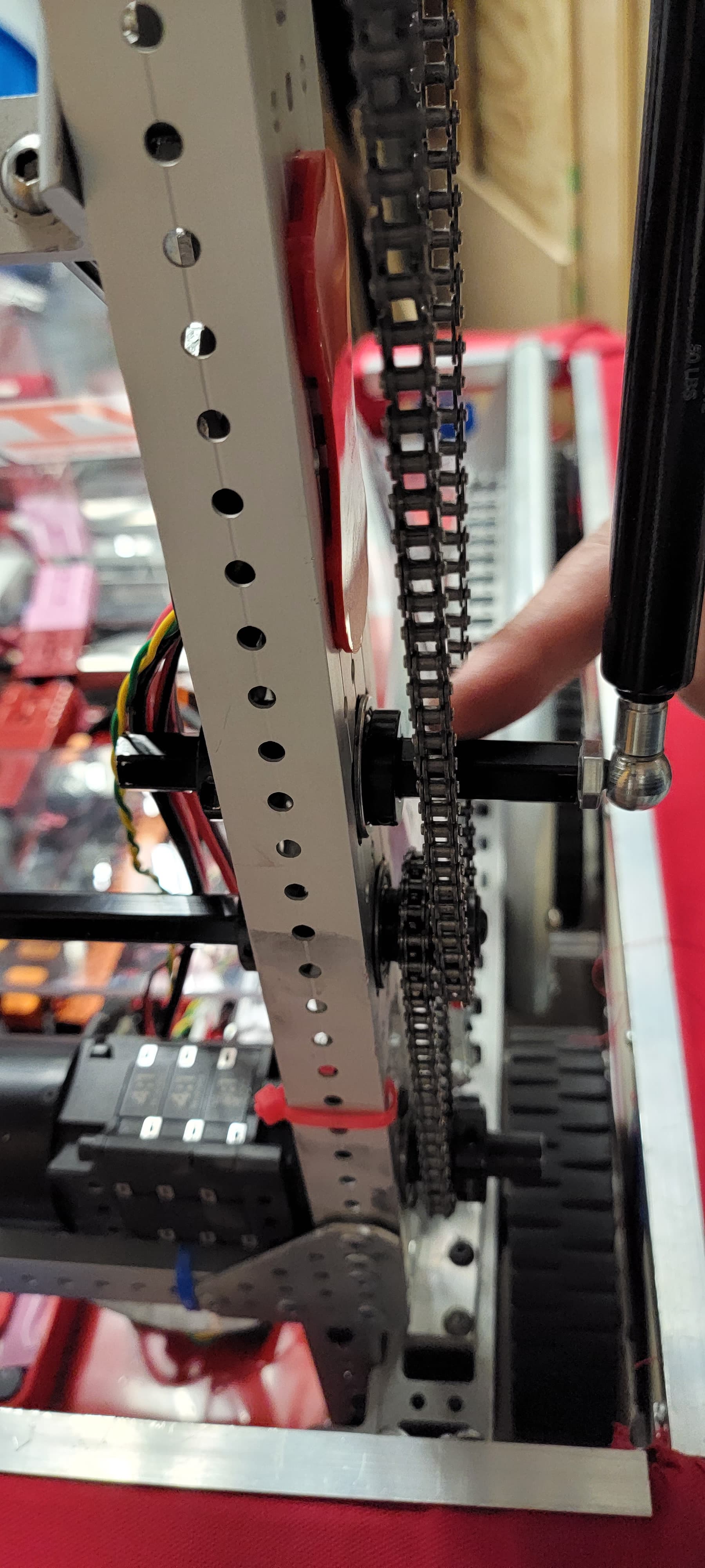

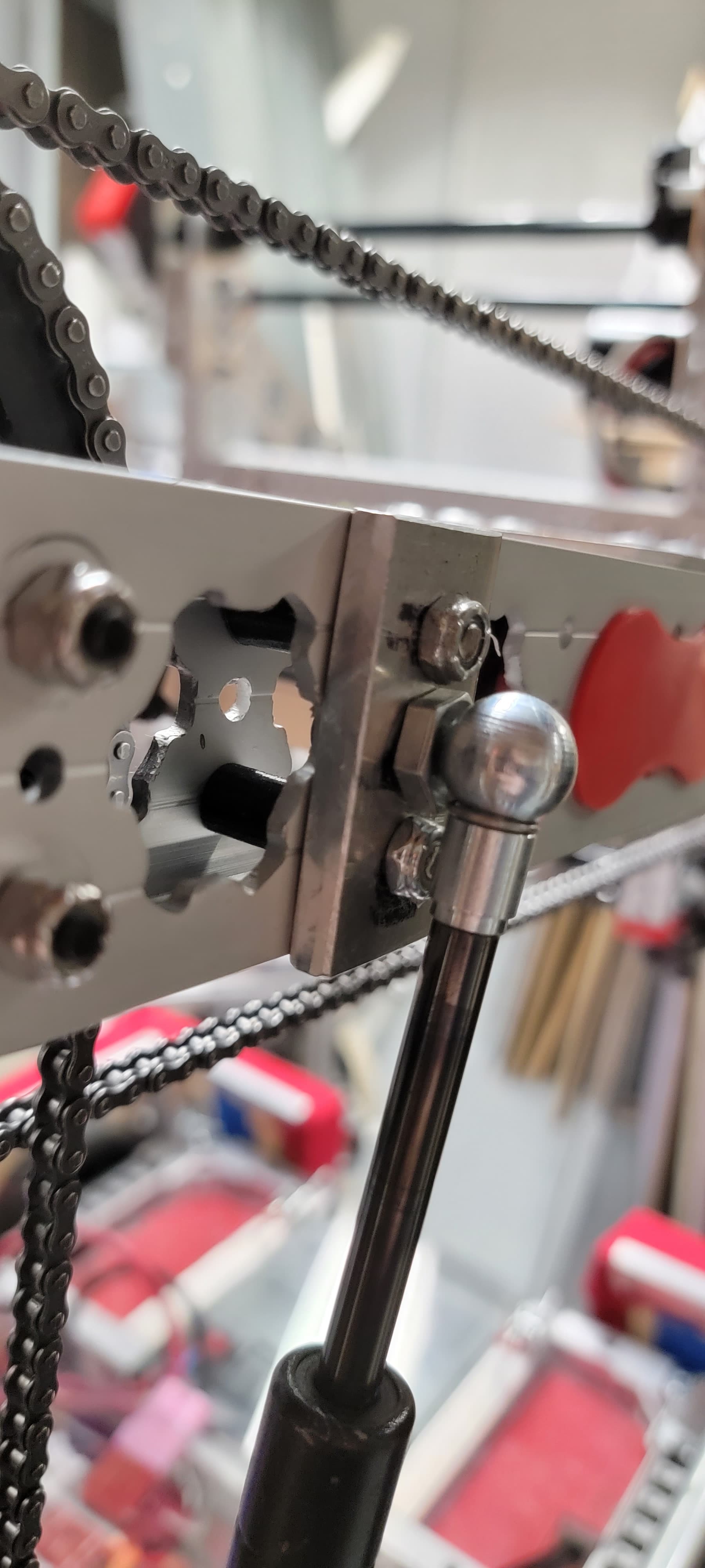

In order to help with the weight of the arm we added gas shocks to each side to assist with a more balanced lift and set of the weight of the arm, McMaster-Carr

I’d love to hear/see more about how you tucked in the gas shocks. I’m imagining an extension off the tower through the chain to the outside of the arm? I went through the blog and didn’t see it if it was there.
Awesome, thanks! We’ve got some gas springs on the way now. I think we can just barely tuck those in and stay within perimeter. Watching 888’s recorded matches it looks like those really help smooth out the arm action.

Here’s a few up close shots of the gas shocks
