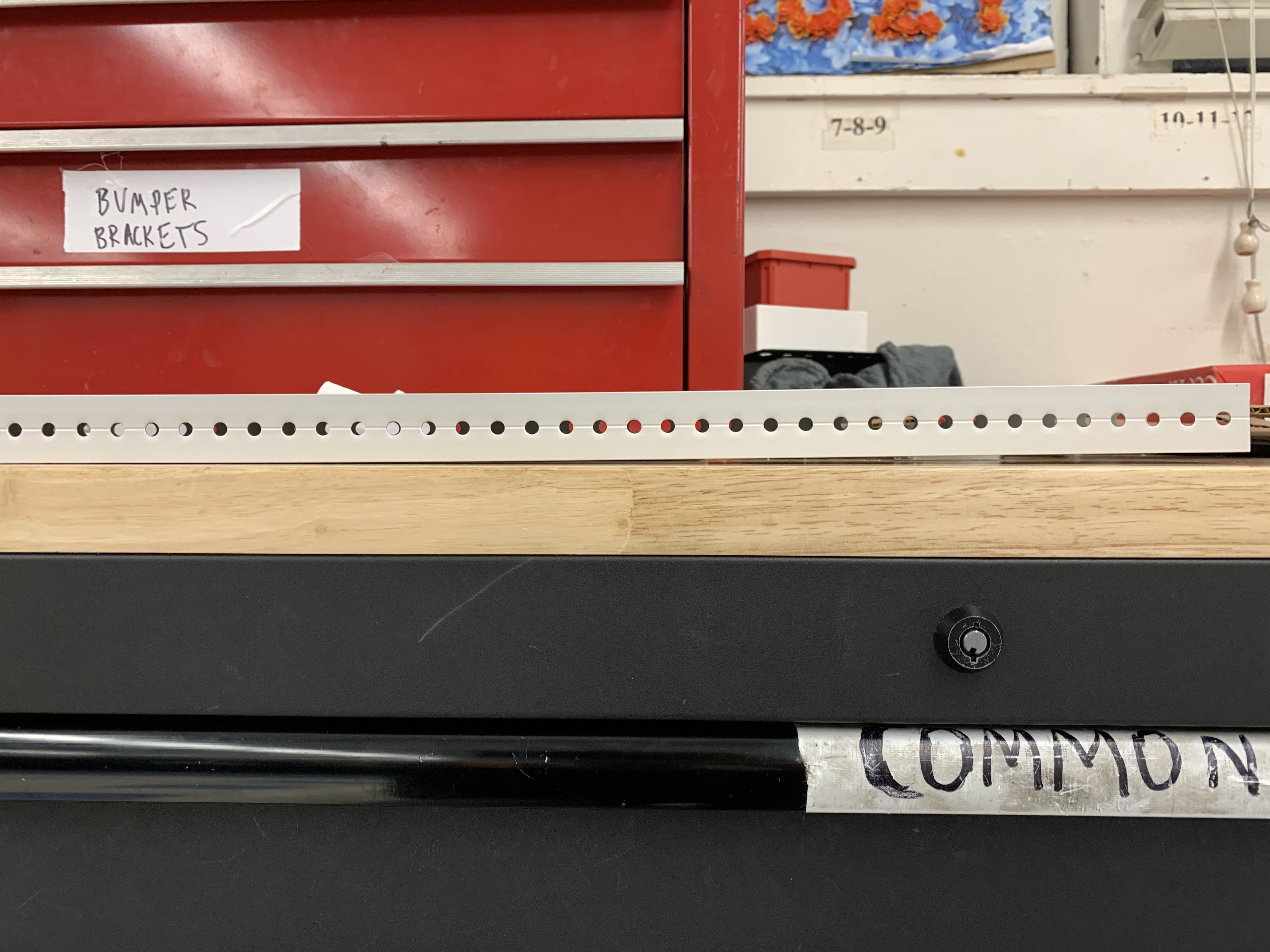

Rev Stock Arriving Bent
Have any other teams had Rev MAXtube arrive bent? we had one egregiously bent piece arrive and at least one other piece with a very subtle bend that didn’t show itself until the piece had been cut and assembled. Very disappointed so far considering we paid a premium to buy the fancy predrilled tube. The tubes also shipped to us with 0 protection, just stacked on each other in a box with no shipping material.
Have any other teams had this issue, and has Rev been willing to send replacements quickly? This is at least a week setback for our mechanical subteam.

Do you have photos of the damage/bending?

This sounds like shipping damage. Send us an email and we will replace them. I’m sorry you had this experience, but shipping damage like this does happen from time to time and we always take care of it.
If you have any photos of the outside of the box or how it was packed please send them along as that will help our warehouse improve their process.

Please reach out to support as well. When it comes to package damage the distance things traveled does have an impact, but one driver dropping a box or it being placed under something heavy can cause issues. We generally just replace items that are damaged during shipping and move on.
If you do see any visible damage to any boxes you get from REV when they arrive please take photos as they do help
They arrived packed with 0 protection, 2 stacks of 6 side by side. I would assume you pack them before mailing them out, and if so I would say just a cardboard box with no packing material is a little insufficient. Our coach should be in contact tomorrow, I’m just a student with a Chief Delphi account :sweat_smile:
