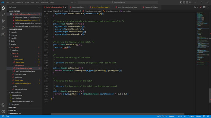

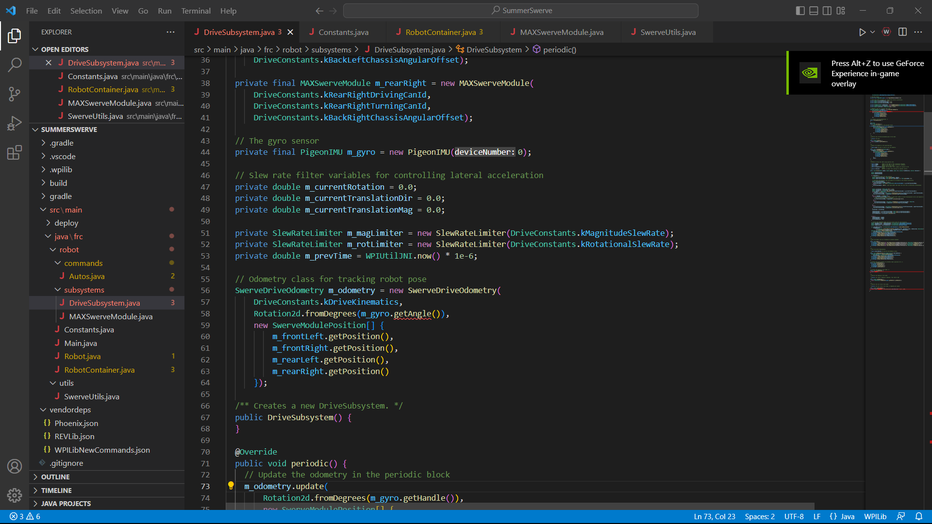

I have been trying to get my first try at code for the REV Maxswerve Drive Train we have going, but we are using a PigeonIMU for out gyro and I don’t think I exactly know what kind of commands to use as compared to the example code out there for the REV MAXSwerve. Any more experienced programmers able to help?
It appears that you’re attempting to use the navX methods on the PigeonIMU. The Pigeon uses different naming for the same functions, so you’ll have to change them. I don’t remember the exact naming and the Pigeon’s documentation isn’t great, so I would recommend using VSCode’s features to help you out. If you type out m_gyro. then press control + space, a list of suggestions should appear. (For modifying your current code, you can delete the red underlined words and control + space there). The method names should be fairly self explanatory, but if they aren’t there should also be descriptions of what each method does.
I did that for most of them, I just can’t find the equivalent of getRate() for the PigeonIMU
Try using WPI_PigeonIMU it implements getRate. It also implemnts the other missing methods reset and getAngle

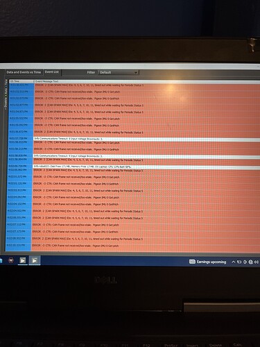

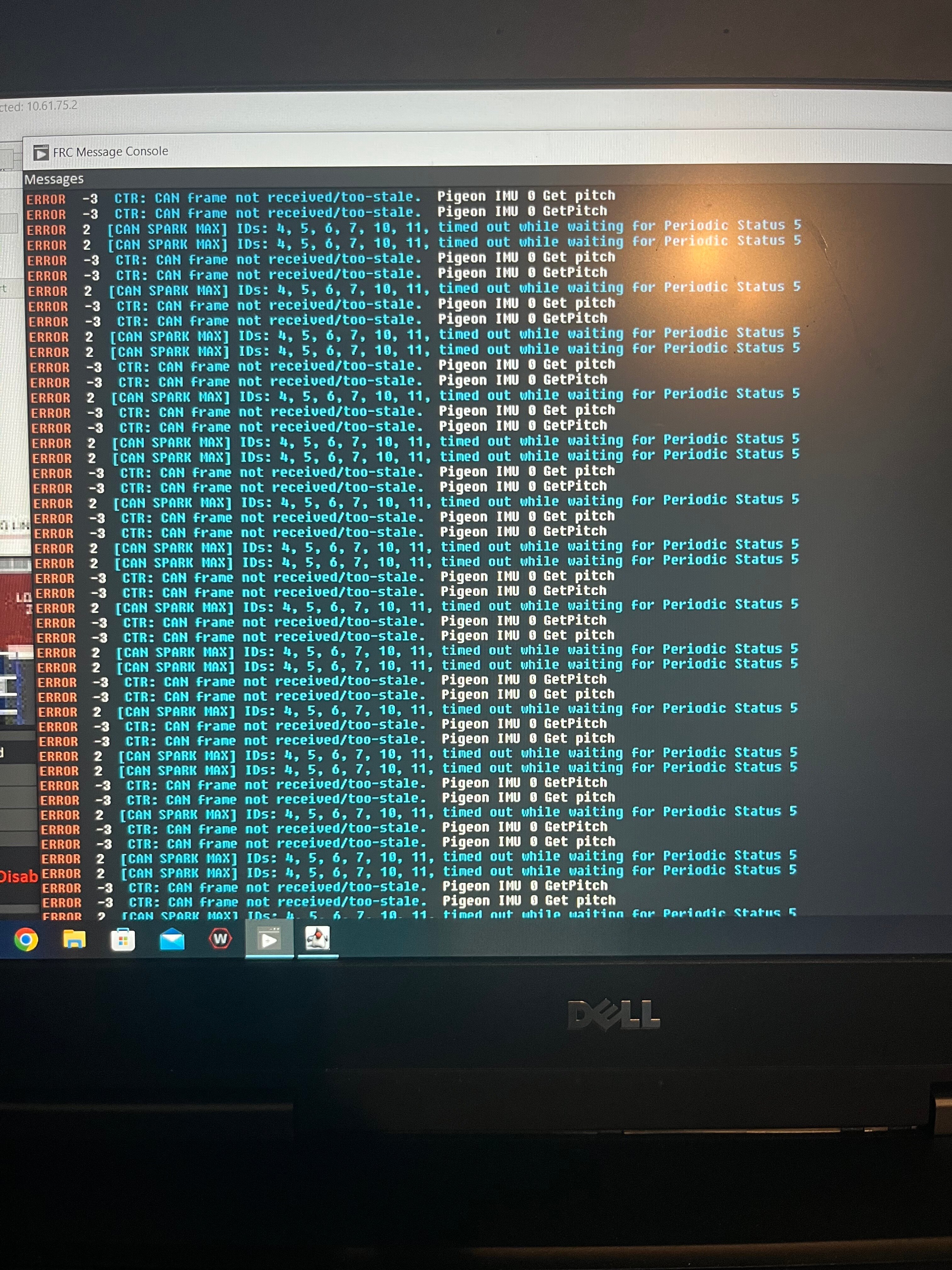

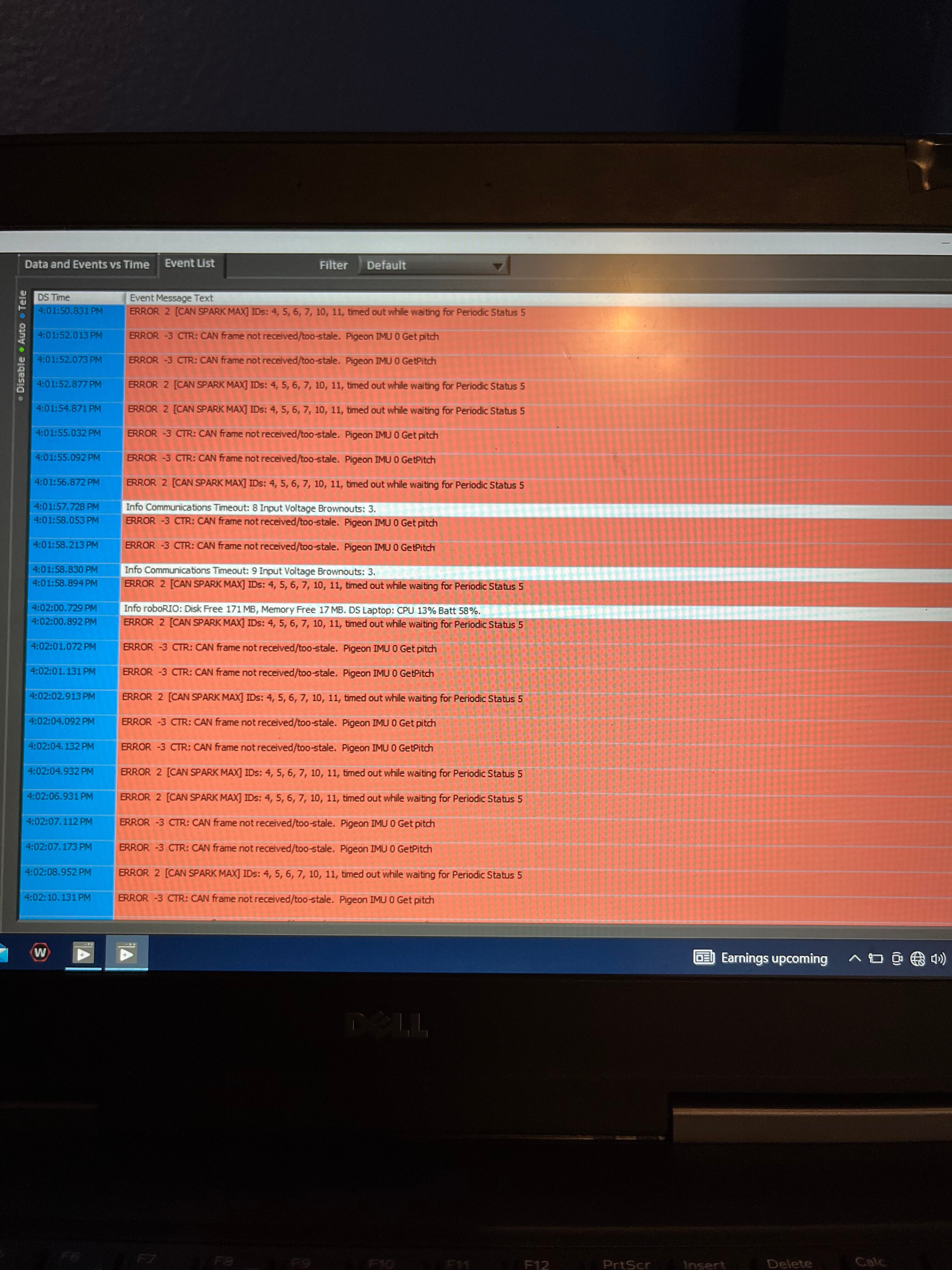

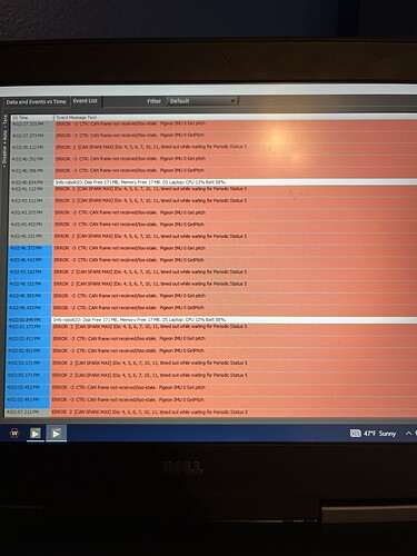

Hi everyone, I took some time away from robotics for a second, but I am back and have fixed my previous issue of a single wheel not rotating, it was a bad absolute encoder. However, I still have an issue where the robot seems to randomly shoot off in a direction and keep trying to go in that direction once it has started this “cycle”. This is the errors I get on my driver station console. Anyone know what this could be, im unsure if it’s code related or can related
I think it may be a CAN issue but would just love some insight from someone with more experience in this area

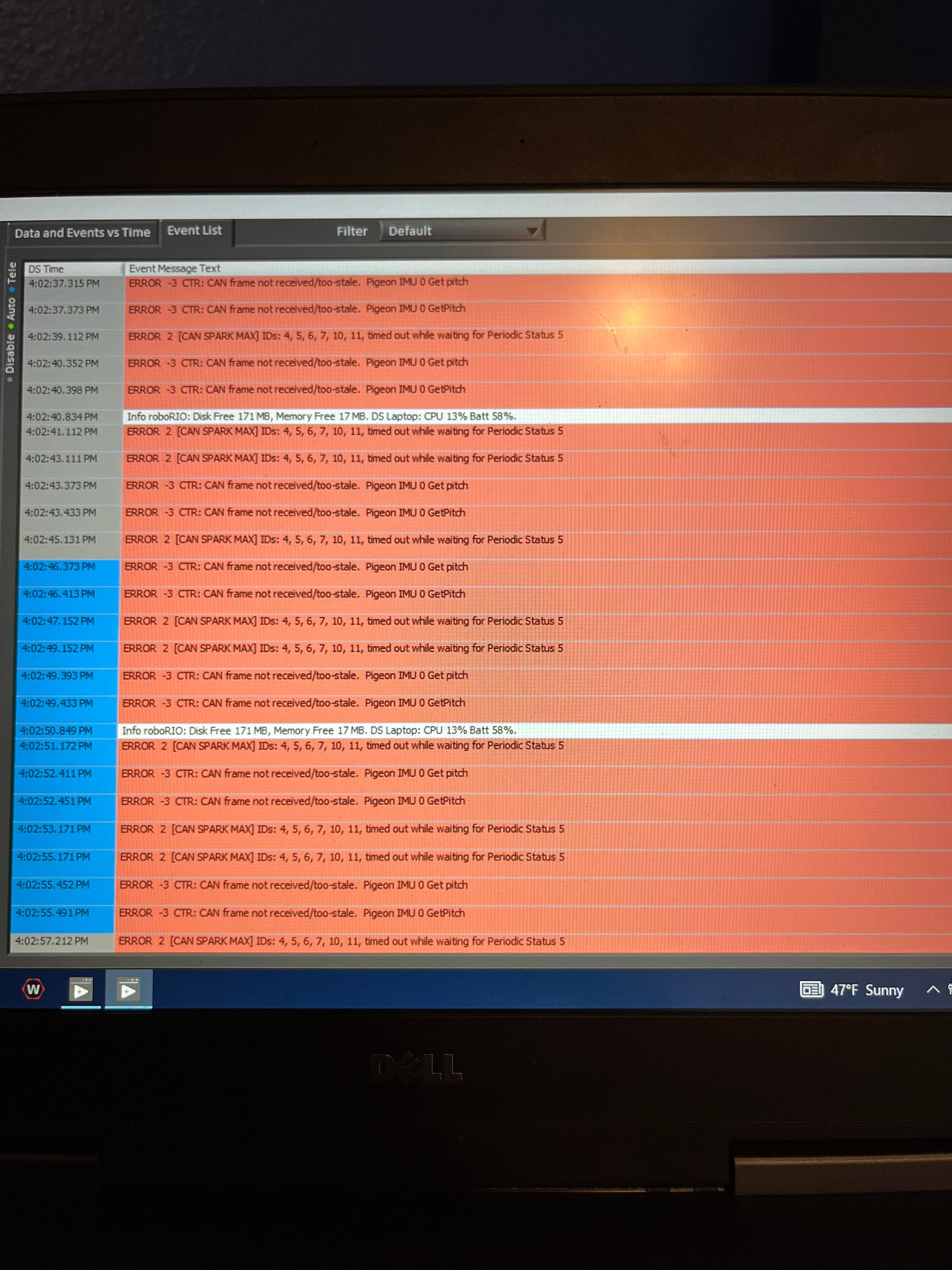

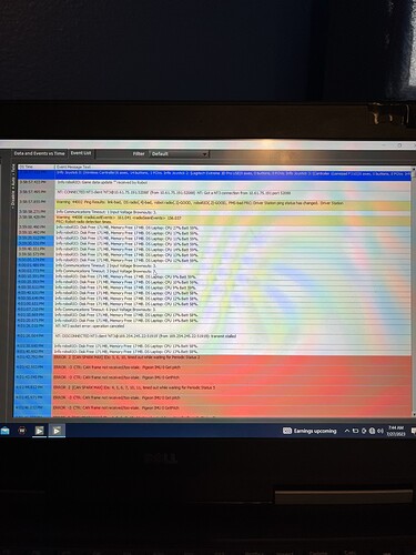

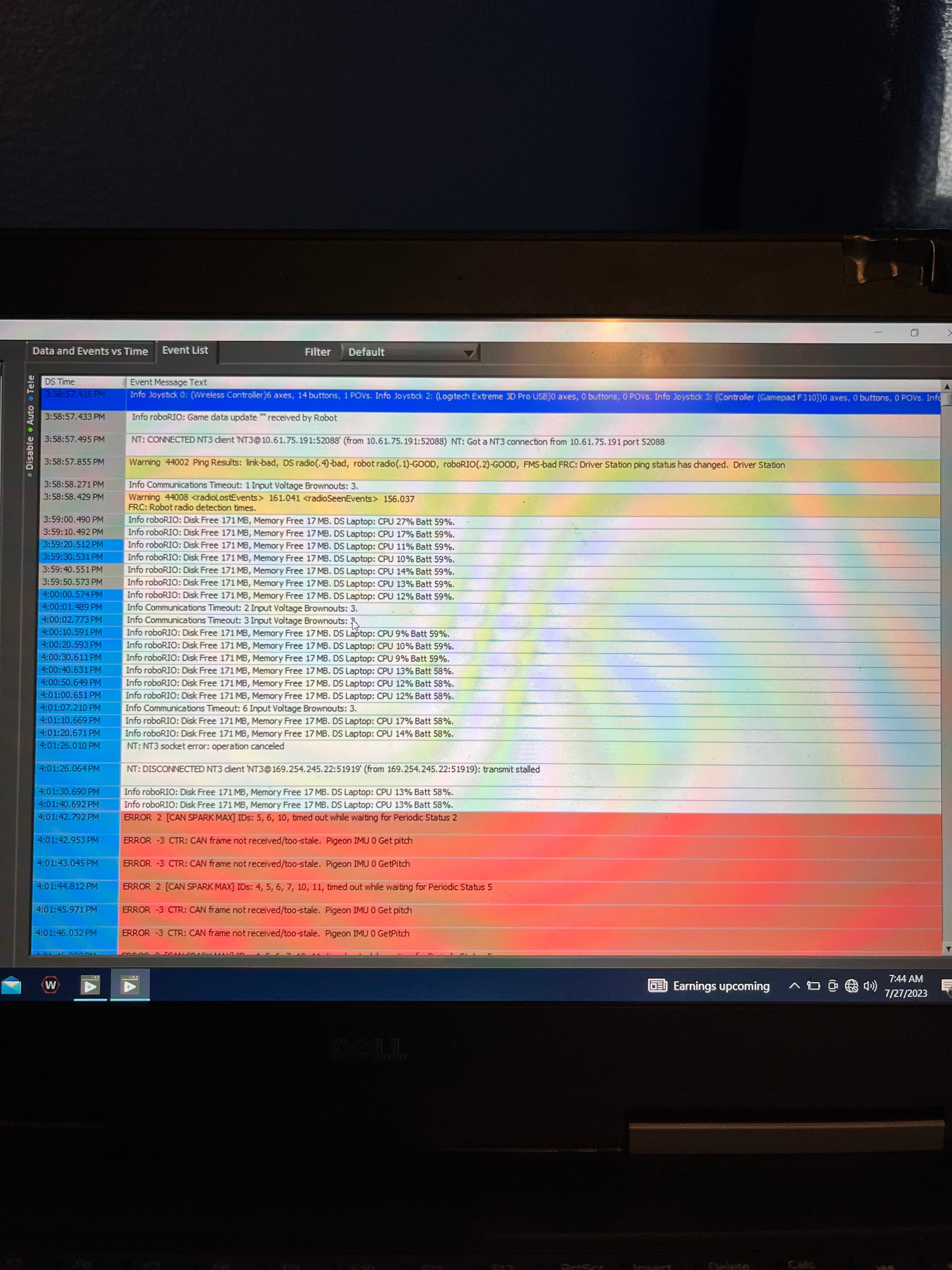

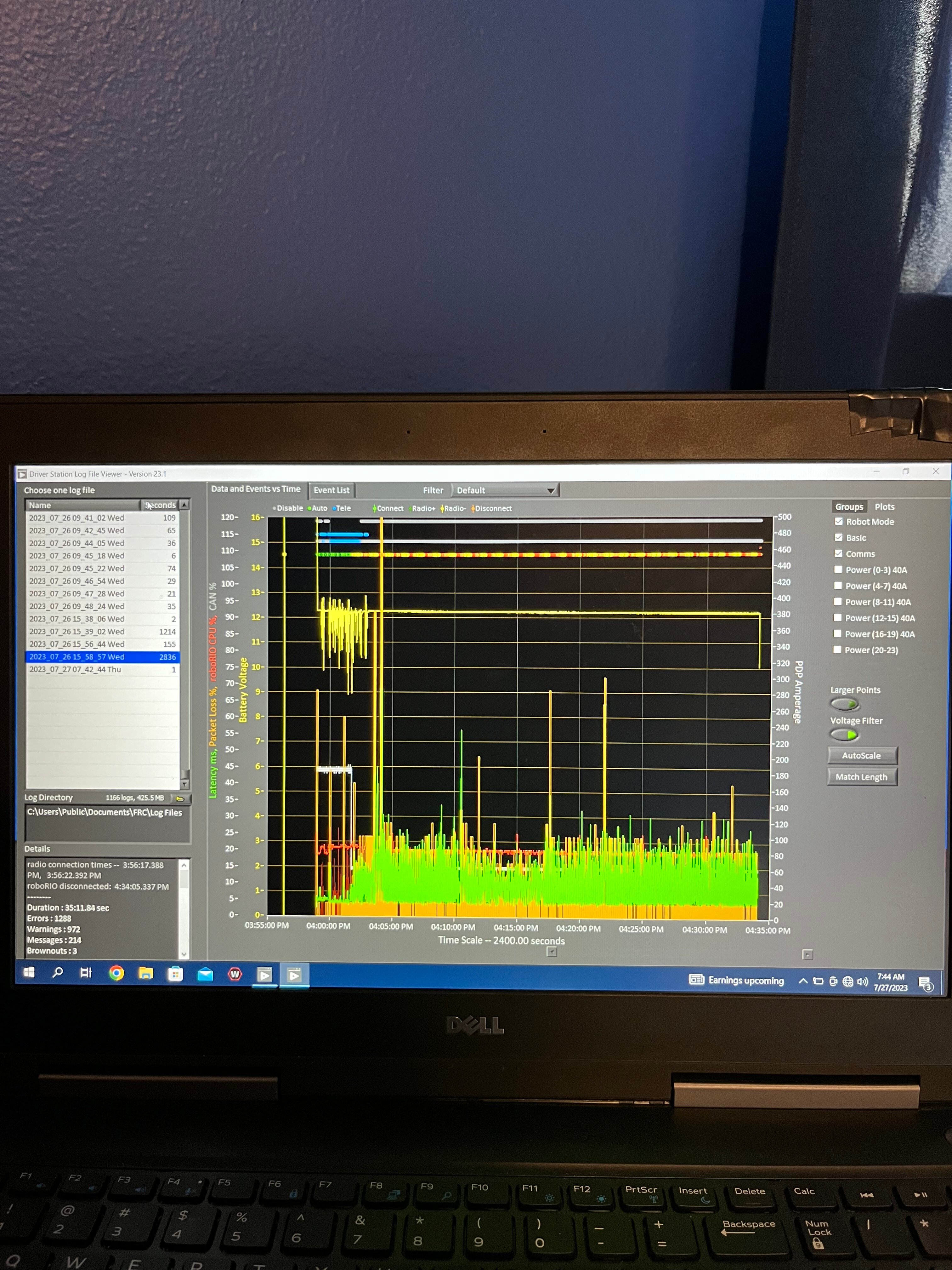

Have you checked your DS logs? If you want to share them here, remember to include both files (.dslog and .dsevents).
Is this what you are looking for?
It looks to me like you have a problem with your CAN bus wiring. I would trace the wiring from the roboRIO, comparing each device to the ones reporting problems (SparkMAX 4,5,6,7,10,11 and Pigeon). Hopefully you will get to a point where you have passed the ones not having problems, and the remainder are the ones with problems. That section should be where there is a connection issue. (I’m assuming you’re using the recommended simple CAN bus topology here.)
I’m not sure this explains everything you’re reporting, but I think it’s what you should fix first.
How long is your CAN bus? What type of connector are you using? Feel free to post pictures of your CAN bus wiring.
Another trick is to disconnect both ends of the CAN bus, connect a ohmmeter or continuity meter across one colour end-to-end, and then wiggle all of your wiring, noting the effect it has on the resistance/continuity. Repeat for the other colour.
