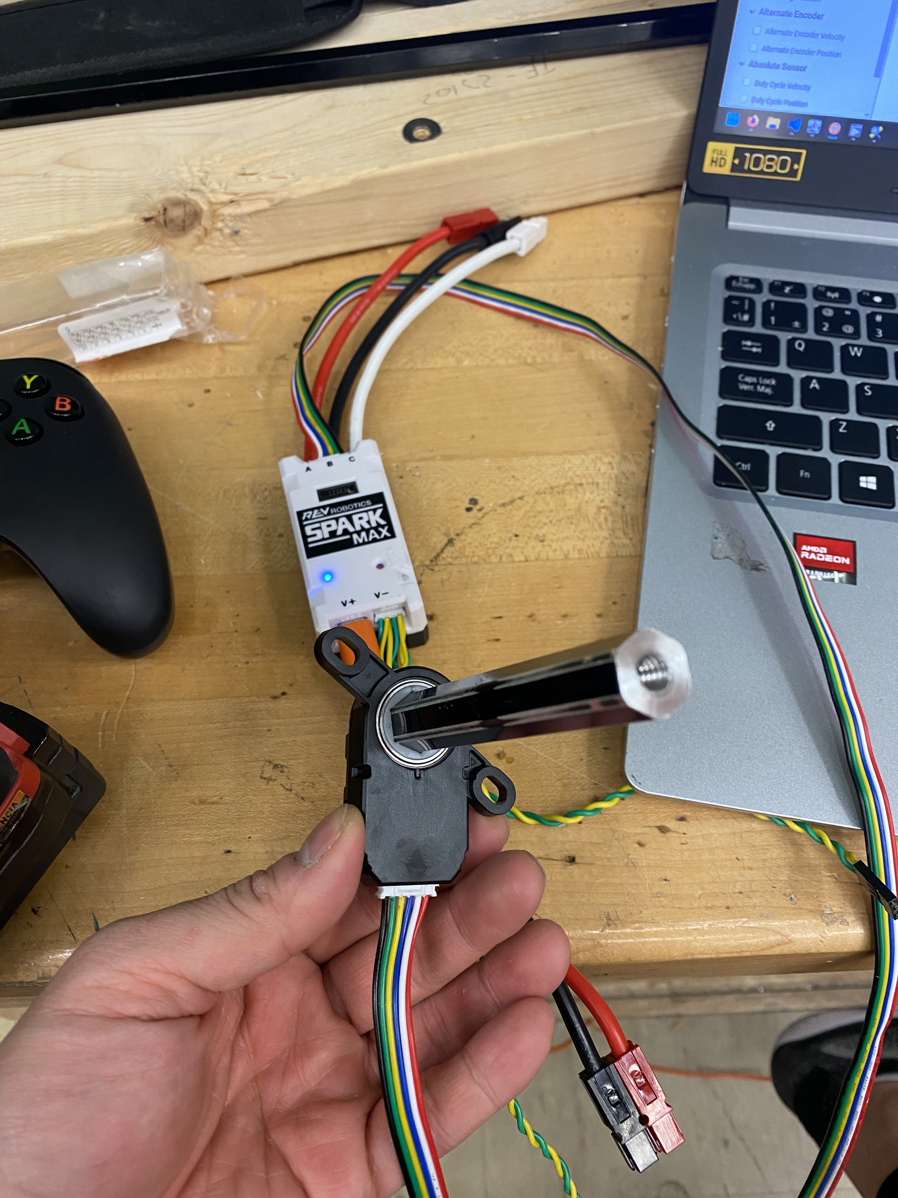

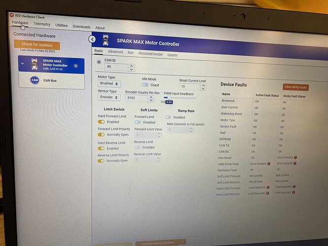

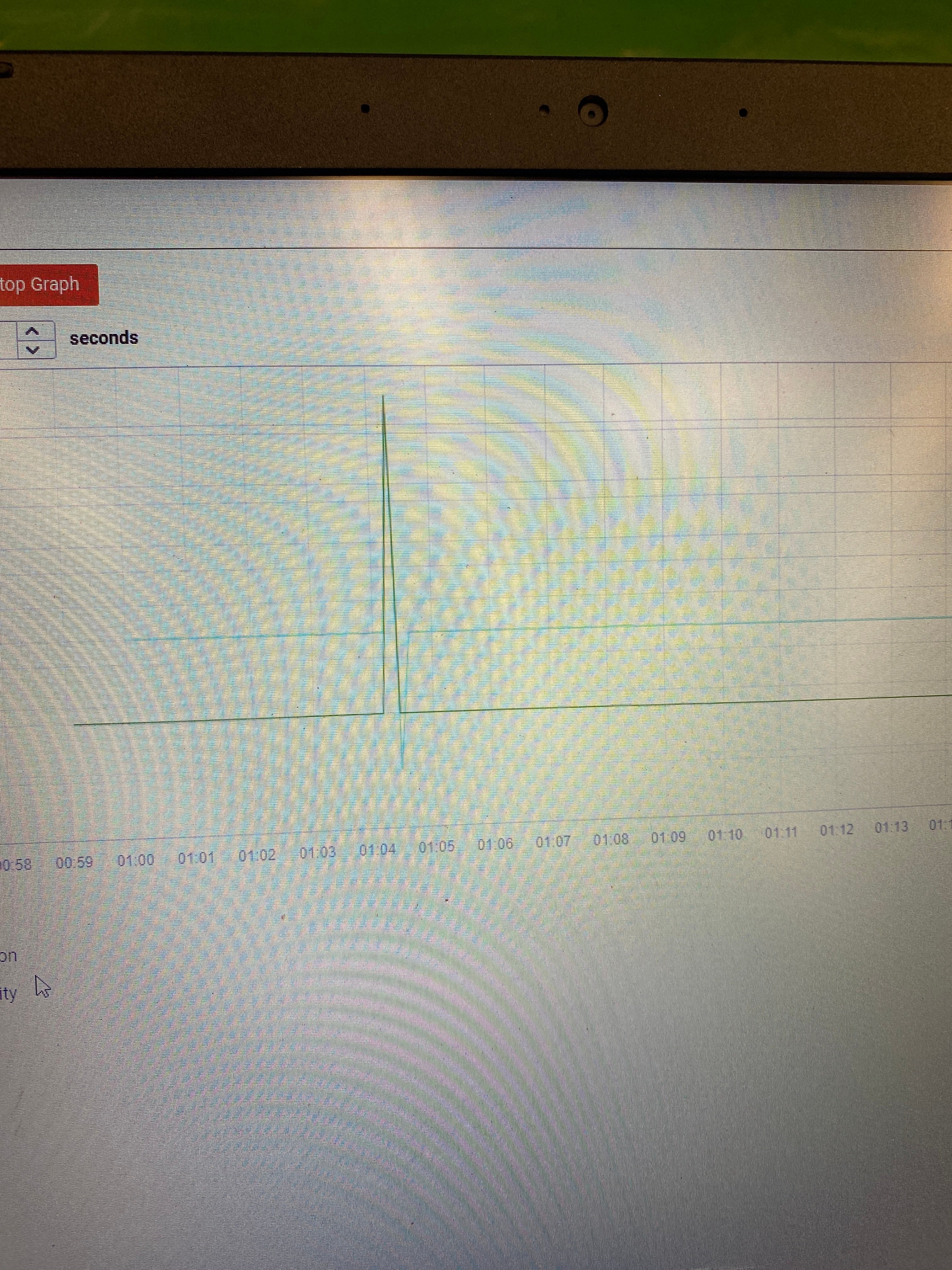

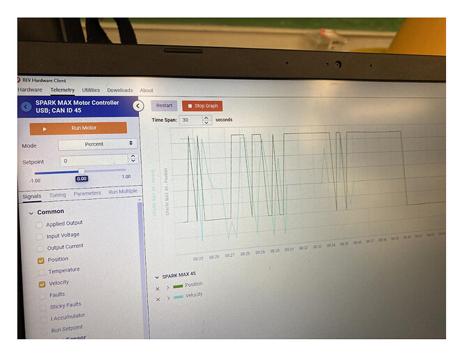

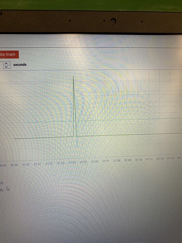

Trying to use the rev through bore encoder. Have it connected to laptop. We get these weird spikes on first rotations. Not really sure how to recreate this scenario consistently. Any ideas? Have tried with multiple spark max’s and a second through bore encoder. Same results. Thanks.
The single spike looks like the index signal.
