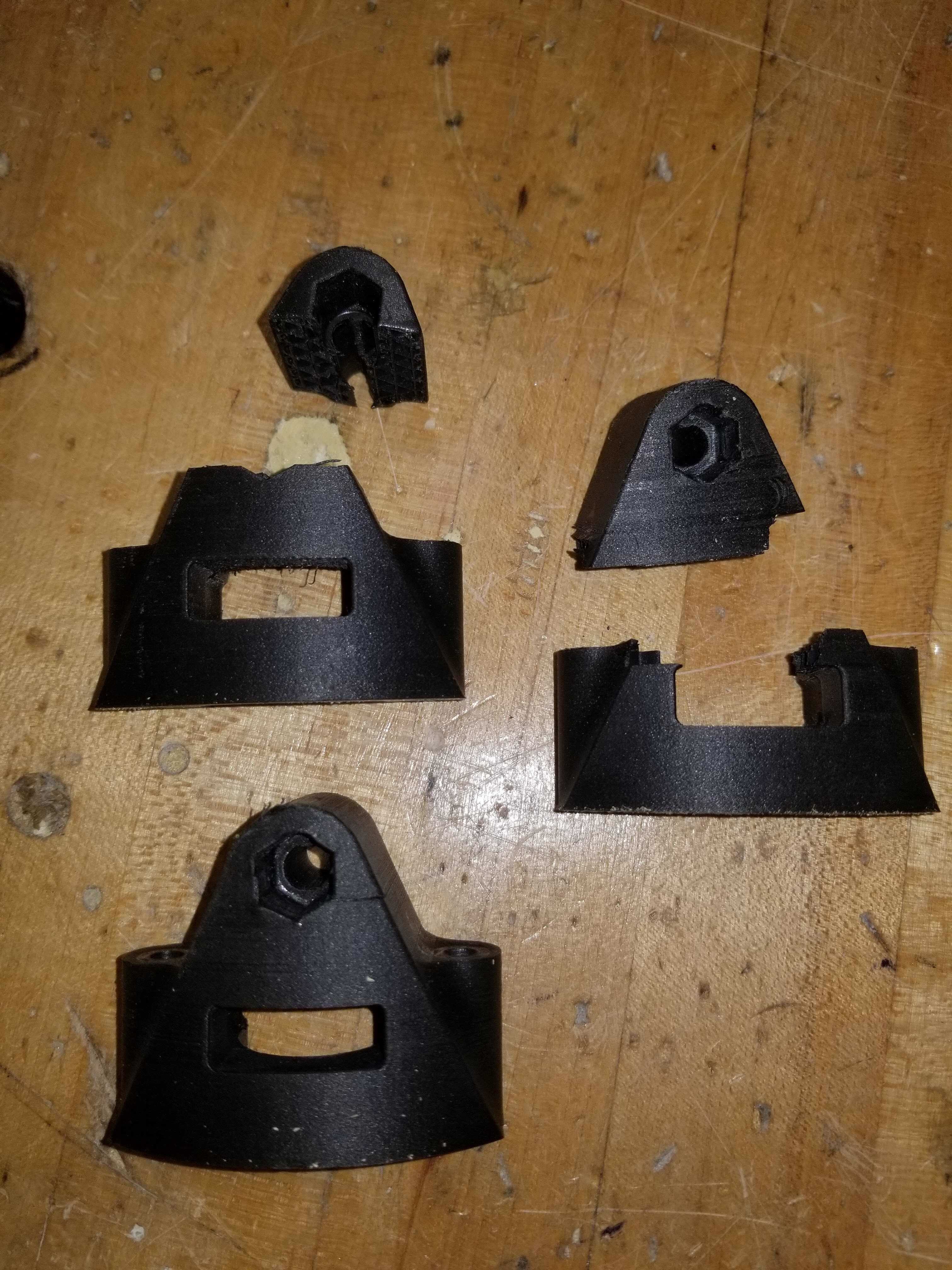

The forks on our 2020 robot were SLS Nylon because the original design was 55% infill Markforged Onyx and they snapped pretty quickly in our initial testing over the metal bump. Rather than playing around with optimizing the fork in week 3 of build we decided to just beef it up as much as we could to not have any worries about drivetrain functionality. Needless to say I wouldn’t run a PLA or PETG fork, but you could probably add guarding or change the slicer settings for the print to make Nylon, NylonG, NylonX, or Onyx work for the 2020 field just make sure you thoroughly test them before competing!

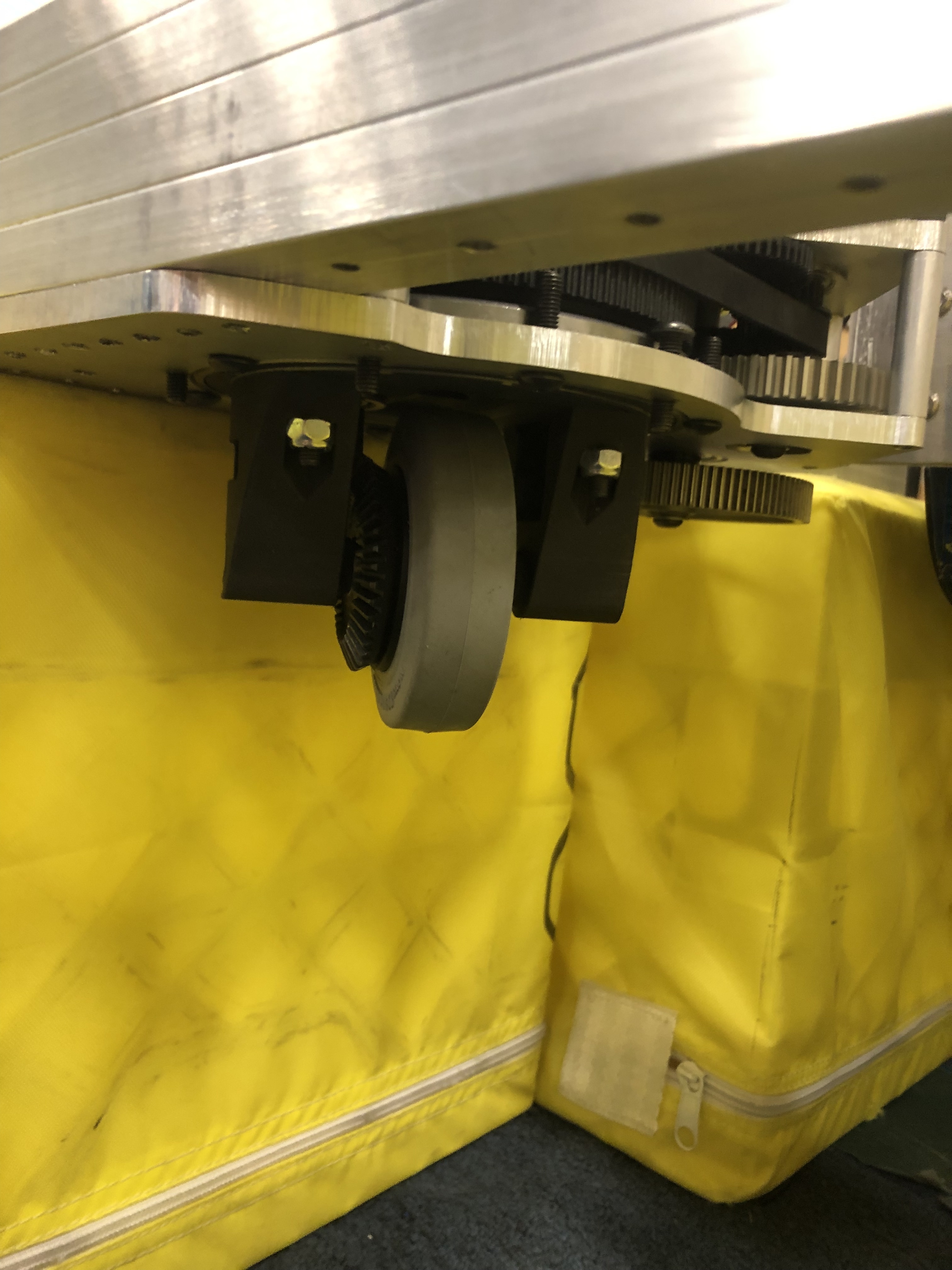

Our 2020 4" wheel forks are PETG. They have no problems taking the barriers full speed and have not failed. They are beefy. Also, we use 2 3" 10-32 socket flat head screws that are fully threaded into the fork. This reinforces the fork and pins the layers together. With out the 2 bolts our module would have problems.
Do you have pics of what the fork looked like that broke?

I believe some of the students have pictures of the forks before and after failure that I will try and dig up. For now it was a version of this which was adapted to accept a 4in andymark wheel instead of the custom 3in one that is shown.
As another reference we ran the below set up at Kettering Kick Off 2019 and didn’t have any issues at a competition. When we got back from the competition we found a stress fracture in one fork which probably was from over tightening the bolts that ran through them. This eventually became a problem when we were doing drivers practice and resulted in the break shown below.
In an effort to increase the strength of the forks we joined the two side forks into the one you see in the picture at the beginning of the post. This did help, just not with ramming the steel bar at 13ft/s. In all fairness we did not have any performance problems with any of the fork revisions on the 2019 field until we cause the stress fracture.
That is exactly the failure I would expect to see. On the wheel forks extend the sides straight down at least .5" below the wheel bolt. Do not use a nut. Use a socket head screw long enough to extend all the way through the fork. Make this a 10-32 tap hole. May have to drill out for exact hole dimension. Tape this from the top down as far as possible with a hand tap. Go slow and clean the cuttings often. A normal hand tap most likely is not long enough. Use a screw to melt tap the rest of the way. Go in out in out quickly. This will melt tap the hole. Excess plastic will be pushed down and out. This is what we did and our PETG forks just take terrible abuse. The bolt does 2 things. Stiffens the whole fork and the threads act as a layer pin to bind the print layers. Also, higher print temp may increase the layer bonding. This may increase the warping problem. Not familiar with temps and setting on markforge printers.

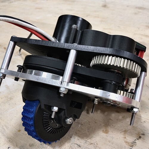

Here is a swerve I designed to be fully 3d printed a couple of years ago:
https://www.chiefdelphi.com/t/pic-fully-3d-printable-swerve-drive/166062
It’s a little out of date (from the pre-brushless era), but I think it would hold up if printed from nylon or pc.

Edit: Also we made a version of this design with a little more metal and used it in 2019:
https://www.chiefdelphi.com/t/2019-swerve-module-cad-2471/356818
