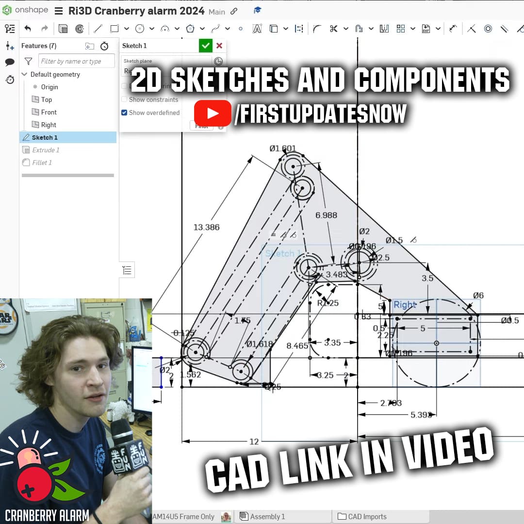

https://youtu.be/4KUqL5vUArc Reis provides an overview of Ri3D Cranberry Alarm’s current 2D sketches and components.
Onshape link: Onshape
2dsketchesshow-promos

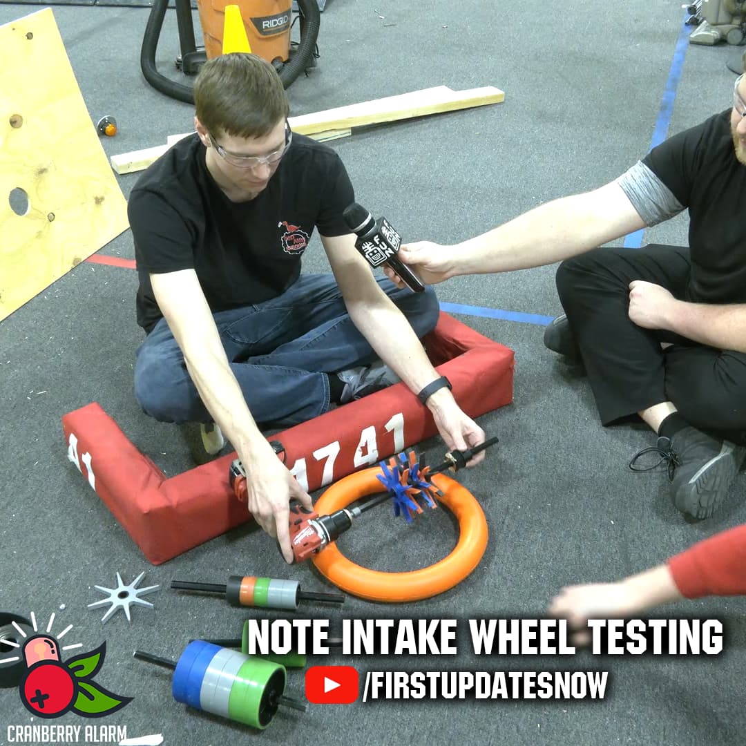

https://youtu.be/alnb3Y16P94 Cory from Ri3D Cranberry Alarm provides an overview of testing multiple AndyMark intake wheels and interactions with the CRESCENDO Note game pieces.
noteintaketeStshow-promos

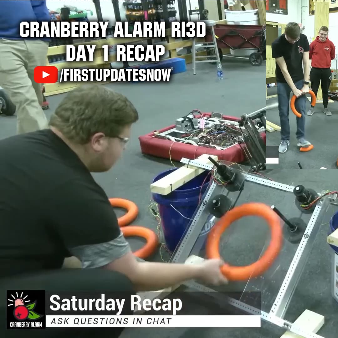

Ri3D Day 1 Recap is about to start and they have a TON done already! Go to https://youtube.com/firstupdatesnow/live to watch, ask questions and also get a chance to win giveaways from AndyMark and The Thrifty Bot
https://youtu.be/0al1GPPaLIs Cranberry Alarm Ri3D team provides a full overview, recap and answers questions from the live audience on their current progress. Watch us destroy a Note (ring), demonstrate their shooter and intake prototypes and detail their drive.
ri3dday1recapshow-promos
If you have a chance, it would be cool to see how the NOTE performs with having shooting wheels on both sides(no spin) vs having shooting wheels just on one side(lots of spin) or even a combination with two sides but one is going faster than the other.
The first thing I thought of when I saw the NOTES was 2013’s frisbees, and I was wondering how close they perform to the frisbees in terms of spin making them more stable in the air.

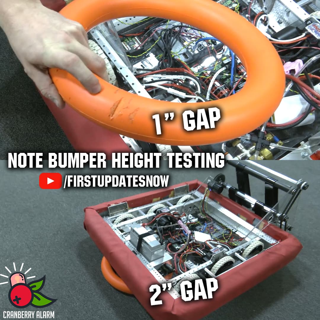

https://youtu.be/IdYKodhMz1A Reis from Cranberry Alarm Ri3D demonstrates Note game piece interactions with the AM14U5 Chassis and 1" and 2" bumper heights. 1" had promising results but did damage the Note while the 2" bumper height resulted in stuck Note pieces.
notegaptestingshow-promos
