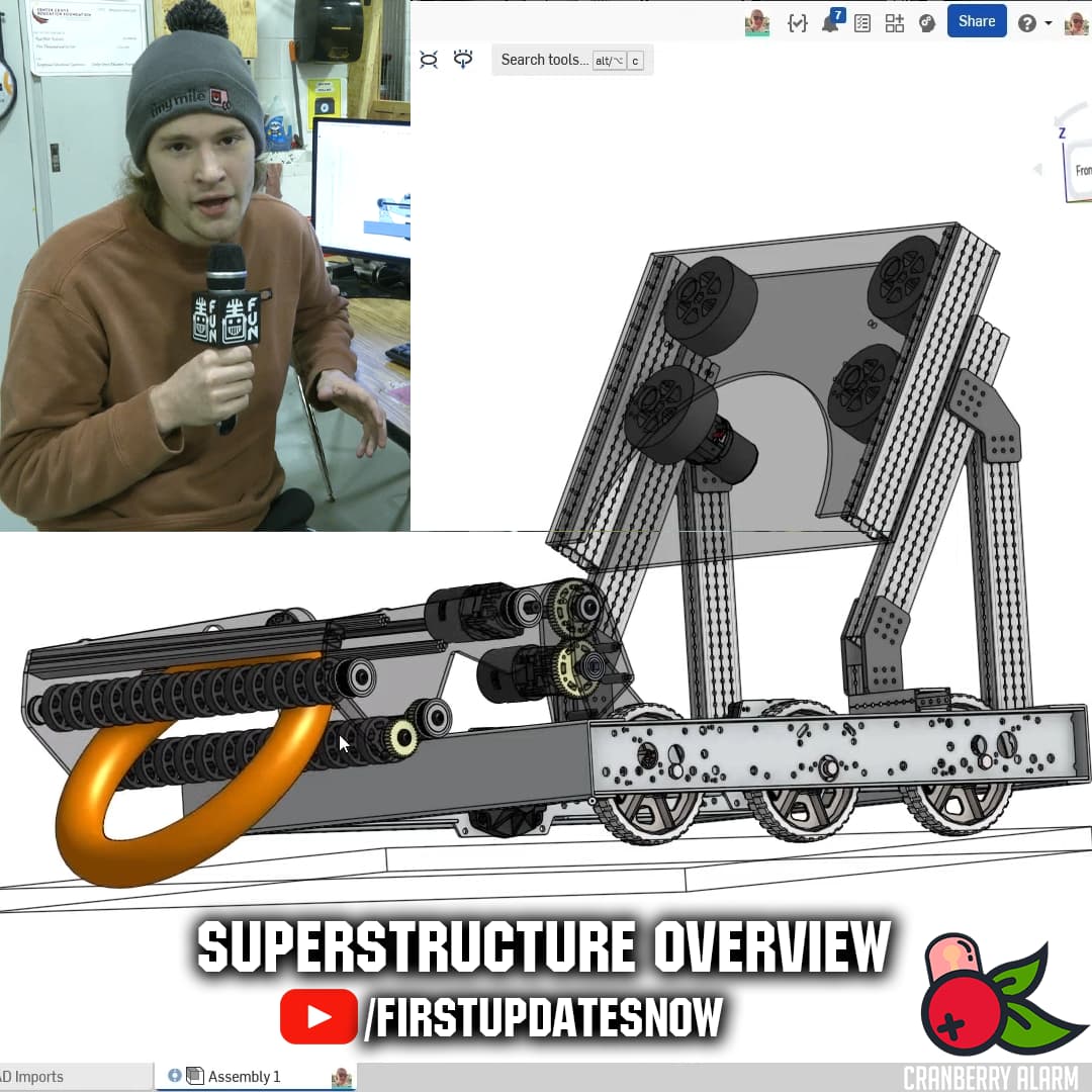

https://youtu.be/4jYB1v5bPFc Reis provides an in-depth overview of the Ri3D Cranberry Alarm Superstructure in Onshape going over their current mechanisms and future plans to come.
View CAD on Onshape: Onshape

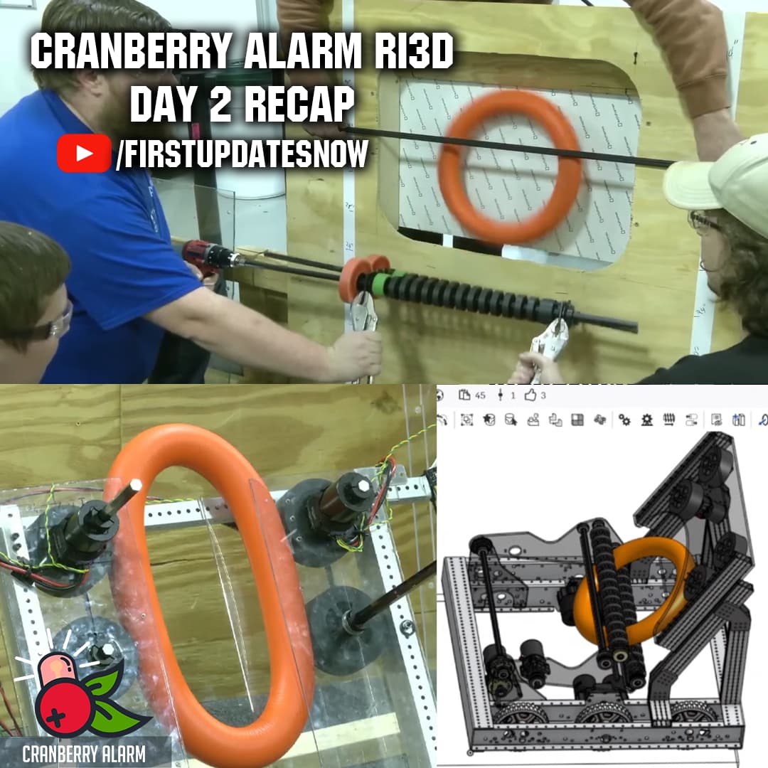

https://youtu.be/FxU_oQGLAe0 Cranberry Alarm Ri3D team provides a full overview, recap and answers questions from the live audience on their current progress in their Day 2 Recap. You got to check out the progress on the Amp, speaker shooter and what’s to come tomorrow in their CAD overview.

I’ve loved watching the stream, great job! What have been your experiences with shooter compression so far? Your current CAD model shows 5" of compression, which is huge for, so I’d love to hear more about what you’ve tried and how you’ve settled on what you have right now.
Hey @Andrew_L, glad you’ve been enjoying the stream so far!
As far as the Note compression, the CAD model is up-to-date; 5" of compression is what we’re going with for our final design. With the prototype shooter we made, we intentionally made it very easy to vary the compression distance, as we thought this would potentially have a huge impact on shooting.
We started off with 1" of compression, which worked alright, but we wanted better, so we incrementally increased compression by 1" at a time. Each time we did, the shot got better and better, but there was diminishing returns. The change between 4" and 5" was noticeable, but we decided to stop with that, as it seemed like we were getting closer and closer to actually damaging the Note.
You may be able to compress it more, but it seems like around 5" is likely the sweet spot.

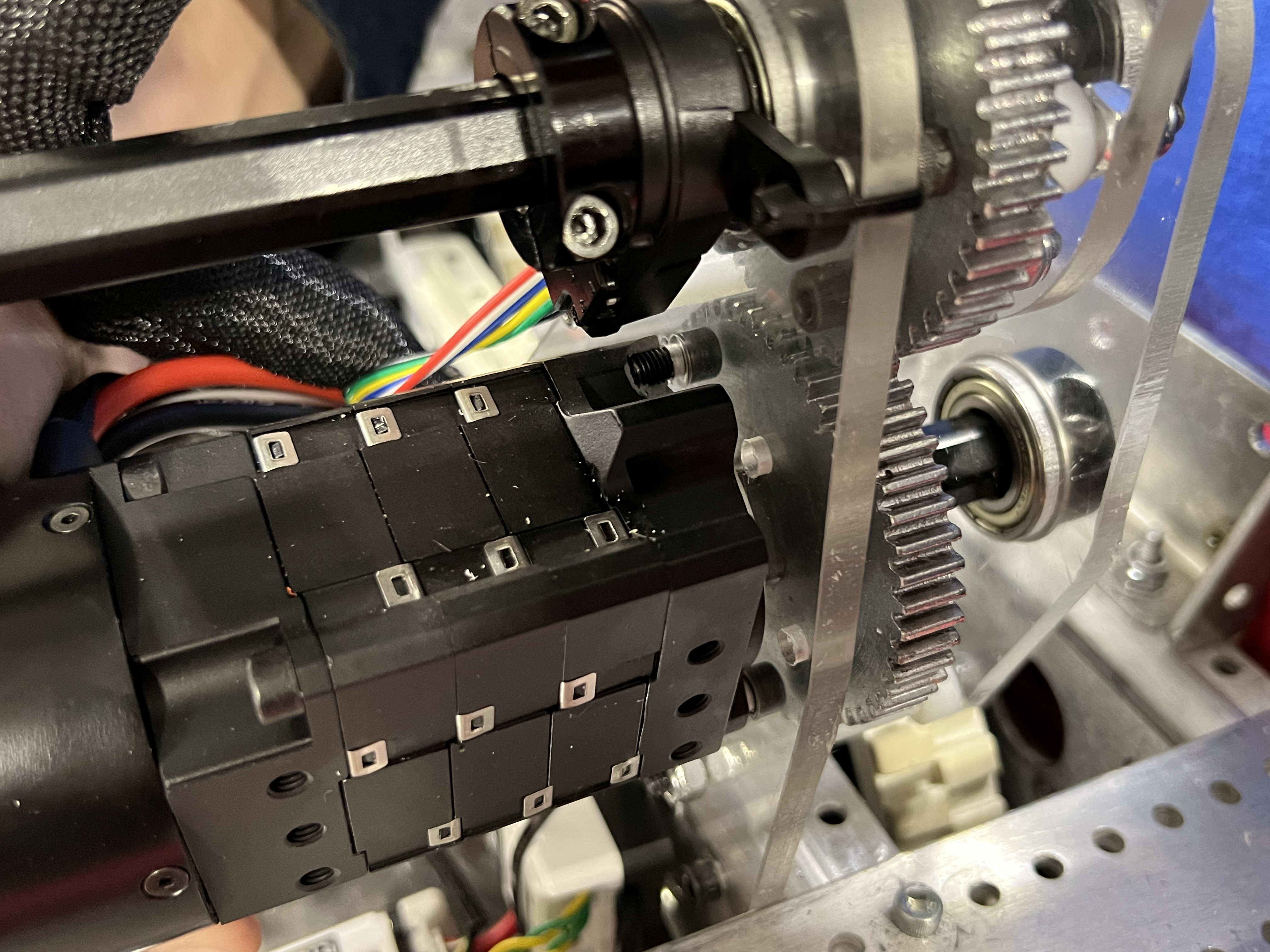

First intake pivot testing went… shattering. Motor went the wrong way. The only thing that broke was the max planetary mounting plate. RIP to that mounting hole.

We have a box full of MP plates that look like that! A quick solution (other than NOT over shock loading it) is to use all 4 mounting holes.
FYI, the next level solution is to mill a shallow pocket the shape of the mount into the plate, to spread the shock torque load evenly.

I’m wondering if a full size Neo for the pivot motor is not overkill. Did you consider using the smaller Neo 550?

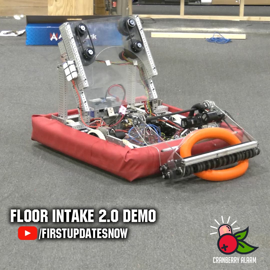

https://youtu.be/j8k97lN1e6U Reis from Ri3D Cranberry Alarm provide an overview and demo of their floor intake 2.0 utilizing Rev motors, The Thrifty Bot Squish wheels and AndyMark churro including potential issues teams may need to accommodate for when designing their Crescendo robot.
floor2show-promos
