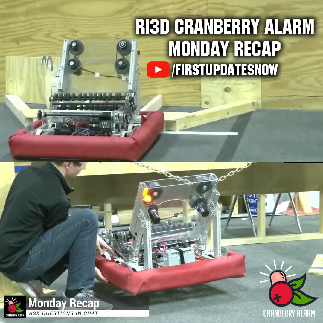

Ri3D Cranberry Alarm Monday Recap is at 9pm eastern with giveaways from The Thrifty Bot and AndyMark at https://youtube.com/firstupdatesnow Ask questions and check out the awesome progress. We’ll be doing full cycles tonight! Sneak peak:

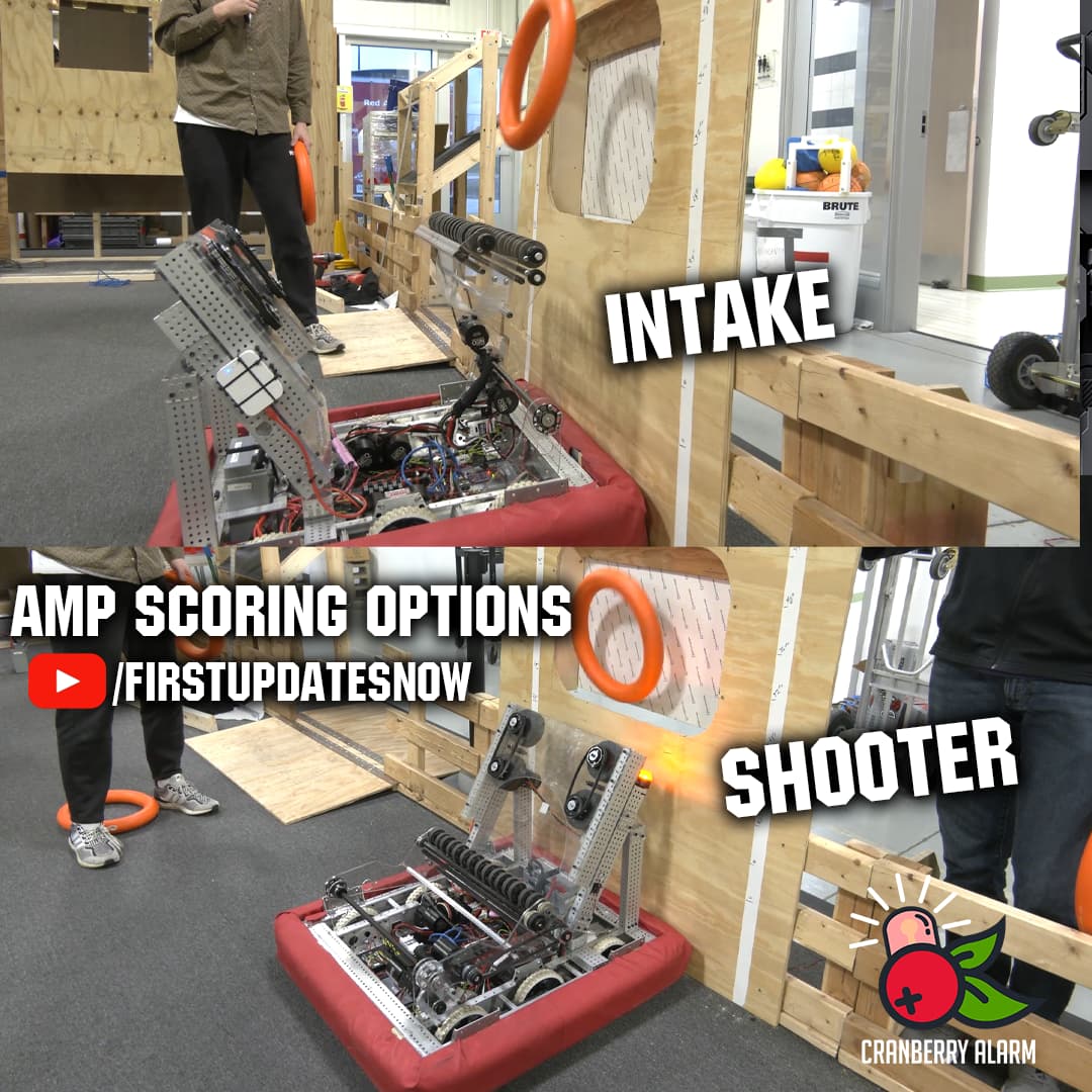

https://youtu.be/aApYUn27NEI Reis demonstrates how the Ri3D Cranberry Alarm team is considering scoring Amp cycles with their intake and their shooter including different positions and with a Note impeding the Crescendo robot.

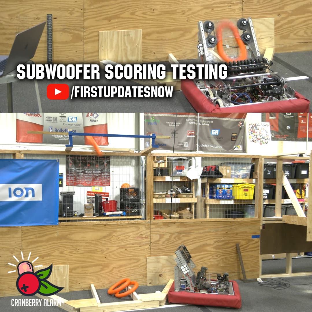

https://youtu.be/suJ7skaES_4 Cory overviews testing Cranberry Alarm’s Ri3D of scoring Notes from different positions on the Subwoofer. With a low robot there are a few effective options and some that may not work for teams.
subwoofertestingshow-promos
Ri3D Monday Recap is about to start! We’re going to have a ton of live demos tonight including amp and subwoofer scoring and floor intake. Also giveaways from The Thrifty Bot pair of 45A Solid Black Urethane Wheels (same ones on the shooter) and a $25 Gift Card to AndyMark ! https://youtube.com/firstupdatesnow/live
https://youtu.be/Kh4731DfGNc Ri3D Cranberry Alarm showcases their progress on Monday of Robot in 3 Days with a reveal taking place Tuesday! Check out their awesome progress on their floor intake, scoring demonstrations on the speaker and amp and also their next steps for their climber!
ri3dmondayshow-promos
I dont know if it’s been tested prior-
When attempting the amp using intake:
Flip the intake a little bit to provide a “throw” while running the wheels to launch?
I only saw a fixed position on intake, and wheels at different speeds.

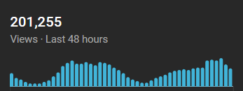

Just want to give a big thank you. FUN’s YT in the last 48 hours has over 200,000 views on content and Ri3D is by far the largest chunk of that.

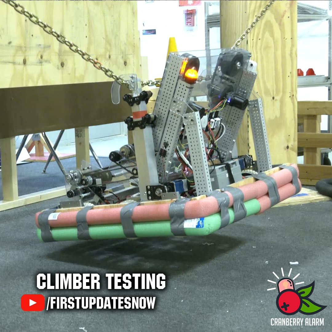

https://youtu.be/xP1urgzdt24 Reis and Cory from Ri3D Cranberry Alarm test and demo their 2 stage TTB climbers on their Crescendo Robot. You’ll get to see the climber from a few positions on the chain, how the controls work and a demo of the robot in action from both sides of the robot!

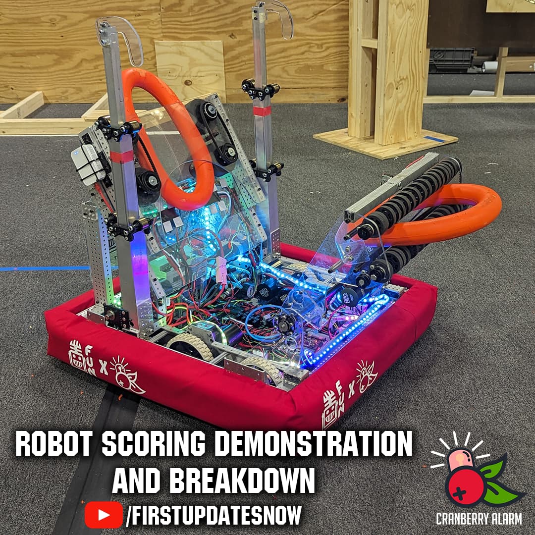

Ri3D Cranberry Alarm build is complete! Join us for the Robot demonstration with Q&A at https://youtube.com/firstupdatesnow/live We have another set of 45A TTB wheels and an AndyMark T-shirt to giveaway on air!

That’s a wrap with Cranberry Alarm Ri3D!
If you didn’t get to watch the Robot Scoring Demonstrations and Breakdown video you can find it at https://youtu.be/Xy6v-fVt3wM
We’ll make a produced ‘Reveal’ type video to come out probably Thursday too but the video above is really going to provide a much more in-depth and educational overview of the robot vs. a reveal video.
