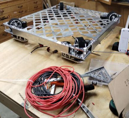

Leveraging a few rules that were tweaked in 2022 and 2023, we went ahead to pre-assemble many different COTS components. This included a full SDS Mk4i swerve drive base.
Not yet pictured: some electrical work to get most of the standard components mounted and connected.
Caveat: This is only legal if used as a practice robot drive base, and isn’t taken to competition. However, the time spent to assemble modules was… not much. Four people got all four done in about 2 hours. The drive base was cut and assembled about an hour later.

These modules were phenomenally easy to put together. It’s honestly easier and more consistent than the kitbots I’ve worked on. Kudo’s to SDS on this one - what impressed me the most was that there was … almost … no way to make a mistake during assembly. If two parts weren’t supposed to go together, they didn’t fit together. If you had parts left over, you knew you did something wrong (guilty, 1x).
Honestly. It blows my mind that the same product that simultaneously won and lost Einstein this year is so accessible to even the teams who wouldn’t consider themselves great at doing mechanical things. My bar of “good mechanical design” has been set to new heights.

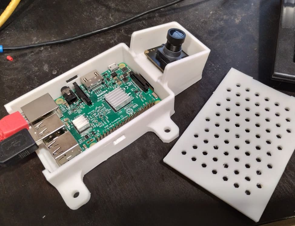

With the AprilTag fiducial targets on the field this year, we’re not yet certain what the “best way” to process or use them will be. However, we are doing some work in conjunction with the PhotonVision team to trail a few solutions. Most will be raspberry-pi based, and involve a few different cameras and mounting solutions.
Latest CAD for that case.
Caveat: doing the 3d printing before kickoff isn’t acceptable per the 2022 rules. However, “watching a 3d printer for 3 days” makes for a boring livestream.
Again, we really don’t know what this will be used for, if anything. But the goal is to have prep work and tools at our fingertips, so that if it’s useful and we can demo it for teams, we’ll be able to do it effectively.

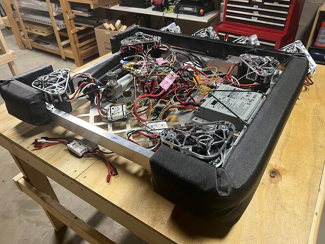

Here’s the practice chassis wired and with bumpers. Could be cleaner, but most of us were pretty occupied over the holiday break with both prepping other parts of the Ri3D project and other projects, so we opted for functional but quick to put together.
As noted above, we have no idea what the game is, but as a lot of games have mostly flat floors, having a chassis ready to go is great for parallel pathing the programming tasks and having a base to attach intakes for testing. We may need to take it apart if the game requires it.
We left two sides with full bumpers and two sides with cutouts so we can test a number of different intake styles quickly.
