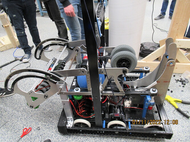

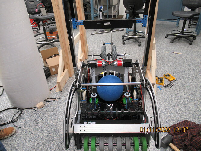

Can you provide more information about this shooter? What diameter are the wheels, what RPM is it spinning at? And can you shoot without the blocker? I am interested in seeing if it will shoot high enough to get into the high goal.
the wheels are 8" pneumatic wheels with the tube removed, and it does shoot with a fair amount of power the blocker was there to prevent damage to the lights in our workspace. tomorrow morning we will be back and we can try to measure rpm then

Hermes, our completed robot

I noticed you choose to sandwich the ball between two sets of belts for feeding into your shooter. Was this purely a practical choice, or was there a reason to use force on two sides of the balls as opposed to just one?
2 belts puts the ball under a slight compression which we found to really help with transport. with only one belt and no compression we would be relying exclusively on the “grab” of the belt. With compression, the forces normal to the belt are stronger, giving higher friction forces.
Also, by applying force on both sides, the ball does not rotate as much and is easier to align with the shooting mechanism.

Looks like they never got it to work without help. From their whitepaper -
We were able to consistently climb the mid rung with the mechanism and it performed as expected, however the high rung climb was elusive in practice due to swinging motion of the robot. We were able to climb the high rung when the robot was stabilized by team members preventing chaotic swinging, though this is obviously not a valid competition strategy.
