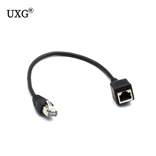

We had been using these 3D-printed compliant push-on holders over the years but we plan to not use them this coming build season as it’s clear that they shake too much which messes with encoder readings. If you have a navx or any one of those gyros that mount onto the Rio itself, I would strongly suggest using double-sided VHB tape and mounting it preferably on your belly pan or some other rigid material. There is really no reason for using Velcrom or other methods that allow the Rio to be taken out easily. If you need to take it out to plug in an ethernet cable you should suggest using a male-to-female cable.

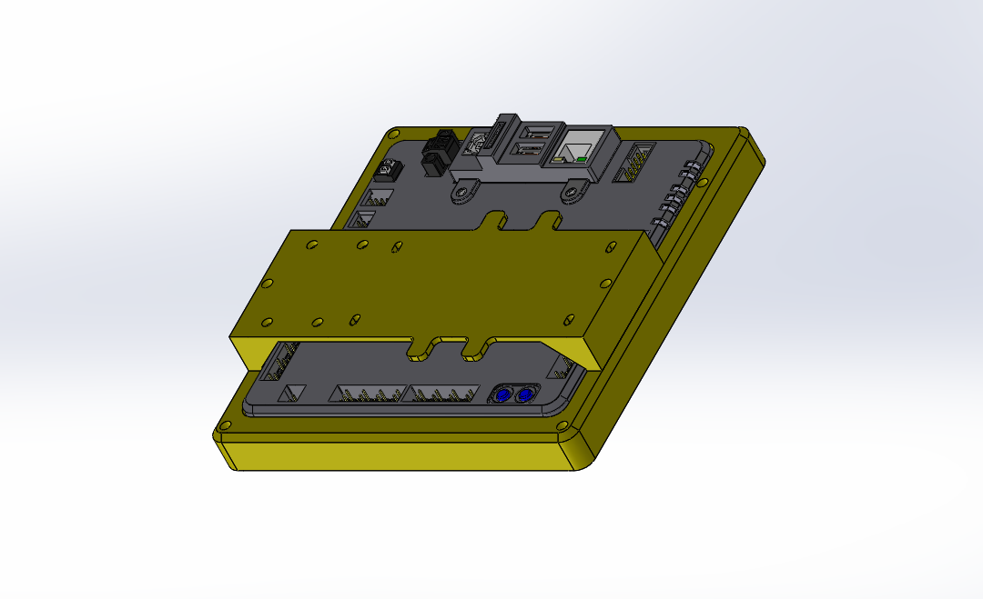

The mid-season solution was to 3D print a “collar” to retain the RIO laterally and a bridge to clamp it down to the bellypan. The collar is attached to the bellypan with screws, and the bridge is attached to the collar with screws. The bridge also served as a mounting location for the radio and CANivore. The entire assembly got dubbed “the everything mount”.

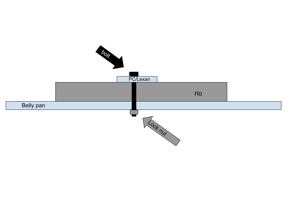

Yeah we mount it flat on our belly pan and then secure by using a piece of lexan or polycarb on top then squeezing down to the belly pan with bolts nut on the other side it holds it down really well that way. Then we cover the channels with electrical tape to keep out metal shavings (works moderatly well). We are going to try and print some modular tpu channel plugs and that might work better / be nicer.

We use 3d printed corner blocks (bolted to the bellypan) with separate 3D printed caps that bolt into those and retain the Rio plus the Swyft board we use on it. There’s a picture in this post - one of the blocks is visible at lower right. This provides a very solid physical mount, clamps the Swyft so it can’t work loose, and it’s still easy to swap the Rio if needed by taking off the caps on the corner blocks.
