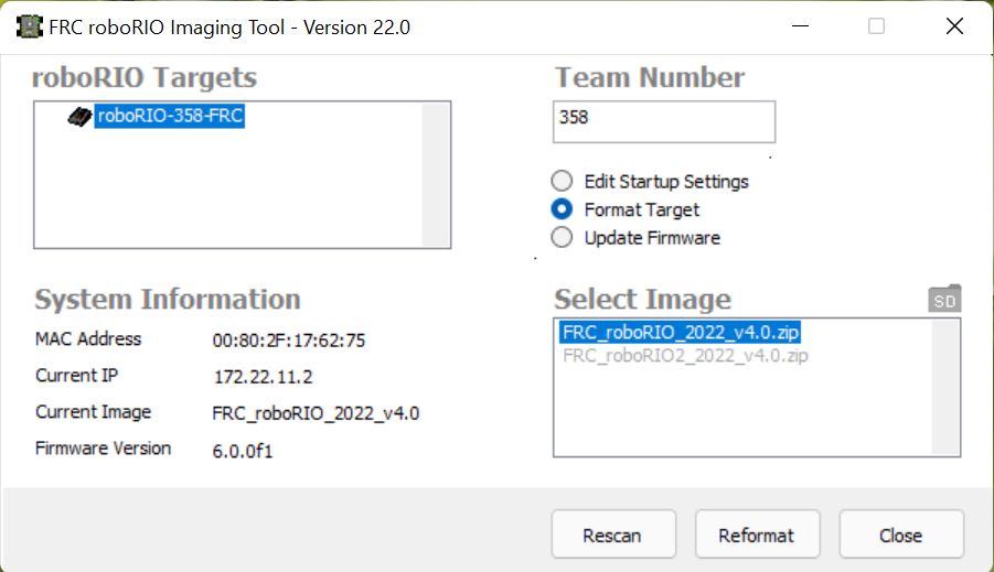

Which version of the firmware are you running?
Verified just now, roborio version 4. (Not roborio 2).
This one.
Hopefully that’s v4.0 of the image not the firmware.
In this picture the Image is v4.0
The firmware is version 6.0.0f1
We want to look at the listings on the left side.

Sure enough! Firmware version 8 on a roborio 1.
installing the correct firmware and reimaging it now.
It’s such a simple thing sometimes… :slight_smile:
