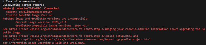

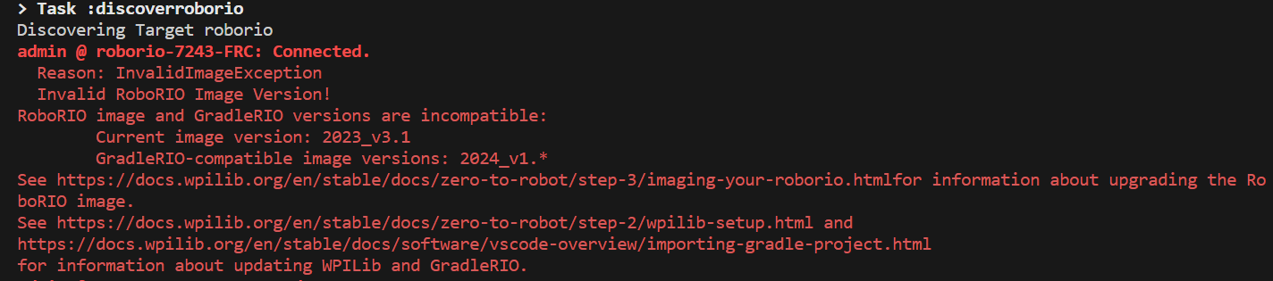

I recently updated to WPILIB v “2024.1.1-beta-3” so that I could be on the current VScode release, and install other VScode extensions. I figured out vendor libraries, only to get slapped in the face with this, as I tried to deploy robot code:

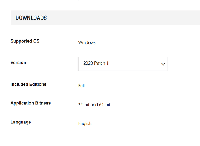

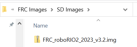

I looked through all the docs, and since I’m working with a RIO 2.0, I started looking for a 2024 RIO Image. However, the imaging tool only had this:

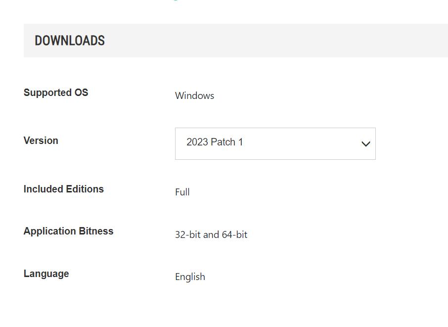

I went to try to update my FRC game tools, and it appears that I’m still on the latest release.

See GitHub - wpilibsuite/2024Beta: Repository for Beta Testing of 2024 Software
I found the 2024 game tools. Thanks!
