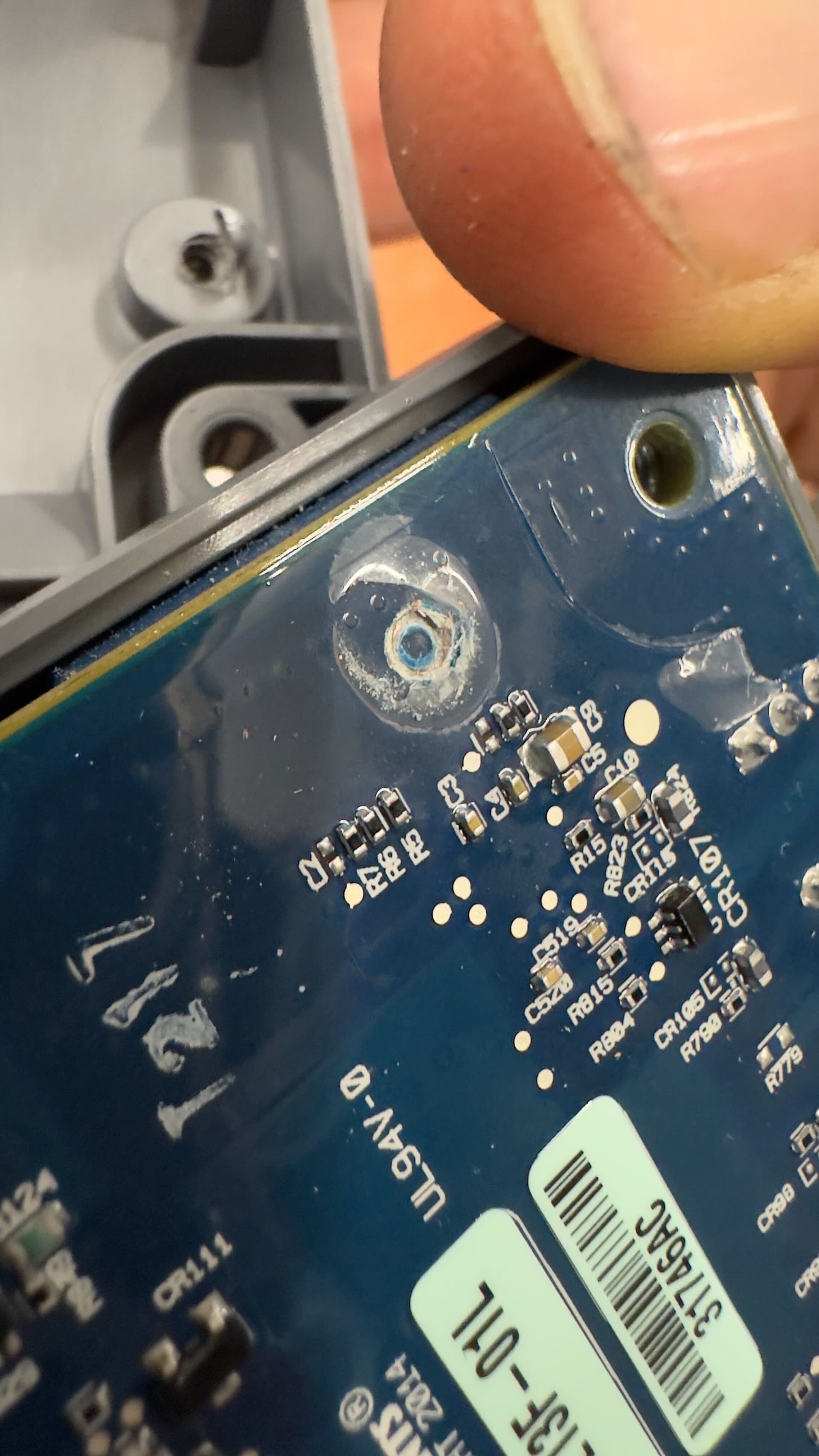

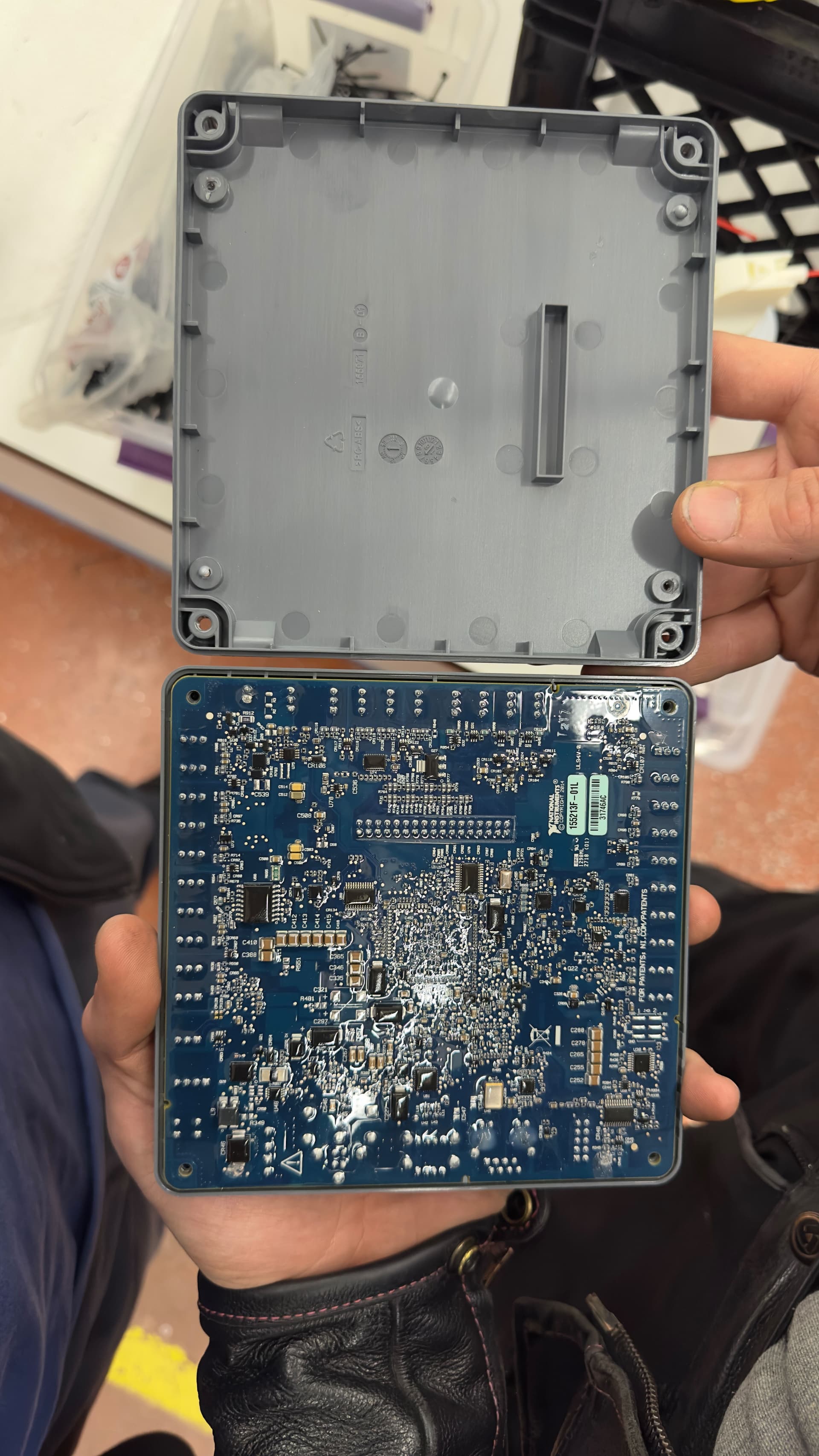

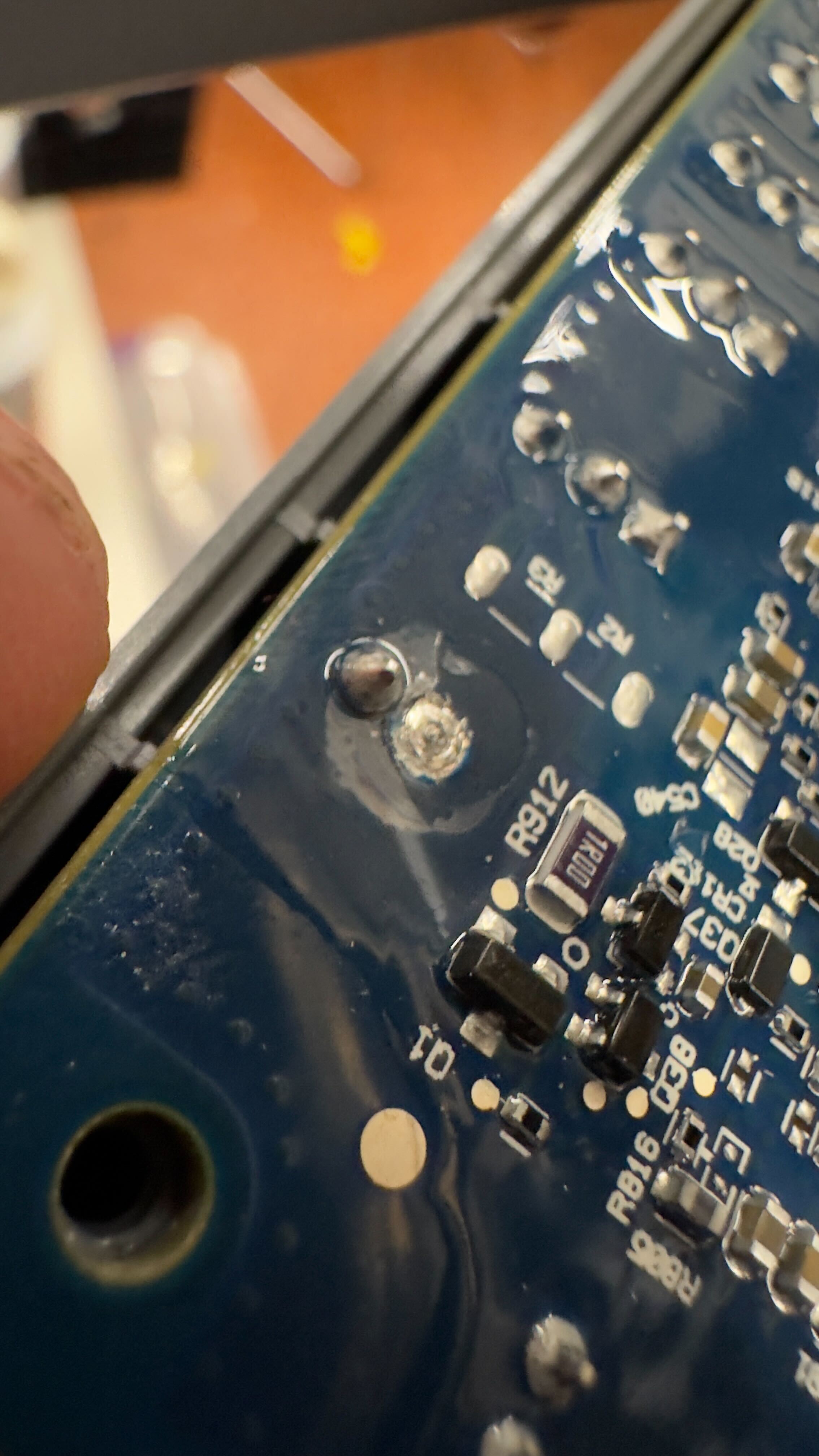

Roborio damage (too-long screws into PCBA...) should I still use it?

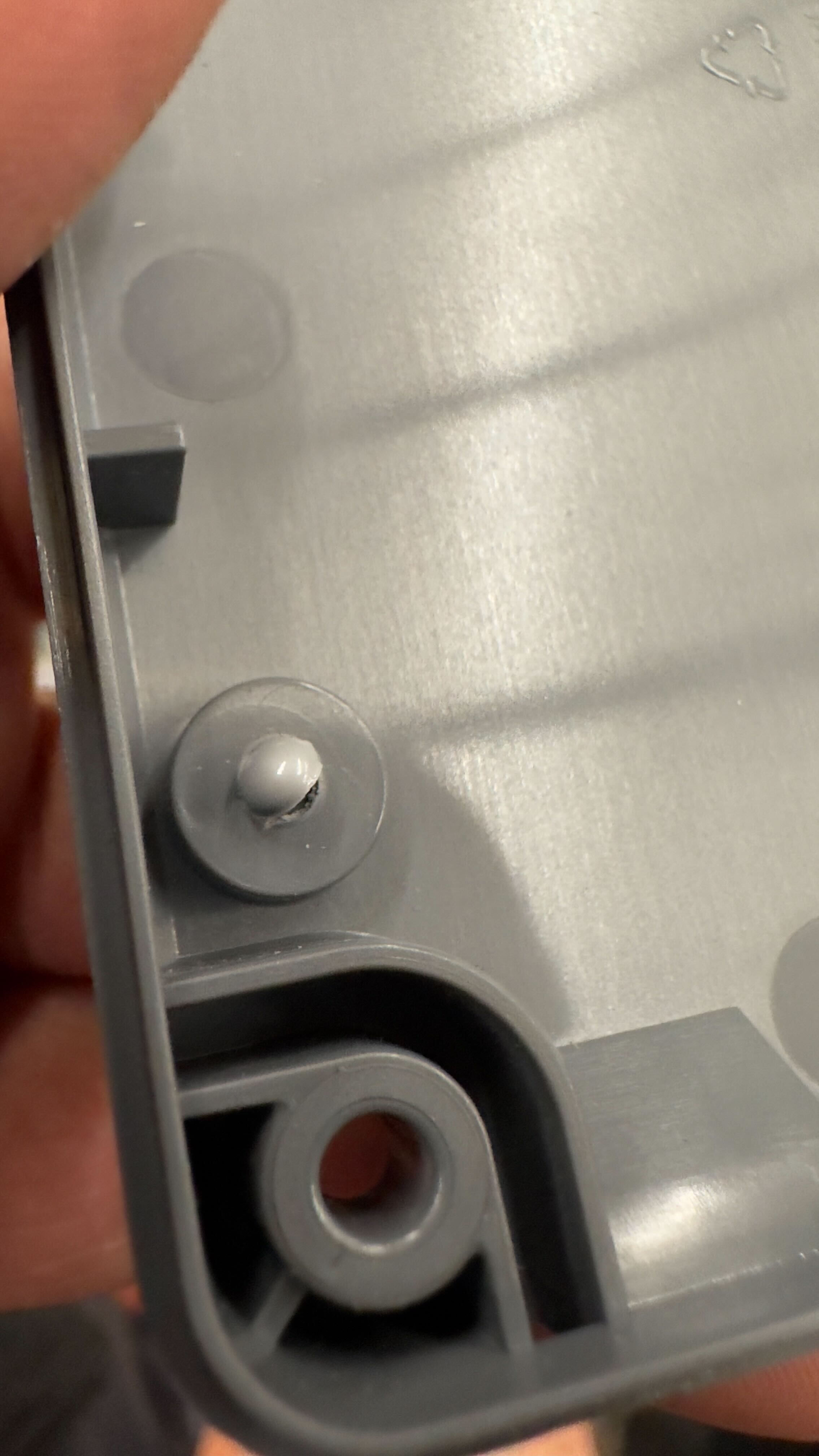

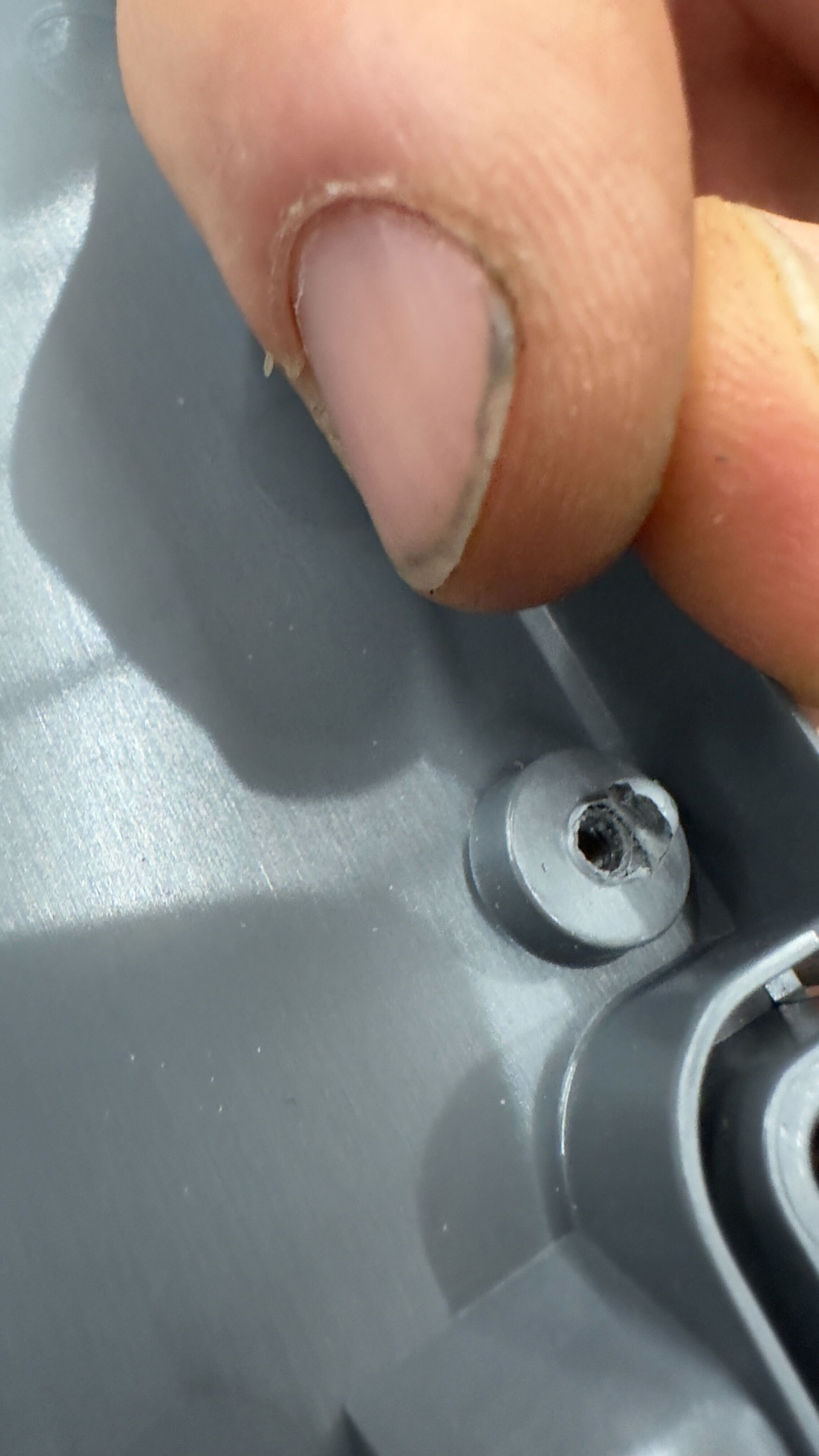

Looks like we had eager students that kept turning 4-40 mounting bolts until they wouldn’t go no more…
We blew 3x 10A fuses before figuring it out.
Seems to run fine now that the bolts are removed?
Our MechEs want to throw a little glue over the damaged potting and put it back on a robot, since we have 0 spare and replacements might be available by the end of November. I’m hesitating to use it without a more in depth evaluation and repair, but maybe that’s too cautious for FRC, especially if it’s on a satellite/non-comp chassis.
