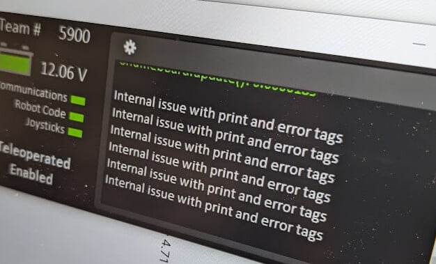

Has anyone experienced getting this error message? Our RoboRIO is intermittently disabling with this error message.
You likely need to update to the latest version of the game tools, including the necessary changes to the driver station to resolve an overly aggressive safety timeout setting.
Thanks Marshall!
I’m not sure the DS update changed from overly aggressive to merely aggressive because I still get a lot of errors. With the update the error message is more descriptive about timeouts/unresponsiveness.
Open the DS View Timing (Evaluation) and I see my busy laptop is slowing down the DS and tripping the safeties. I accept that and they won’t happen in a competition.
Thanks Marshall! The patch 1 update for Game Tools seems to have fixed the issue.
