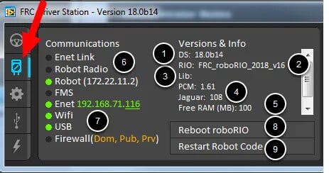

Given that things seem OK when connected to the RIO over USB, the RIO is probably fine. In particular, if the Driver Station has your team number configured, this suggests the RIO also has the correct team number. You can verify this by looking in the panel of the Driver Station which shows some of the networking detail:
This link has some really good information on networking. When you switch from USB to Ethernet, the radio becomes a really critical piece of the puzzle. You can start by just using an Ethernet cable to directly connect the laptop to the radio and looking in the same Driver Station panel to ensure you see the radio.

Looking at the picture, I can say that the firewall light is turned on in my driver station even after turning all firewall and antivirus software off. Any advice?

It would help if posted a picture of the diagnostic panel from your driver station, if you can do this.
I think your RIO is likely to be OK, but do be sure you have compatible versions of all of the software – this should be true if you took everything from the same year (2022?) and followed the upgrade instructions. If you can, also post a picture of the driver station panel that shows version info for everything, when you are connected to the RIO (via USB, if this is the only way that is working).
